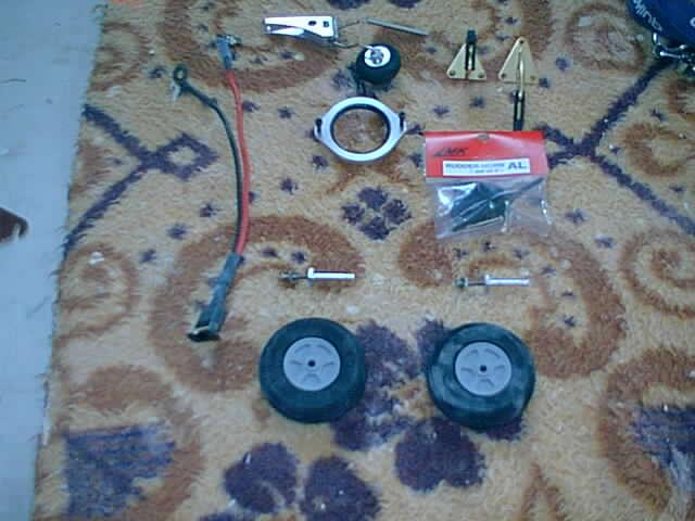

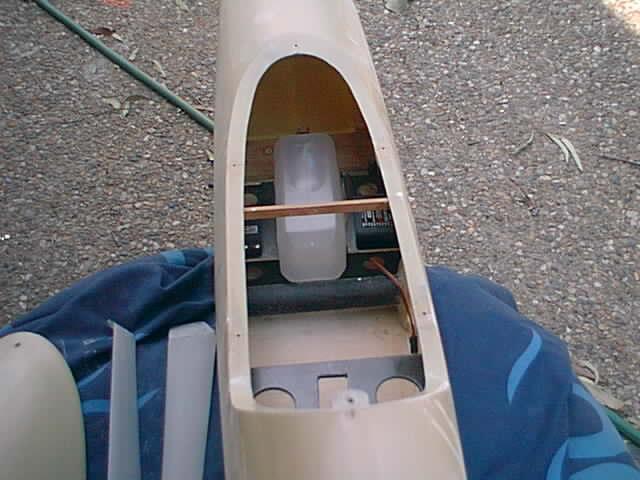

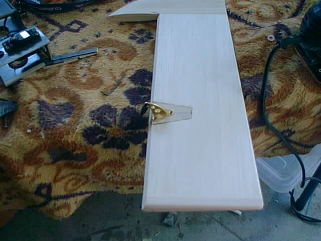

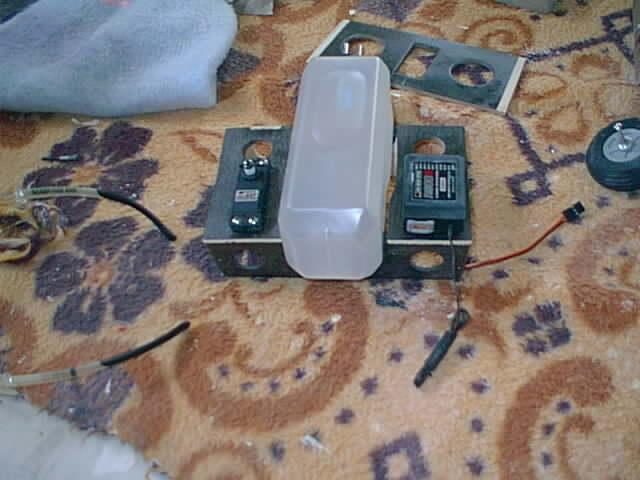

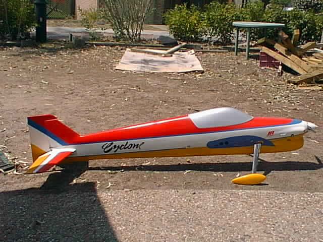

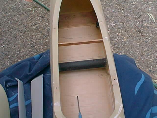

Hey guys,
Heres my build thread of the cyclone which is exclusive to Austrlia. The Cyclone is designed and mostly built be master builder John Payne. The Cylone is built straight as a die and flies like nothing i've ever flown! Snaps stop on a dime and the rudder power is insane!
I will be running all JR equipment:
elevator: DS8455 super speed servo
Rudder: DS8411 high torque servo
Ailerons: 2x 9411 midi size servo
Reciever: R900S PCM reciever
Battery: 1100mah Nicd, may go lithium
Motor: OS 140RX with Hatori high rise header and tuned pipe.
Here are some picture of it so far and one of the backup model i'm flying at the moment also powered by OS 140RX and the exact same setup. I only started taking photos halfway through so all the seems have been sanded and filled which was alot of work!!![:'(][:'(]. i will post some picture of the wings and the colour scheme i have planned for it later. I have also included a picture of all the central hobbies goodies!

BTW, plane is coming along. finished installing spruce on the rudder tray to make it stronger. Got the rails in for the elevators L bracket, got all the trays glued in. should be painting this weekend or next. probably next weekend though. Covering is on its way from Sydney.

Hey Peter, Yeah i'm a bit worried i built the rudder tray a bit heavy but i suppose as long as it comes in under 5kg i'll be happy with it My OS has plenty of power to pull it around. And it'll be better in the wind.

Chris
Remember to keep it light the Cyclone flies best if kept under 4.8kg your rx140 will strugle if it gets heavy especially
in the wind go easy on the paint on the fuse a light model always flies better even in the wind
so remember KEEP IT LIGHT
John

Will do John. Every thing i've made has lightening holes in it.

Its a vacuum moulded fuse which is made up of ( John correct me if i'm wrong) 3/4 oz cloth, 1/16th balsa, 2oz cloth sandwich. the wings are balsa sheeted foam core, bassicaly your typical pattern wing. this model is amazingly strong from what i've seen (Half throttle snap in a verticle downline![X(]). I'll try and get some more pictures of the progress, but certain things like school and composite arf extra's tend to get in the way of much progress[8D].
