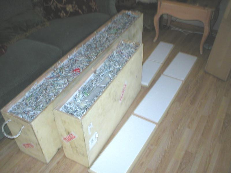

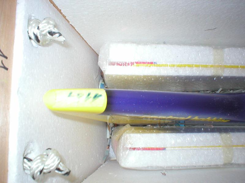

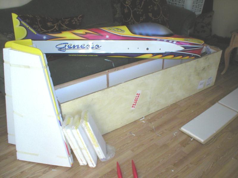

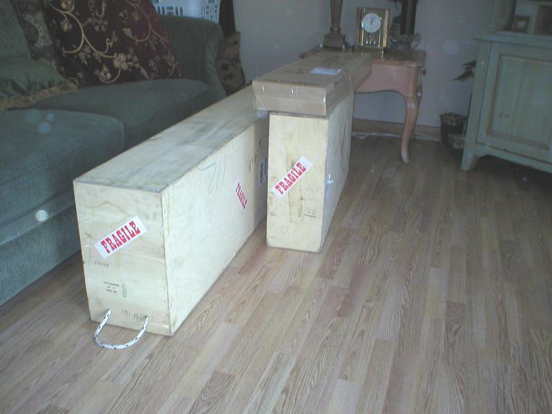

Its here.... To my PLEASANT surprise I woke up to BIG boxes in my living room today!! It showed up a day earlier than expected...
I can now say for the record that the only hardware included in the box is the aluminum wing and stab tubes, landing gear and wing adjusters. Nothing else..
There is only 1 set of wing adjusters though, Im not sure what thats about since there are exactly no instructions included.
Also there was a piece of tape stuck to the top of the rudder, but it came right off with no paint damage..
This thing is really beautiful...

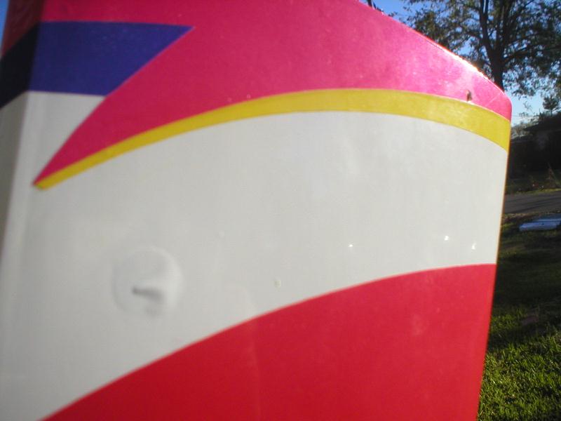

1st flaw.... Wheel pant has a bad run in it... Everything else so far looks to be almost perfect. There is 1 loose piece on covering on the training edge of the rudder,,,, no problemo...

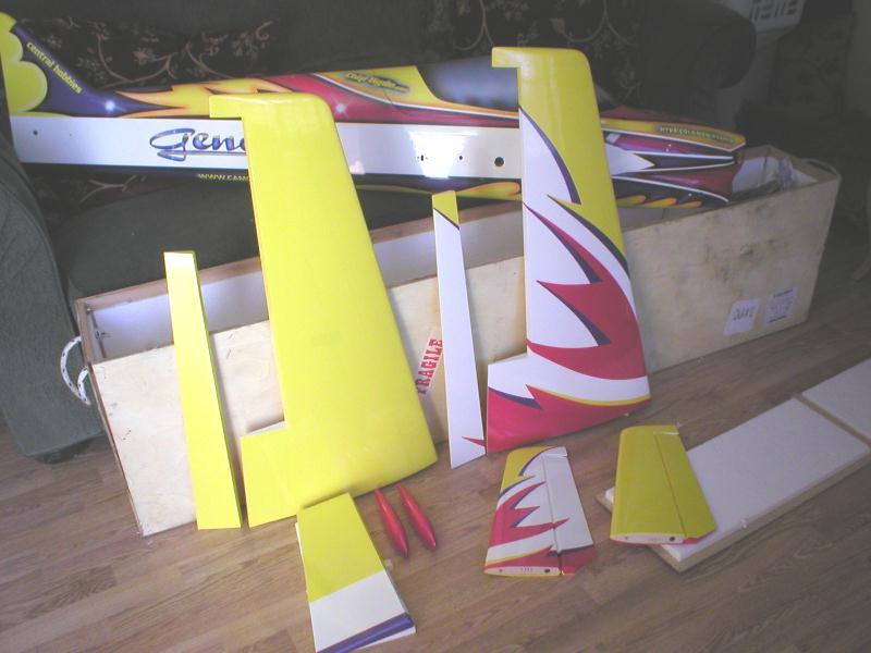

OK.

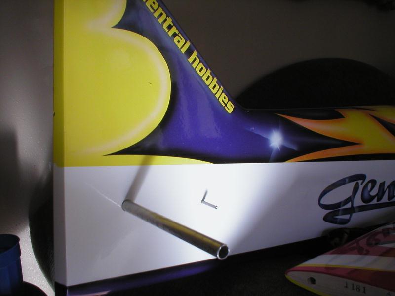

I answered a few of my own questions while looking things over. You only need the 1 set of wing adjusters, thats what they send you,, imagine that[8D]. There is a slot in front of the wing tube on the the fuselage and you use a 1/4-20 nylon retaining bolt (provided) to hold the wing on, it just rides in the slot according to where you set the incidence .
The plane uses 2 aluminum stab tubes. The main tube and a 3/16 tube that retains and allows you to set the incidence of the stab with a nifty little setscrew device that is mouted inside. I tried to get a pic, you can just see it on the end view pic of the stab.
There is a dowel on top of each stab that allows you to drill through the stab and into the main stab tube to keep the stab on. You can see the ring under the covering on the stab where this hardpoint is located on top. I was told that some guys are using the incidence setscrews to hold the stab on but you can go ahead and drill and then counter drill the hardpoint so that a 2-56 setcrew is countersunk into the surface and through the tube on each stab. Then you just cover it with a piece of trim tape or whatever.
Control Horns, the plane is made for the Chip Hyde control horns, it looks to me at this point like the entire inside corner nearest the hinge point is a piece of triangular plywood on the elevators. It is my understand that you can screw right into this piece of plywood. These plywood mounting points are supposed to be there under the covering on the rudder, ailerons and elevators specifically made for the CH horns. I will post pics when I get to that point.
I can also see that there are blank marks located on the fuse where the pull pull exits the fuse so that should be pretty easy once i get to it. I dont see anything for the elevator pushrod exits, but Todd has those measurement and I will get them from him when the time comes.
Here are a couple of pics of the stab tubes and the stab adjuster, the top of the stab where the hardpoint is for the retaining screw and if you look hard you can see the tiny hole in the top of the stab where you can access the top incidence adjustment setscrew..
On the end view of the stab you have to look really hard but you can see the little stab adjuster in there there. Like I said, there are setscrews that you can adjust from outside on the top and the bottom of the stab to set the incidence.

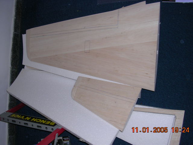

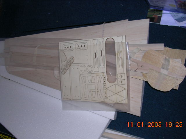

Fist of all, sorry for hijacking your thread. Here is my Genesis build so far. I started from the basic kit mostly because I didn't have a very good experience with my last "pro"-built bird (although I think the problem was the "pro" and not the bird...) Mi wife advised me to get the ARF version next time after a full afternoon spent sanding the flying surfaces' leading edges and tip blocks. I guess it is kind of late now...

By the way... I looked all the parts over really closely and I cannot see anything that isnt arrow straight. I looked for a twist in the fuse, warped wings, a bad glue joint. I couldnt find anything. We will see as I progress. My engine wont be here for a few more weeks so I am only going to be able to go up to a certain point then I will have to wait. I think going on Todds advice from his experience I can do most everything except the engine mount.

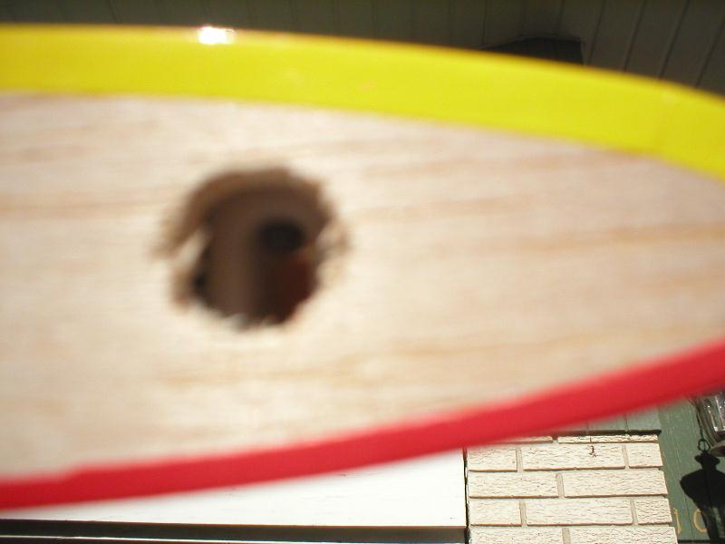

Mine did not come with servo cutouts in the stabs. However, I already knew that I was going to go with 1-9151 driving the elevators so it didnt bother me. Plus I had checked out Todd and Bryan Heberts setups and I knew both had used and liked the servo(s) under the canopy. I thinkTodds electric has the 2 9650's mounted under the rudder servo driving the elevators individually. I checked and the weight/torque tradeoff of the 9650's in the tail (or wherever) vs. 1 9151 servo under the canopy and it was an exact tradeoff on paper.
There are servo cutouts in the wing.
