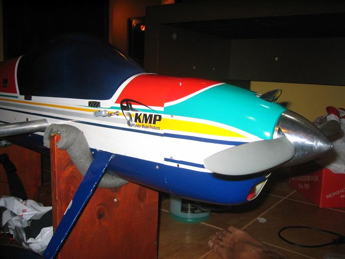

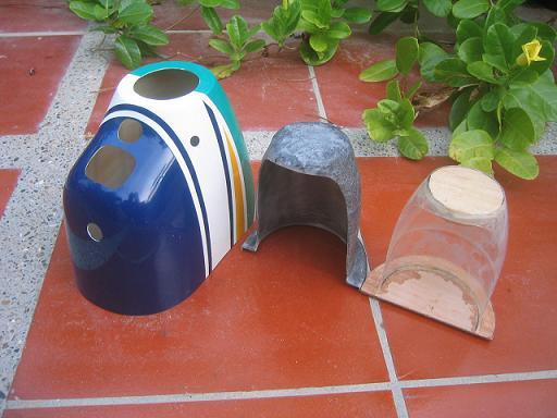

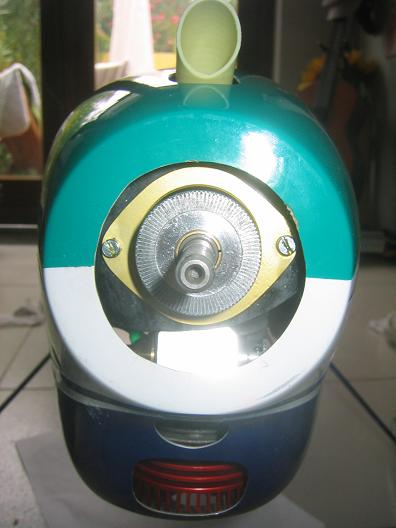

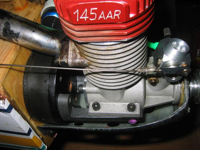

Hi everybody,
I would like to show the way I mounted a nose ring on my Arresti 3. I have been using this for over a year now and it has worked perfectly.
The 'cone' is made up from 3 layers of glass and one layer of carbon which were laminated over a soda bottle. The air intake is directed directly at the main bearing of the engine. Hope this can bring you some idea's
Regards,
Jock

Great Idea. What was the weight of the glass cloth and can carbon fiber?

Default RE: Another way of mounting a nose ring
ORIGINAL: eyeflyok
4.0 ounce E-glass - 4 layers (possibly you can go to 3 layers here but I haven't tried that)
3.5 ounce Carbon - 1 layer
both bi-directional.
laminated with epoxi filled with micro balloons.
Regards,
Jock
