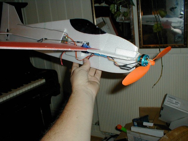

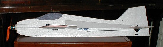

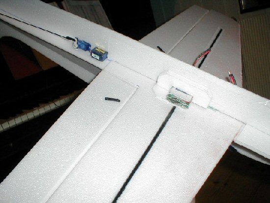

i did like this
made the form and size off ailron and elevator the "rigth" size..use a smal brushless and 2cells lipo on 650 Mah
wingspan 72 cm 6mm depron ,22 cm wide in root oand 12 in tip ailron 3mm, fuse 80 cm long 3mm depron,12 cm from engine to wing ,stabspan 32 cm , 12 cm and 9 cm wide elevator ca 4 cm all way 3mm depron . raise wing 2mm in front ....
wing has a 4mm carbon tube glue inn sanded leading edge , all weighs just under 200gr .
this model let you fly P07 and can be howred but has to smal moving parts to be easy, but that was not the goal ..all has been trimmed as an ordinary F3a model ..dont have any drawing but shold be easy to construct directly on the depron plate!!

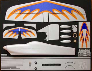

This one has been kicked around. There are a couple of threads going on it on the forums. They are $50.
http://www.3dhobbyshop.com/detail.aspx?ID=451
Mike
