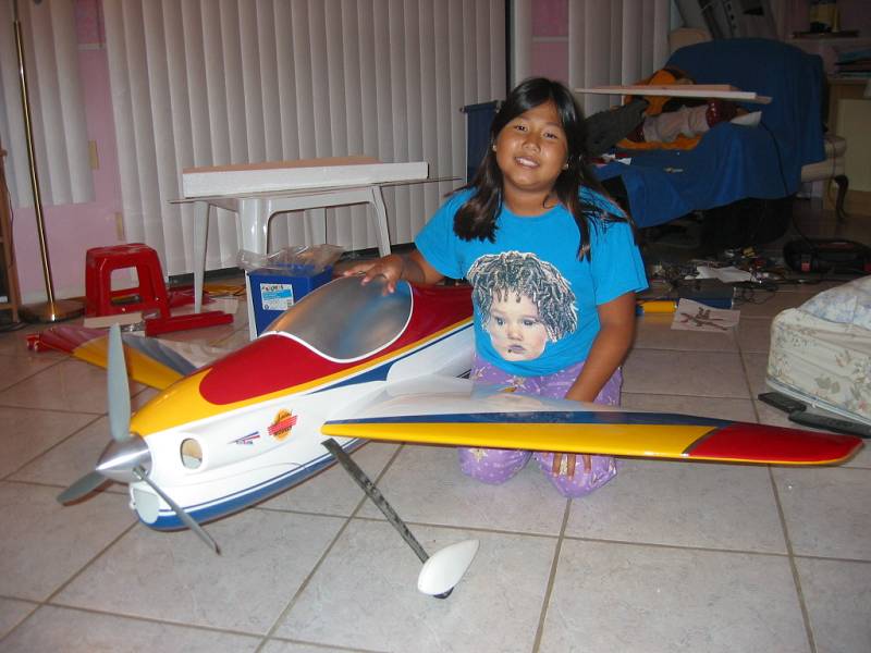

After a year of designing, testing, mid-airs, rebuilding and testing some more, I'm happy to announce that the Black Magic plans, templates and parts are here!
I've been asked by quite a few people to make this plane available, and after much head scratching I've finally reached a point where I can make it happen. I have quite a few pictures of the building process, so I'll be sharing those as we go. if you have any specific questions, email me at [email protected] and I'll be glad to help you as much as I possibly can.
The version I'm offering is the V-2, a slightly refined form from the prototype. With the -07 FAI schedules in mind, a few changes were made to the prototype to make this plane capable at all levels of competition. The prototype flies P-07 as well or better than most "top end" planes out there, but it needed slightly more fuse and vertical stab area for the rollers and integrated "S" segments in the new pattern. So this was addressed.
The nice thing about this plane is the simplicity of the construction. It's basically sheeted foam and formed composites attached to a wood box, but when finished you'd never guess it's not a fully composite plane. This offers quite a few advantages, longevity and ease of maintenace and repair being foremost. With the belly pan being all composite and held on by 7 screws, and running from the chin all the way behind the wing, you can have one heck of a bad landing and not really damage the plane. Just replace and paint the belly pan, and voila, back in the air! (I've already done this twice now myself).

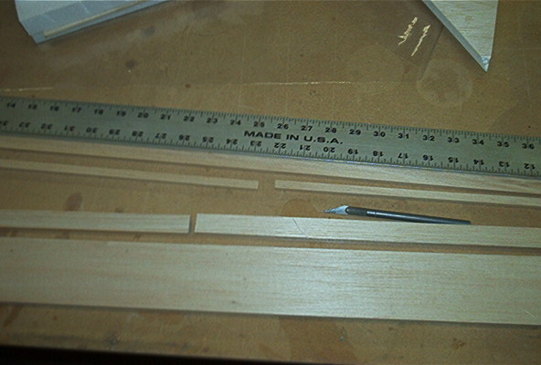

Wood: This is one area you simply cannot compromise. Get the best 4-6lb hand picked balsa and the flattest ply you can find. Trust me, good wood makes building this beast a pleasure. Bad wood will turn it into a flying brick, and make your build that much harder. Don't skimp; get the best. You won't regret spending the money and effort.
Fuse jig: Gotta have one. They aren't expensive, but they are necessary. You can build one yourself if you have the patience, or gator RC sells one like I use. You'd need one set of rails and 2 sets of stations. I have made a couple of modifications to mine and I'll show those when I get to the fuse assembly.

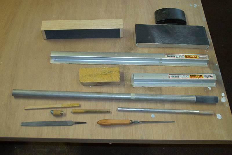

Partial tooling list:
Flat table!!!!! I use various different tables, my favorite is a piece of 3/4" MDS board (flooring) with a frame built to bottom.
Fuse jig- I ue the gator jigs, but you can build your own if you wish. I installed it on a 90" length of MDS board and built a unique but simple attachment on each end. It consists of a "C" section of wood, approximately 14" tall with a piece of tubing, music wire, whatever drilled down through it so the wire stands exactly vertical on each end. This allows me to run a string top and bottom, so I can sight down the string and cut a prefect center plane down the fuse formers.
Sanding blocks- Man, can you get crazy here. A good builder has every kind of sanding tool you can imagine, and some he invents for special applications. I have long sanding blocks of various grit (80 is my favorite for general building), small hard squares of MDS board with stick on sandpaper (about hand sized, various lengths of brass tubing with sandpaper wrapped around the ends, and small sticks to use as files. Use your imagination here, you'll be happy you did.
Hole saws: These are the type with saw teeth encircling a 1/4" drill bit. Use a 7/8" bit for the wing tube holes, and then use a piece of wing tube with some standard 180 grit paper to open up the hole to a perfect fit. Otherwise I have quite a few sizes for lightening holes here and there.
Sharpened brass tubing: It's cheap, so get a lot. This is how I do a lot of perfectly round hole cutting, and I consider this essential.
Dremel: Need I say more?
Scroll saw: If you only have one power cutting tool in your shop, this is it. If you don't have one, put one on your Christmas list!
Drill press, band saw, power drills, hand tools, etc....

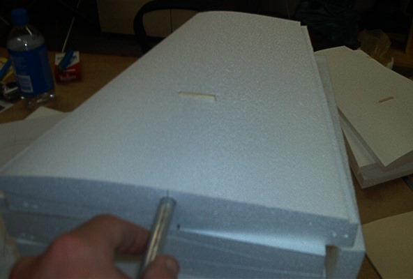

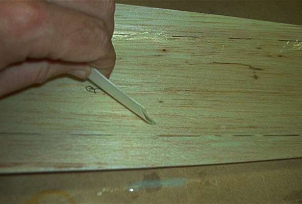

After you have them nicely block sanded, you need to install the small former that holds the end of the stab tube.

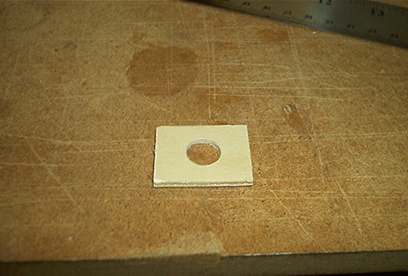

Check the location on the plans, and mark this on the stab core. I make a little template for this out of poster board. It's just a piece of 1/8" lite ply, a square about 1 1/4".
Cut the slot with a sharp blade, then insert the square into the slot.
Stick a stab tube in the hole and press against the square and turn. When you remove the square it should have a faint outline of the circle.
Next I use a drill press and a piece of sharpened 15/32" brass tubing to cut the hole.
Slip the tube socket through teh hole and be sure it fits before glueing it in.
Now glue it in with polyurethane glue and let dry.
After drying, sand the edges of the square flush with the core. Run a piece of inner stab tube in the hole with a bit of sandpaper on it to remove any excess glue.
Now we're ready to make the sheeting.

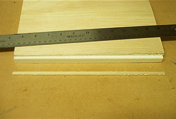

The sheeting for the stabs and fin is nothing special. Use good 4-6 lb balsa, the lightest you can find for this step. 12 grams per sheet is about right.
There's a thousand ways you can do this, but what works best is just tape the pieces together, apply a bead of Elmer's white glue, wipe off and let dry for about 20-30 minutes. Then go over it and lightly sand with 220 grit. Don't try to get it flat now, the tape will make it uneven.
After about another hour, flip it over, remove the tape and sand lightly again. This fills the seam.
Allow to dry at least 8 more hours (or overnight) and then block sand flat on a smooth, flat surfae.
Using the core shucks as a guide, make the angle cuts that are necessary according to the drawings. Leave about 3/8" overhang on teh leading edge, the trailing edge should be flush. Leave a little bit over the root and tip as well.
Now use generic hair spray and spray down the skins to seal them. if you omit this step, the wood will soak up much more resin (and weight) than is necessary.
After letting this dry completely (like overnight) sand it lightly with at least 400 grit. I like 600 for this step, but 400 works.
For the fin, you need to glue many pieces edge to edge, and make a long angular cut following the angle of the fin leading edge.
Once again, trim using the core shuck until the trailing edge is flush, and the leading edge overlaps by about 3/8". Spray/seal and do the same as with the stab skins.
To bond the skins, use a good quality laminating resin. West system is pretty good and easy, although I prefer MGS. Any of the better laminating resins will work fine.
Lay down the skins and spread the mixed resin with a folded piece of poster board as a squeegee. It should be thin, and barely look wet. It shouldn't take very much resin at all, less than an ounce for both stabs. Much less if you can manage it. Just as long as the coverage is there, and you have no totally dry spots, you're ready to bond.
Place the bottom skin on the shuck with the TE flush. Lay the core on top of it, aligning the core to the shuck. Watch your corners here for visual cues.
Now add the top skin, press down, and add the top shuck. I have made some pieces of MGS board slightly larger than the sheeted surfaces, and I lay that on top and pile on the weight. It takes about 50-70 lbs for each surface to get a really good bond without a vacuum.
Now let them cure overnight.

After the tail pieces cure, trim the edges of the sheeting to within 1/16". Sand them flush with the core with a long sanding block. Take extra care not to sand into the core itself, if you do you'll alter the shape prematurely.
Now mark 1/4" in from the trailing edges and cut away with a sharp x-acto knife (or band saw if you prefer). Trim outside of teh marked line, and sand to it.
Here is where I differ from a few people. In general, the stock you'd buy for leading edges and such are made from the heaviest wood they have. The stuff is like iron. Instead, I take a piece of 4-6 lb stock and make these pieces from them. You can save a few ounces on your plane if you do this. If you're a "tail stander" don't do this for the LEs of the stab. They will crush. But for TE, and wing and fin LEs it can save a lot of weight.
For the fin, glue a piece of 1/4" balsa to the TE, and a piece of 1/2" balsa to the LE. Use polyurethane glue spread really thin. Wipe up excess with a paper towel. Hold in place with masking tape.
For the stab, use 1/4" on the TEs and 3/8" on the LEs.
After they are dry, mark a center line down the LEs and sand a contour to this line. Sand the TEs flush and leave them. They should be at LEAST 1/8" thick, possibly more.
The tip for the fin/rudder is a piece of 4-6 lb 1" sheet. Glue this in place and then sand to a rough contour when finished.
The stab is the same, but make the block tapered: 3/8" at the LE, 1" at the TE. Again sand to rough shape.
