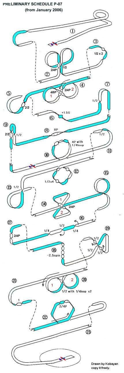

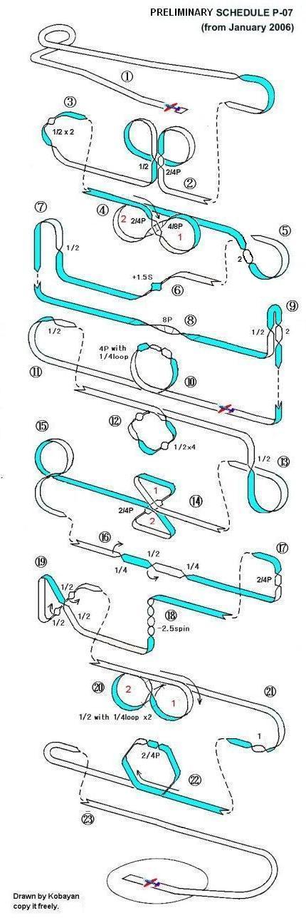

Thise drawings are great, I was jst beginning to ask my self how you can take off upwind and then fly stright and level upwind with out a turnaround, In the drawings a procedure turn is shown but not spelled out in the text.
