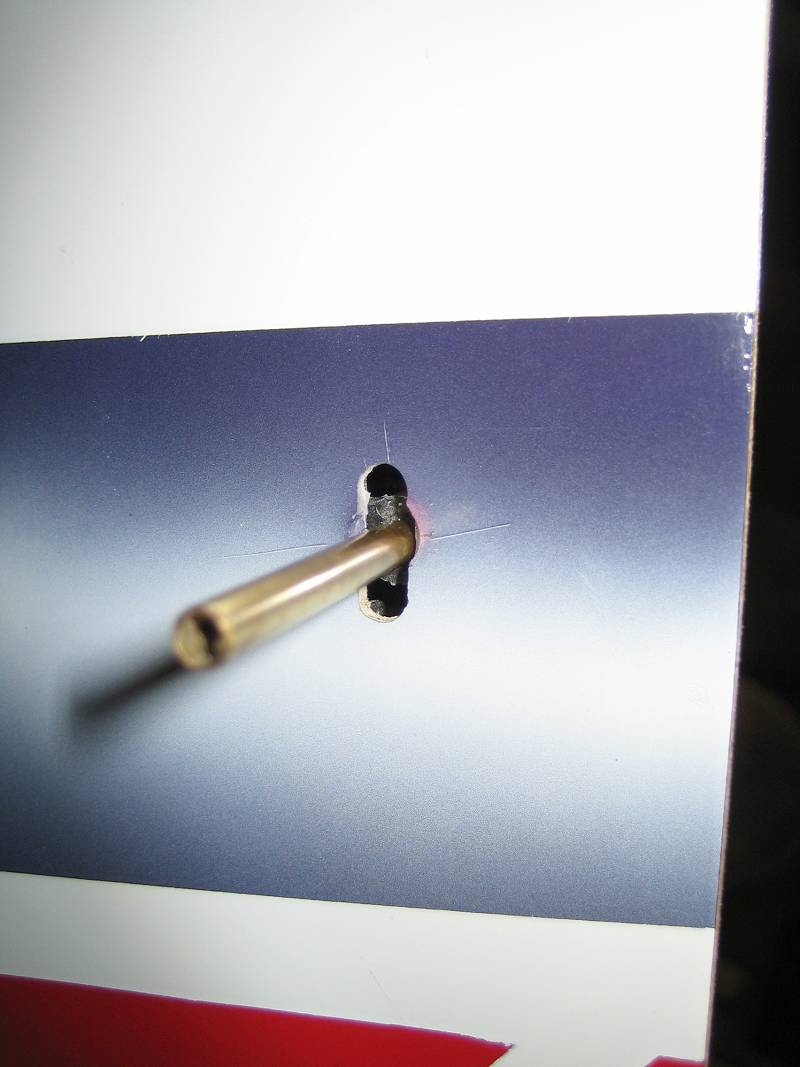

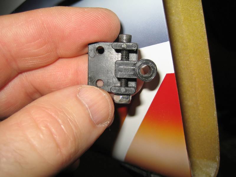

PS If anyone has fitted incidence adjusters to their tails please can you post some pics of where/how you fitted them?

Here is the tail adjuster setup in my first model. The adjusters are the old style Gator wing incidence adjusters. The green tubes are drinking straws over the heads of the cap screws just to guide a ball ended hex key into the socket. On my new model I only fitted one adjuster as I realised that the engagement of the brass tube into the phenolic sockets in the tail would stop one half moving relative to the other.

looking at your adjustable stab pics, does the metal bar simply fit through holes in the fuse walls or is there a tube sleeve inside the fuse as well as per the stab spar tube setup??

The aluminium rod as supplied with the Gator adjustable stab kit was used and fixed to the fuse. I made some plywood donuts which slid over this rod. I simply got everything aligned and then glued the plywood donuts in with micro balloons and epoxy to the inside walls of the fuse. Rough up the surface of the rod which is inside the fuse so that it cant move once glued.
What I like about this setup is you can tighten up each stab half to these pins so it acts as another anchor point. This stops any play in the stab what so ever. The method they provide simply has too much play in it for more likings which I feel could be a contributing factor to some of these failures we have all read about.
