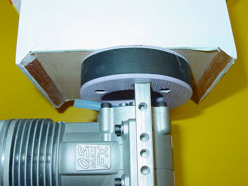

Old 04-09-2006 | 09:43 PM
Eric.Henderson's Avatar
Joined: Sep 2003
Posts: 1,413
From: HENDERSON, NV
Default RE: Engine mount for OS 160
I was running my Hyde C mount today with an OS 1.60. It keeps the nose of the spinner pointing the right way and does it's iso-mount job well with a 2-c engine.
Regards,
Eric.
