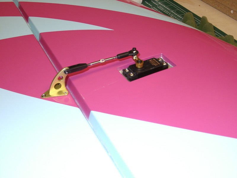

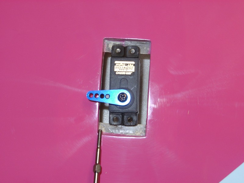

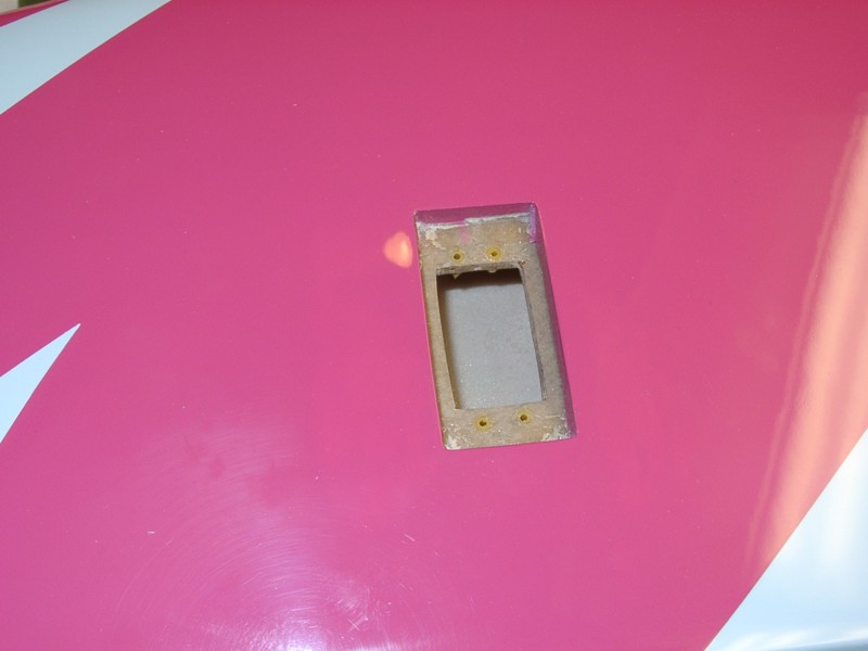

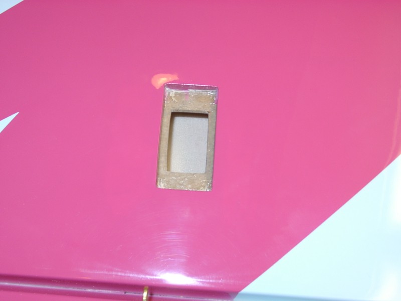

Let's get back to the build. This week I received most of the stuff I will need to finish the plane. I am still waiting for a piece of carbon sheet for the motor mount and a piece of carbon nomex for the servo tray. I have been pretty busy at work but I finally had a chance to do a little work last night and today.
I decided to tackle the aileron servo mountings. This is one spot that I will admit to being a bit disappointed with the plane. The aileron servo opening is rather large at just under 2.5 by 1.25 inches. I choose to use JR 9411SA servos which are quite a bit smaller than the opening. The lips on the servo bay are not very stiff nor long enough to mount this servo. Adding ply servo rails above the fiberglass lips and glued to the sides of the bay would have worked but the servo would have ended up too far out of the wing for my taste. I decide to make a small tray from .125 fiberglass covered end grain balsa. I really like this stuff for its low weight and strength. Luckily I had a few pieces left over from the center of a few formers that I made to build a plane back in 1991
I made a paper template as shown and then cut the fiberglass balsa composite to match. I added a light balsa rail to the edges that will glue to the turned in sides of the servo bay. The completed tray weighed 4.6 gms before gluing in place. I think Oxai could have put in a piece of nomex sheet in this spot that could be cut out for your servo choice. The only thing else needed would be something to screw into. This would be minimum work on there part as they make the composite wing. It took me several hours to get it done.
#61

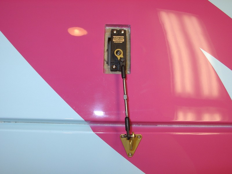

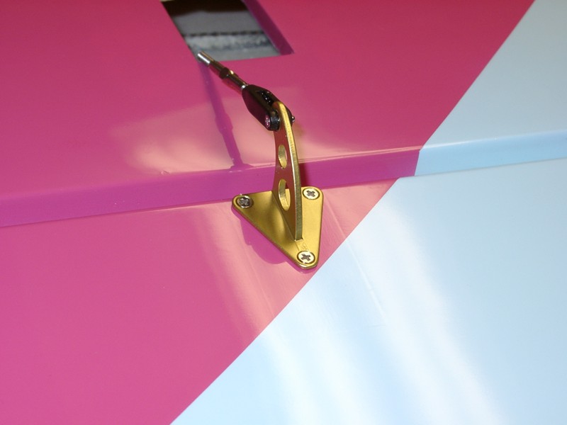

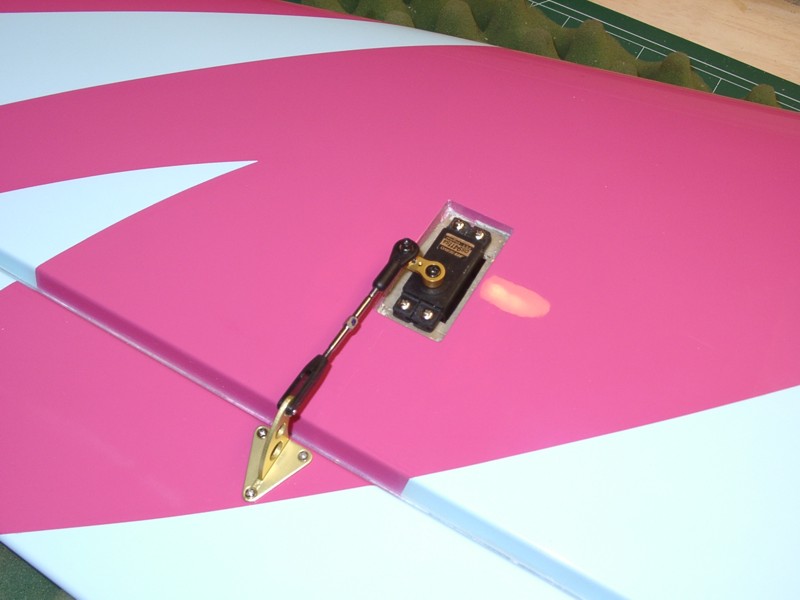

For connections I choose CHP control horns, Hanger 9 ball links and titanium pro links. A thin piece of lite ply is embedded in the aileron and just wide enough to mount the CHP control horns. The outline of the lite ply can be made out in the picture. The ply seems pretty soft when drilling through it but the screws seem to hold well enough.
The servo is mounted into the fiberglass balsa composite tray using small pieces of nyrod to hold the screws. This is an idea just posted by Matt13 in the share your light building secrets thread. It sounded good so I thought I would try it. I first tested it on a scrap piece of fiberglass balsa composite and it seems to hold very well. The screw themeslves held in the balsa fiberglass composite but the nyrod makes it that much stronger. 1/4 inch pieces are used.
Now if I could just match the pink paint for the tray it would look just fine

Nice stuff, just a small lip to hold the tray. I guess they size for the big Futaba Servo. This makes sense, pick the worst case and then other servos can be modified in place.
Cyano in the screw holes to harden them helps, or perhaps your nyrods? The nyrod thing works well long term for me.

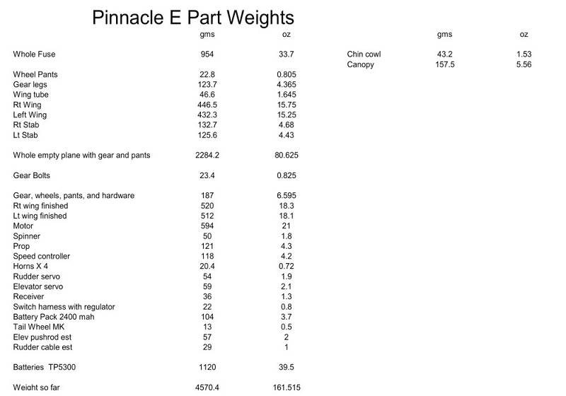

I have weighed up all of the components. (Let me know if I forgot anything.) The weights are listed in the chart below. I estimated for elevator and rudder pushrods and cables.
I still have to add motor mount, battery tray and elevator servo tray, and the glue to install them.
So far I am at 10 pounds 1.5 oz. An ounce and a half can be lost by changing to a 900 mah battery pack instead of the listed 2400 Li ion pack listed. The weights of the fuse and wing panels are now pretty accurate as they have been weiged with a digital scale that seems pretty accurate instead of the spring scale used earlier.
In regards to wing weight as discussed earlier. It could definitely be done lighter with foam/balsa and film covering. For my comparison I weighed one of my Desire panels, a little smaller but with a retract and wheel as well. It only weighed 14.5 oz (411 gms) They were done as light as I could have with honeycombed cores etc.
Stuart
Stuart

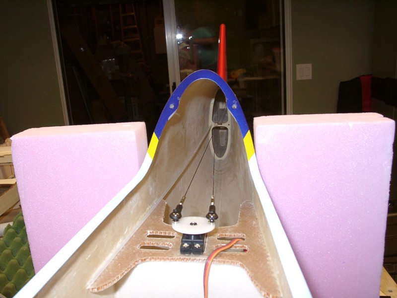

The rudder servo and horn were next. The rudder servo was mounted in the existing tray made from a honeycomb fiberglass composite. Gold Nyrod pieces were used for screw mounting as before. In order to figure out where to drill the rudder horn screw hole, the servo with ball links was put in place to measure down to the center of the links. This measurment was transfered to the outside of the fuse on both sides. A long straight edge was run from this mark, through the precut cable hole and a mark made on the rudder over the ply plate. The mark ended up in the lower third of the ply plate on each side. Once satisfied that the marks are in the right place and set back from the leading edge of the rudder an equal amount (double check by measuring from the trailing edge of the rudder in case the angle sanded into the rudder leading edges are unequal) a hole is drilled part way through from each side for a 30 mm bolt. The rudder horn is made up from 2 med MK horns. The center bolt is a 3x30 mm bolt with the head cut off. The bolt is just long enough but could be longer if you can find a slightly longer 3mm threaded piece.
#70
Funny how this is only my second real ARF
Unfortunately the geometry of the rudder cable exit guides to the rudder horn only really allow for crossed cables. I am not sure if there is really a downside to them but I have always preferrred and used uncrossed cables in the past.
The rudder horns were screwed on with a little silicone rubber on each base to fill in the rear gap under the horn due to the rudder taper, and to help prevent loosening, Loctite was also used on the screw. I used Hanger 9 ball links on the servo wheel and MK links on the rudder end. For cable I have always liked Berkley Steelon fishing leader. It is a plastic coated wire. The wire is soldered into Dubro threaded couplers. The cable is stripped and bent back on itself and held in place with solder. The wire does not accept solder but the solder locks it in place.
Right now I have a 35 mm JR large output wheel. This is not quite enough throw and will need to be changed.
Stuart

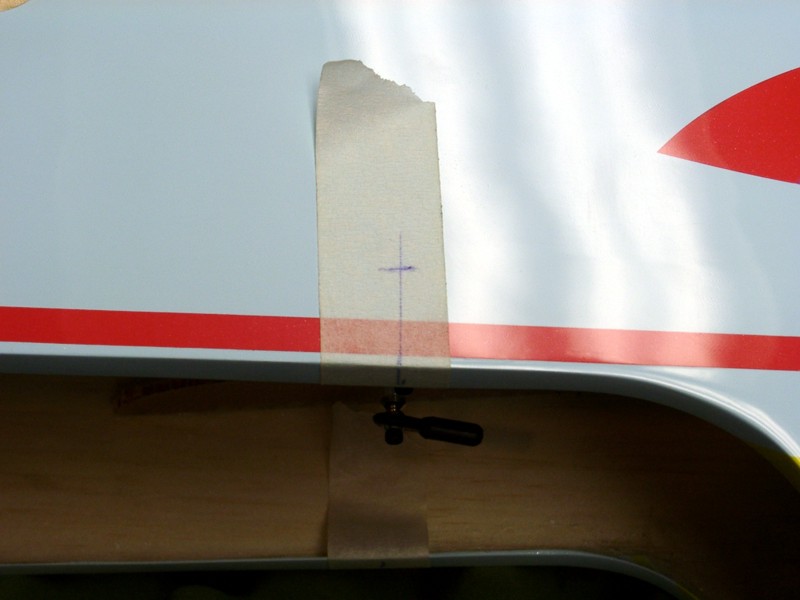

Sorry for the delay in continuing but I have had some time limitations again this week. Not sure how I will get the time to fly it as I can't even find the time to finish it
As far as Elevator control right now I am planning on using a carbon fiber pushrod like the deps system only .125 diam. I will use several guides rather than a full legnth sleeve. I have a bit of a hangup about using the .07 rod although obviously many are using it without issue.
Stuart

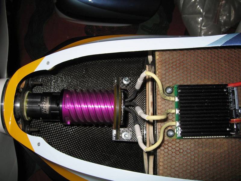

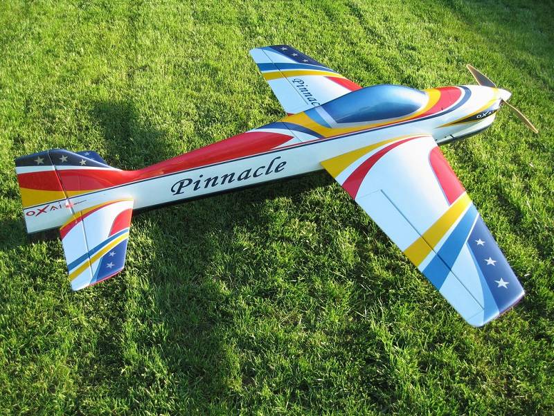

Hi,
My Pinnacle is very close to being ready to fly. I received it about a year ago, so talk about slow building...
Well anyway, it is Hacker (14XL) powered, and I will be using my trusty 5300mAh TP Pro-Lites to feed the Hacker with electrons. The weight is very close to the 5 kg limit, and I'm still missing a few Depron air-guides etc., but hope to keep it under the limit!
The weights are:
Fuselage: 2881 grams
Left wing: 443 grams
Right wing: 448 grams
Wing tube: 94 grams
TP 5300mAh Pro-Lite: 1100 grams
Total: 4966 grams
I started out with a raw kit weight of 2280 grams, so nothing wrong with that, however it all adds up in the end. I have put on an APC 21x13WE, and it is a very heavy prop, so I might save a little by going with the Mejzlik 20x12WE I have, but I'm not sure if it will load the Hacker properly. I guess time will tell...
I have attached a few pics for your information. The rest are available on my web-site: [link=http://morten.laugesen.nu/]http://morten.laugesen.nu/[/link]
The weights are:
Wing tube: 94 grams
Total: 4966 grams

Thanks for the pictures. I actually have checked your site several times looking to see if there was an update to the plane. I also studied your initial pictures carefully when deciding whether to buy this plane or not.
Let us know how it flies
Stuart
Stuart

I finally have hads a few hours here and there to get a few things done.
First I wanted to revisit the aileron linkage. I was not real happy with the connection on the control horn side. The CHP control horns are nice and the clevis fits very well. Probably too well as it doesn't tolorate side to side movement very well. I could feel it binding with extremes of servo throw.
I substituted a Hanger 9 2 mm Ball link screwed into the control horn. It fit well and did the trick. You can see what I mean as far as the angles in the last exagerated servo throw picture. The first picture is the original linkage (on the other wing).
Stuart
Stuart
