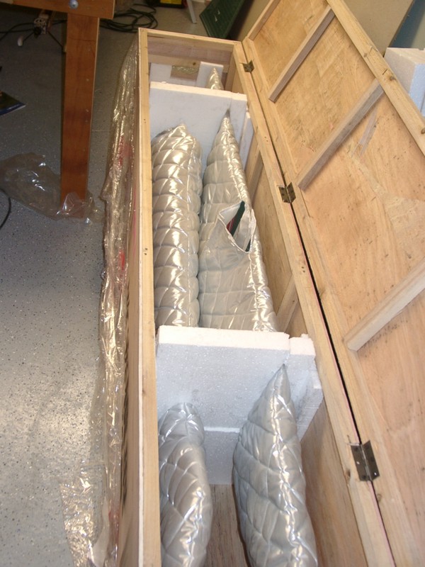

I recently picked up an Oxai Pinnacle, electric version. It really is a nicely constructed and finished plane. I had to pick up the shipping crate at the airport. If anyone thinks that a PT Cruiser is too small for stuff like this take a look at the first two pictures. Of course it was like driving next to a coffin. The box size is 80 x 20 x 16, and just barely allowed me to close tha hatch
Once inside just 5 screws and the crate was open!
The plane is held in place by styrofoam with appropriate cutouts, the upper portions needing to be cut for removal. All of the major componants are in protective bags. Not quite the quality of some of the commercially available bags like Wingtote, but they do the job. On the bottom of the box was a plastic bag taped in place with the fixed gear, wheel pants and a few assorted items. No instructions are included with the plane although Sam from Oxai-US sends some helpful hints seperately.

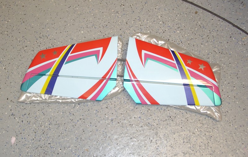

The stabs come with 2 carbon fiber rods already glued into one half.

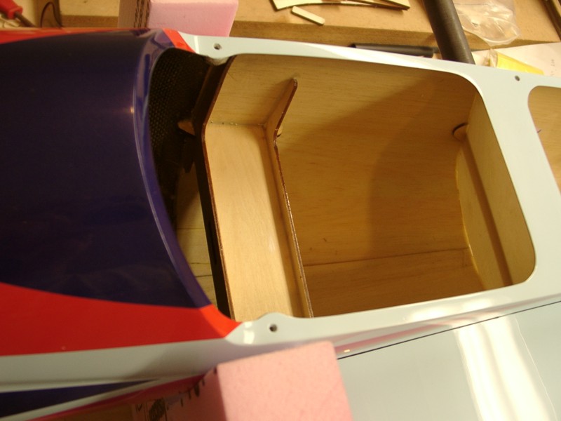

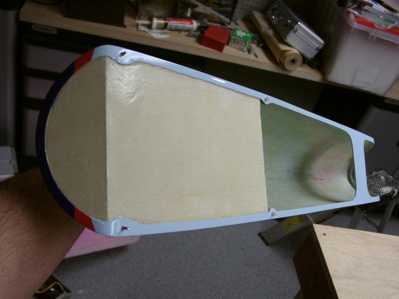

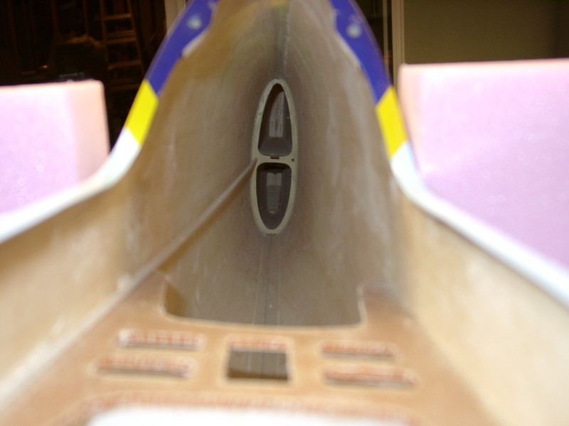

The fuse is of interesting construction. The rear portion is a formed balsa skin with a layer of light fiberglass inside and out. The front portion is a heavy carbon fiber without a balsa filler. The chin cowl is also carbon fiber. The canopy and the fuse are partitioned off so that air entering the front scoop does not pass into the back of the fuse.
The rudder servo tray is installed and made out of a nomex fiberglass composite.
The rudder push-pull exit holes are in place, as is a tube for your receiver antenna.
The wing is held in by a single nylon bolt and wing nut and a single incidence adjuster pin in the rear. I will probably add n alignment pin to the front of the wing.

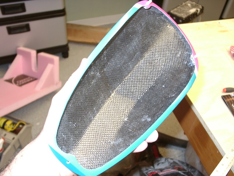

The wing is a composite construction with some balsa and carbon fiber internal construction. The wing is not painted in the mold but finished in a traditional way with paint after construction. The ailerons and elevators are center hinged. All hinging is already done.
The servo cutouts are in but need to be lined if wanted. Something to screw the servos into needs to be added to the molded in flanges.
I tried to photograph the wing internals. Not sure how well it came out. As far as I know the regular Pinnacles have traditional foam core wings. I am not sure if all of the new planes will have composite wings or just the electric versions.

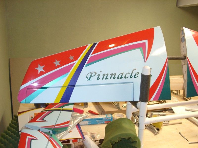

The wing and stab fit to the fuse is excellent. A roll of self stick foam tape is included in the parts bag which I assume is for lining the stab and wing roots

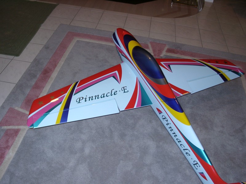

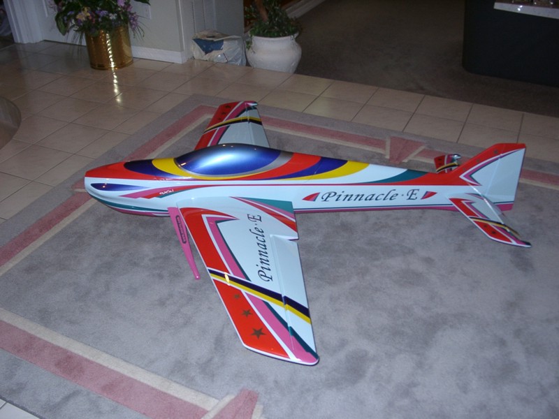

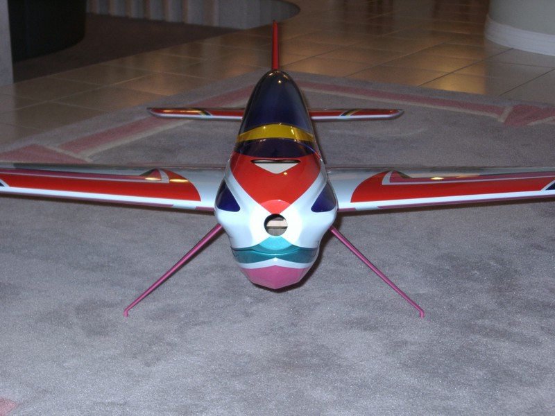

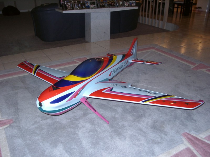

I took a few pictures of the assembled plane after installing the fixed gear.
I do have weights of all of the smaller components and will post the weights of all of the parts once I find my larger scale. It seems to be missing in action
Having a second floor catwalk is helpful for top and bottom pictures.

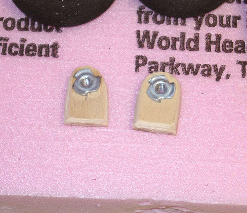

I still have to order many of the accesories needed to finish the build so I started with the fixed gear. The gear cutouts are in place but need to be enlarges slightly for the gear to pass. The fuse files easily. The gear attach to the lower portion of the ply gear plate but access is limited from below.
I made a paper pattern of the gear and taped it ti the top of the plate with hole locations marked. Unfortunately only the holes closer to the middle of the fuse could be drilled with an electric drill. the two holes closer to the fuse wall needed to be drilled with a hand drill setup. The positioning of the gear was checked and made symetrical with a string from the tail to each leg.
Each gear leg was fastened with 3, 4mm bolts from the bottom. In the completed picture you can see that the bottom of the ply plate has a layer of carbon fiber on it.

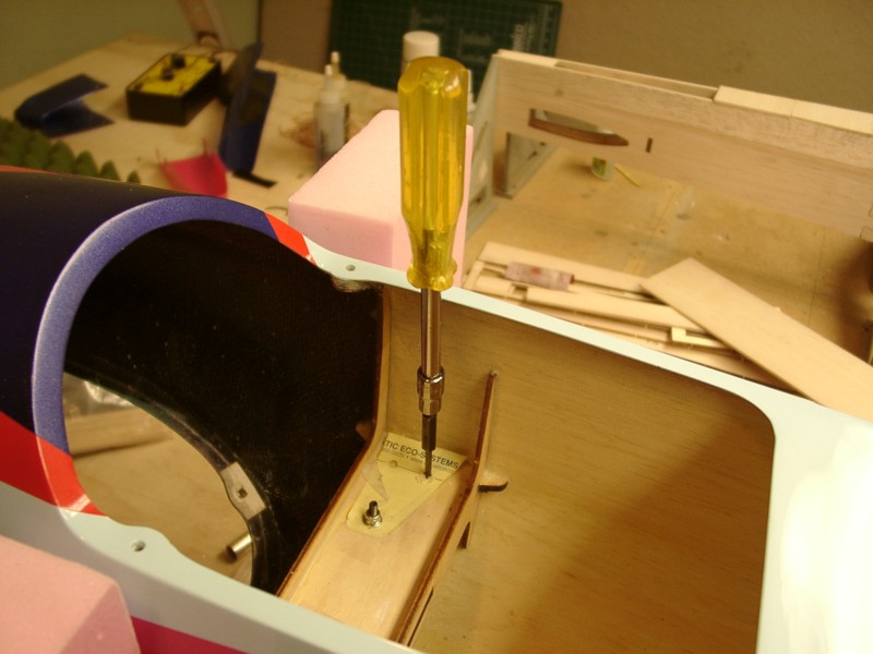

We were looking very hard at a pinnacle but eventually didn't get one because the wings were coming out heavy. Heard there were some lighter wings coming in. How much do your wing panels weigh?
Also: How is the canopy attached? or did they leave that to the customer?

Judging by the pictures, it seems as though there are two screws in the front and I'm guessing a pin or two in the rear. I saw Troy Newmans glow version at a pattern contest a few weeks ago and boy was it gorgeous. He said that there were lighter wings that were coming out, but the airplane has large wings anyway so I don't think that the weight would factor in too badly, unless the electric version has a little less area. The ONLY flaw that I saw was that you could see the seams in the wood on the wings and stabs, like they didn't fill it in sufficiently since the flying surfaces are silkspanned and painted. Other than that, which is comparitively minor, I didn't see any issues at all with the airplane. It was absolutely beautiful and well thought out. Kudos to Oxai for their work, sc204, your airplane is no exception. Good luck with it!
The canopy is attached with 2 screws in the front and the cowling with one at the front. There are two nylon alignment pins for the chin cowl and 4 I believe for the canopy. These have all been installed.

Since the wings are now composite there are no seams to see. You can see the seams for the hardwood insert for the horns. There are also a few irregularities on the bottom of the wings. Really just a couple of small blemishes. Nothing too obvious. As far as I know, through Troy, the wings are the same airfoil and size as the IC powered version.

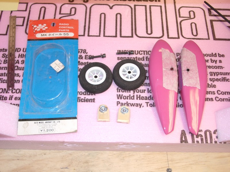

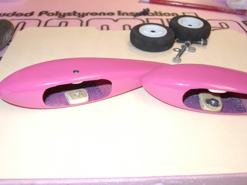

Work has been excessive lately so I haven't been able to get too much done. I finally ordered all of the pieces (I hope) last week to complete the plane. I will hopefully have it all sometime this week. I did get a few props already delivered. Just as I was amazed at the size of the fuse I am amazed by the prop size. I know how long 22 inches is but to see the prop in person when the largest pattern props I am used to using are 14 inch or so on the YS 120 is impressive.
Anyway I have mounted the wheelpants to the gear legs. I used the cheap way out with an 8x32 bolt. The method is the same as documented by Wayne Galligan on rcaerobats.net
http://www.rcaerobats.net/Wayne'sWheelpants.htm
For wheels I used a pair of MK 55mm plastic hub wheels that I had still in the package. They are at least as old as my 13 year old son. They are probably the largest I could use without enlarging the wheel pant openings. I measured and marked the wheelpants on a piece of masking tape and drilled through that for the axel. The 8x32 bolt threads into a blind nut in a piece of 1/4" lite ply on the inside of the wheelpant. An additional piece of plywood drilled for the bolt only supports the inner end of the axel. The ply was simply glued in place with 5 minute epoxy after shaping to fit the inner wheel pant contour.
