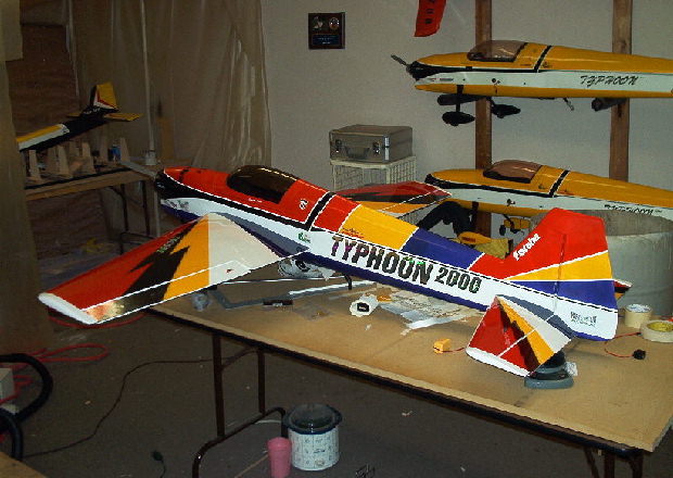

Default ok I'll try this
Don't worry GW, I wouldn't open up that "after" can of worms here =) Hehe.
I like the all built up version, wings stabs and all. It's easy, and it's argueably lighter and stronger if done right. It IS a lot more work, and harder to get straight. But if you can manage, it's worth it.
These are 3 that I built. the 2 yellow ones on the wall are my babies, and the pretty one in the foreground is um...deceased? Yeah that's it. More like cremated *cough*
Anyway, I hope this works...

Yea, you probably want to keep that can closed here, Dont want to be super-slammed here as well do ya? . That other got ugly, but you were right on target!! My hats off to ya for sticking up for whats right.
Man, that was one pretty T2K !!

Actually, the bottom yellow one on the wall isn't mine anymore either. It has a good home though.
That other thing amazed me, but I suppose I shouldn't be suprised. Oh well, I can sleep =)
Back on topic, to whomever is considering building these, they aren't hard at all if you can build a wood plane. I strongly suggest the fixed gear mod and open the cowl cheeks to be functional. as long as you have a jig, and pay attention, you will have a great flying plane when you're done. Very competetive and capable too. Those 2 yellow ones have a HECK of a track record.
For what it is I can't say enough good things about this plane. I love building with wood, and this thing was a dream. I have a friend here that is just finishing one. He's never built a pattern plane before, and his is straight and sweet too.
Don't skimp on wood quality though. As much lumber as is in this thing, if you don't use the good stuff, you'll be over 11 lbs in a heartbeat. but if you use good quality wood, you can expect about a 10 to 10 1/2 lb plane on your first try. That's not bad for a flying lumberyard =)

Didnt i see one o' them yellow typhoons in the AMA mag from the Nats last month? I seem to remember the break in the black stripe on the side of the fuse. Those are sexy looking planes!
I love building with wood also, its kinda relaxing in a sick and twisted sort of way
Where do you buy your wood mike?

Good eye! Yes, the bottom one took second at the nats.
I get my wood from Lone Star Balsa, because they have the 4-6 lb stuff in wierd sizes. Good selection. Can't go wrong with Superior Balsa either, and thier quality is just a tad better. Both work fine.
Building a plane like that from scratch is much more rewarding for me than flying arfs.
