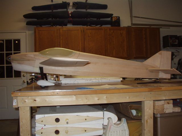

I put some pictures of another wood fuse 2M design on my webpage if anyone is interested.
It's Scott Dunphy's new design the TITAN .
As you can see, its a widebody design. Balsa fuse. Foam attachments. Glass canopy and chin cowl.
Very nice indeed.
I will be starting 2 of these after the holidays.
The plane is still being tested and evaluated by Scott, but he has graciously allowed me to get involved in the beginning stages.

The Titan looks very good. Is the stab just a flat plate or is it very thin? can't tell from the photo.
Keep us updated
thanks and Happy New Year!
-Will
Old 01-01-2003 | 04:11 AM
  #56
Posts: 540
From: Guntersville, AL
Default 2 meter plans
Its a modified eppler airfoil , or very close. Almost a 168, but slightly thinner, . Its a modified version of a well known pattern aircraft airfoil and moment.
Its fully symmetrical, and fairly thin, but not as thin as some of the airfoils of the past 5 yrs or so.
Looks alot like a Synergy 2M to me, At least thats the closest resemblance to anything else out there right now.
Stab is one piece design, Plug in wings.
I got my stab finished today. Going to start the wings tomorrow. Hope to finish them by the end of the week.

I posted some more pictures of the Typhoon 2000 on the webpage, as well as many new construction photos of my Titan.
The designer of the Titan is entertaining the idea of making the plans and parts available to the aspiring builder. I think it would go over great, as there seem to be many balsa builders still out there. I will keep you all posted on this if he decides to go this route. I truly hope he will. I have no idea how it will be marketed, that will come later i guess.
A few things I have noticed about the Titan, now that mine is framed up:
1. It builds light. No extra measures taken to make it light, there is just not many parts to make it heavy.
2. The engine bay is HUGE!! Maybe a zdz 40 gas in the next one?
3. It does not cost an arm and a leg to build. You have a balsa plane,that is lightweight, no noise enhancing fiberglass, and has the look of the European designs costing $1000+
4.. ,,and ,,Its dang pretty! at least to me
