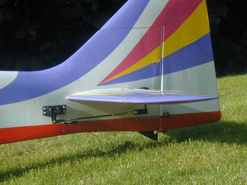

Have not got time to fully answer your post, but I will in the next day or so, just came on to try to upload the pic's again, success.

Default RE: Jamara Swallow-90
The servo set up in the rear looks nice.

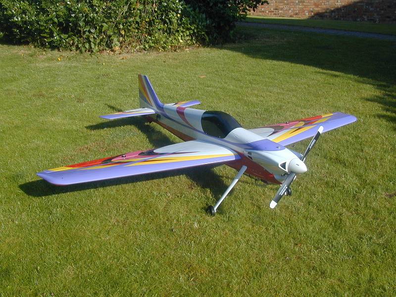

d-bodary
Thanks. Well flew it this week-end, first the rear servo's work very well, I was able to get the c of g at 160 without any additional weight, I should not have bothered, it needs the c of g moving back its nose heavy at 160 was not able to do that at the field as the undercarridge fell to bits on the second landing, addmittedly dead stick and over the horizon so just held it flat and prayed, no damage except for the broken u/c legs, I will replace them with a Carbon set from Carbon Copy in the UK. Untill I move the c of g to the correct position I can not comment on the abilities of this aircraft in fairness, but seems to be fair to middling at the moment, trouble is a friend of mine has the new CML Javalin S 90 the yellow one, and it is a very honest and good to fly aircraft, I only bought the Swallow because I could not get hold of one.
Of now for a few weeks fishing so will not be able to report any findings until I return.
MIke
Old 07-04-2006 | 04:29 AM
  #29
BaldEagel's Avatar
Joined: Oct 2005
Posts: 9,673
Received 6 Likes on 6 Posts
From: Kent, UNITED KINGDOM
Originally I had moved the rudder servo into the cockpit area to compensate for the rear elevator servo's, as I said in my last post a waste of time, as I now have to move the C of G rearwards from the 160mm I had it set at, so I have moved the rudder servo back, but into the middle of the servo tray not on one side as the manual. I now have the C of G at 170mm and will try at that when I get back from France fly fishing, Still thinking about moving the tank to the middle area to prevent C of G changes during flight, has anyone else done this?

Old 08-08-2006 | 05:35 AM
  #36
BaldEagel's Avatar
Joined: Oct 2005
Posts: 9,673
The swallow fly's rearly well once you get the C of G back to approx 170mm behind the LE, the UC is not good broke mine on the first landing the front extended piece broke away from the main leg, now have a carbon replacement from Carbon Copy in the Uk they make a direct replacement UC, I reinforced the seating by putting an extra 1/4" ply plate under the orriginal with a fibre glass strip between the two and up the sides of the fus internally, no problems for the last twenty or so flights, I have had a overheating problem with the engine but that is the engine not the planes fault.
Mike
Old 08-14-2006 | 09:48 AM
  #37
BaldEagel's Avatar
Joined: Oct 2005
Posts: 9,673
Still trying to get the C of G dialed in at the moment, verticals are true and so are loops so its looking good at the moment, just the nose drop in banked turns and having to hold up elevator in down lines to stop the tuck under. Will keep trying on this as I think this is going to work out as good as my Graupner Extra 300L.
