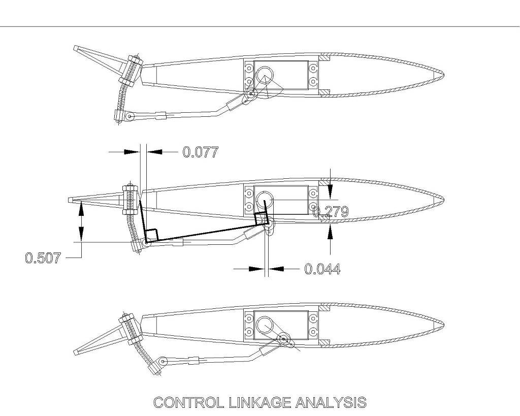

I did re-center the servo arm/wheel and adjusted the control rods...That's were they are not the same after adjusting..More threads show on one side than the other. Yes, I know, that is super anal but I want it puuurrrrfect
I did notice one servo screw was just catching the edge of the wood block..Not sure I like that.I'll try to post pics latter if I can find the darn camera
Back in the good old days before fancy radios you needed to adjust the linkage geometry to get equal throws or unequal throws, whatever you needed. The old ships that only used one servo to drive both ailerons via torque rods could very easily be set up to give exact throws and differential without resorting to dual servo's, endpoint settings and differential mixes, so it can be done mechanically correct first.
It's personal preference but I'd much rather spend 4 hours in the workshop getting the mechanical setup right, rather than spend 4 hours at the flying field trying to mix out the strange little things that are happening. With a correct mechanical setup you can get the deflections to match throughout the WHOLE range of travel and not just at the endpoint, very important if you want to mix in flapperons or when using dual elevator servo setups. Endpoints only get the endpoints the same, not everywhere else in between.
However, the final test is the actual measured surface deflection, and as much as I like the shed, there are times when one pushrod can be slightly longer or shorter than the other and I can't figure out why, but I've got happy numbers in the TX and the measured deflections are correct and matching so I just live with it.
I agree with what bjr_93tz said. Computer radios are fantastic, but if the mechanics are set up right it becomes a matter of fine tuning. Otherwise you are fighting a bad set up. The figure is a geometry study I did for an Ultimate I'm working on. For pattern, the throws would be more limited, probably by moving the link in on the servo arm.
The other figure shows the negative mechanical "exponential" of the servo output. (It's actually a sine function, not exponential, but the effect is "close enough for government work") The first 10-15% expo cancels out the mechanical "expo". I like to use about 30% to make those small corrections around center smoother.

I CAN get the control rod 90 deg to the servo arm.
Aghhhhhhhh I'm getting it now. I thought the servo arm had to be 90 deg to the servo...Not so! and if it's not you make up the difference in differential or throw percentages.
My Feedback: (8)
ORIGINAL: lablover
The relation of the servo arm to the servo body is completely arbitrary with respect to the surface throws.
The only reason the servo gets mounted parallel to the control rod (and thus perpendicular/90 degrees to the servo arm) is for, well basically structural purposes. With the servo mounted 'longways' it distributes forces over larger area of the wing structure, and will be less prone to deflection. This has absolutely nothing to do with surface throws, but ultimately will result in the best strength and response.
If you are running dual servos (aileron or elevator, etc), you are primarily concerned with the positioning of the servo screw, which holds the servo arm onto the servo. That screw, the pivot point, should be equal distance from the aileron/elevator control horn, and from the centerline of the fuse, for equal travel, response, differential, etc.
So, don't worry too much about the servo body being parallel or perpendicular to anything at this point. Make sure the angle between the control rod and servo horn is the same on both servos, and as close to 90 degrees as you can to start. You may end up changing this angle, but you want to make changes equally on both sides.
