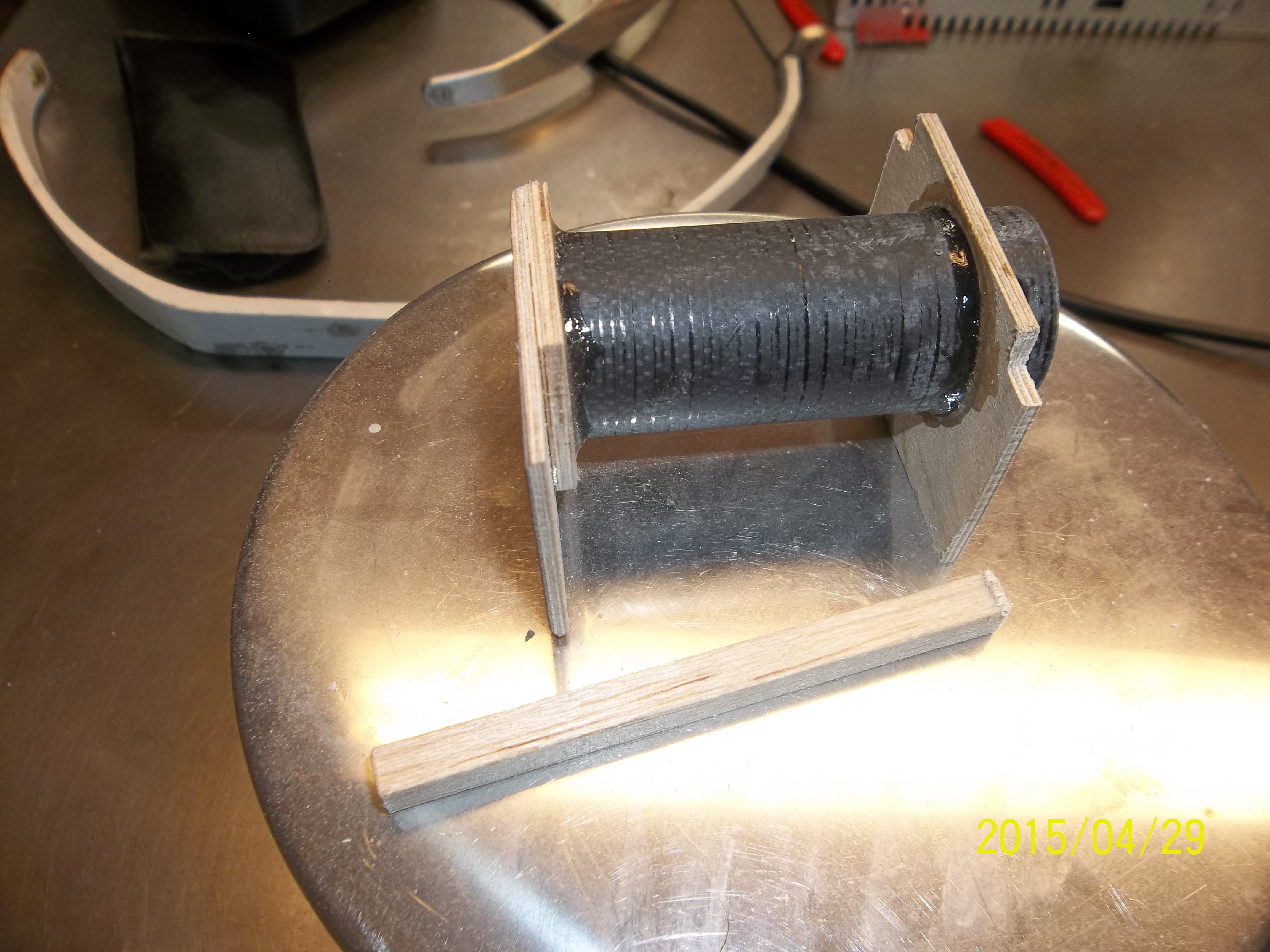

Default Evolution wing repair (rebuild)
Funny you did that, I was just re-reading what others have posted about the wing, I was just about to throw them into the trash and buy new wings when I decided to tear the bottom sheeting off and look at the construction. What I noticed was worse than I thought it would be but I think it can be fixed rather cheaply.
The issue with the failure is the center line length wise of the tube moved away from the center line of the spar, in the design used by the manufacture there is nothing I could note to prevent this from happening. Every wing out there built like mine will fail eventually. The first movement of the tube center line is microscopic each following movement will be greater until catastrophic failure occurs, this could happen in straight and level flight. In better design wings the tube is locked in place in the center of the spar. (This is basically the conclusion already discussed here)
So what to do about it?
If one picture is worth a , well you know.
R4 is the new end point for the tube R3 is factory location.
S1 is a 1/16" ply shear web extending from R3 to R5
R4 is 1/8" ply
The key is to lock down the tube tip at R$ so it cannot move off center.
questions?

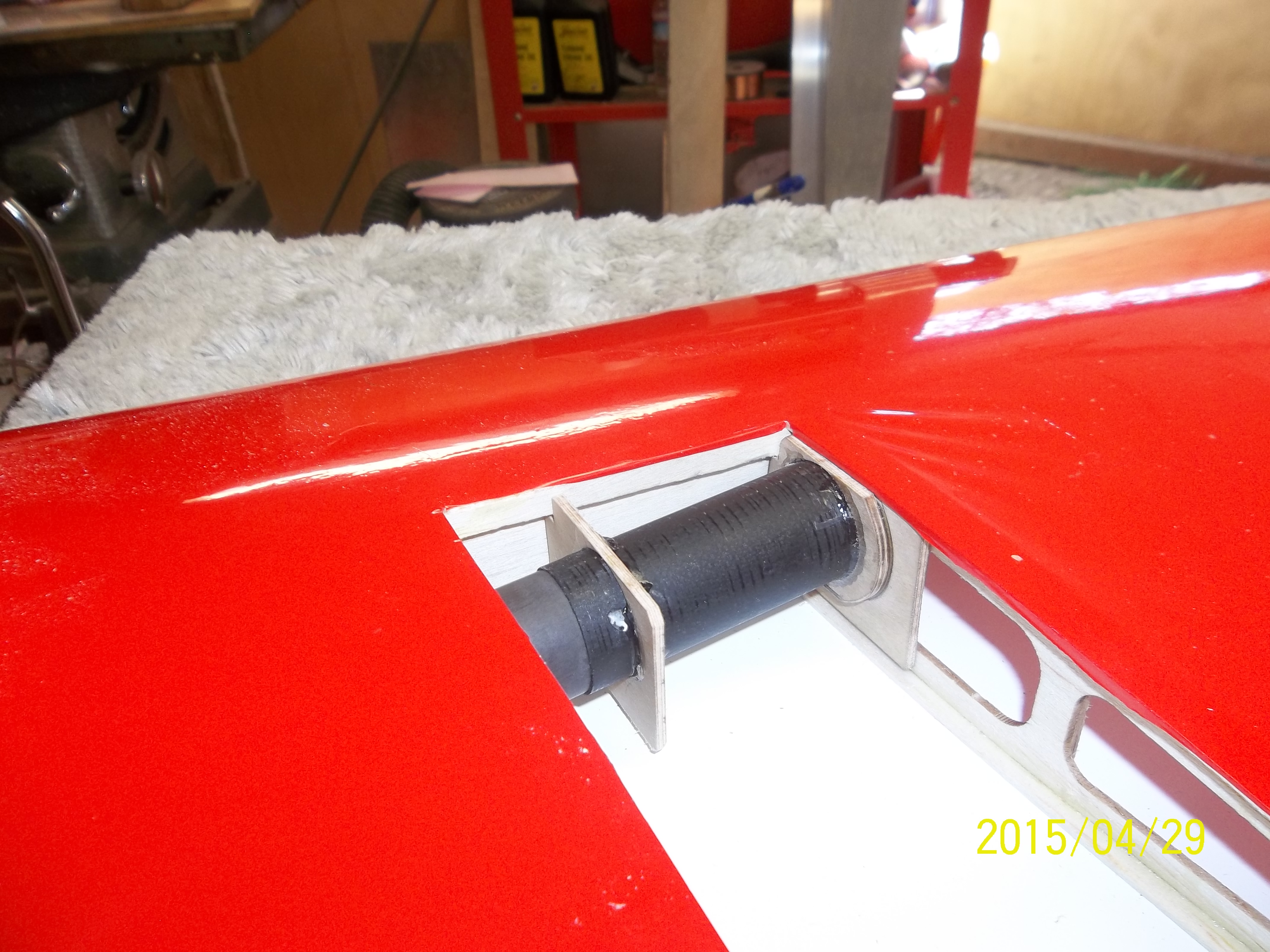

I bought a 1 in. dia tube from Graph Tech and cut it to 32 in. long. This allows it to but to spar. No wing sheeting needs removed. The spar is not what fails, its the short unsupported wing tube. The short sleeve pieces are from my first failed wing. Don't worry about the sheer webs. I did a lot of research and found the forces on webbing is diagonal so grain direction is optional. My plane has done many snap rolls and aerobatic flying without problems after modifications. Even though I had to buy 2 airplanes and a $50 wing tube it was worth it. I did a very accurate set up and trimmed by the Triangulation Method resulting in an excellent flying airplane.
Ray

Ray your fix is perfect if buying a new tube, its what I wanted to do, the rib does not need to be replaced if the tube reaches the spar. My tube cost nothing it was the remains of an old plane, it is a little to short to reach the spar but was very workable. I think between your photos and mine others have a good solution to the problem , thanks for the photos. You are correct , new shear webs with grain in any direction is a wast of time, the spar is plenty strong.

Just a point to consider, locking the tube end to the spar is not a perfect solution. The spar is strong enough for the job intended. With the tube end locked to the spar the tube end will act like a pivot point for all of the wing load. All wing load will be transferred to the root connection of the tube not the root of the spar. Hopefully this goofy setup will be strong enough for what we use it for. Just think, a little good engineering and this wing would weigh less, be easier and cheaper to make and stronger... unforgivable!

I forgot that I sent you a soft mount for the DLE. You may want to start break in when ready using 40:1 gas oil mix. I prefer and use synthetic oil. I use Bel Ray MC1, but many use Redline, Stihl Ultra, Pennzoil, etc. They are all excellent oils
I used an Xoar 19x10 laminated wood prop but anything from an 18x10 to 20x8 will work on muffler or canister. A pipe will produce extra ponies and mid range torque of course, but I didn't use a pipe of the DLE, only the can. The settings for break in were about 1 5/8ths on the HS and 1 3/8ths on the LS needle. It doesn't need to run rich during break in (not a glow engine)
The header I used was the standard MACS for the OS140. The holes were drilled out to 5mm; a convenient solution.
On the wing, not sure yet. If I can get someone to write me a laser cut routine, then making the ribs will become trivial. Right now I have to trace each rib using the tooling I created, carve every rib by hand and use the tooling to true them up. It's very time intensive. A labor of love. On the other hand, shaping each rib on the tooling builds in the correct angle of the rib edge to follow the wing panel surface angle. A minor point and it makes no difference to the flying, but what the heck, it's for me.
The wing tube sockets are built up; it's simple 1/32" balsa sheet that's been glassed on one side and cured. Then it's wetted and rolled onto the wing tube and dried, glass side in. The fit is custom of course; snug but not tight. Then the balsa is wrapped with carbon tow on bias and is doped in place. About 3 coats of nitrate dope is plenty and weighs almost nothing. Very strong and super light (about 6 grams per foot of socket, so 12 grams total for both sides). The carbon tow is not necessary if the sockets are put in foam wings, but my wings are built up so they might need a bit more strength and stiffness.
