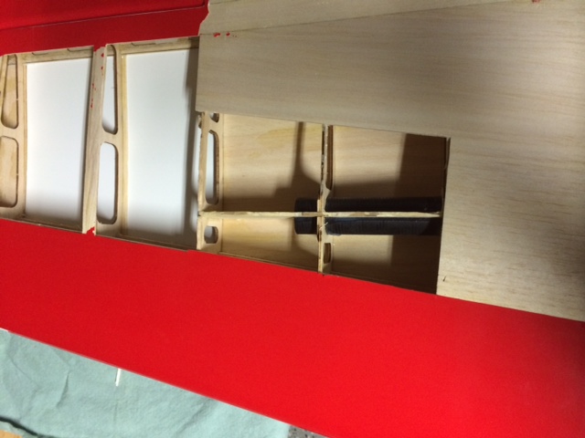

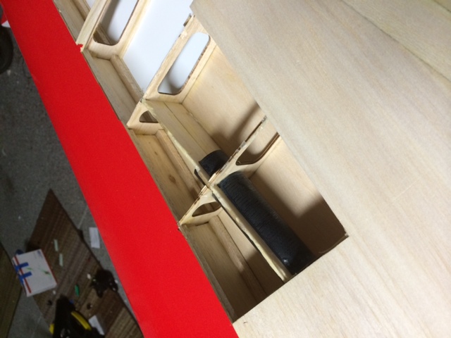

Here are some shots of mine with some of the sheeting removed from the bottom. You can see that the tie-in from the wing tube to the wing structure is simply a piece of 3/32" soft balsa that is split lengthwise into two pieces. The wing sheeting glues to these two pieces. The tube is secured through the ribs as well, but they're really fragile in this area due to their large lightening cutouts.
When the wing flexes upwards under load, the wing tube essentially stays in place (since it's secured through the fuselage) and the wing structure simply pulls away from it.
My initial plan, subject to change , is to build a box structure using 1/8" sheeting and 1/4" stock around the tube and carry it all the way out to where it intersects with the spar. I'll tie it in really well at that point. I'm also going to extend the lower wing sheeting out to the servo mounting box structure, and reinforce the ribs that the tube goes through. I think I'll also add some fiberglass cloth and epoxy where warranted to strengthen it further. All of this while trying to add only about 2 ozs lol... yeah right.
And of course I'll finish the shear webs on this wing panel, the other panel is done.

Adding some glue may buy you a little, however I don't think so. The structure that attaches the spar in the wing to the wing tube is lacking not only in structure, but also in the use of the grain in the wood. What you end up with is a fairly stiff I beam spar in the wing and the rigid Carbon fiber tube with what turns out to be a fuse between them (Like an electrical fuse.), a weak spot that will fail first. After looking at the wing I'm not sure that all of the failures are failures of the structure that connects the wing spar to the CF wing tube. Thus my decision to pretty much scratch the wings and build a new set. 99% sure it will be a foam core, balsa sheeted wing. Been building those for 40 years so far no failures. OK none in the air anyway. OK only ones that failed in the air were results of mid airs.
To fix the wing in my opinion you need to tie the third rib (Were the tube ends.) into the wing spar. In other words a strong ply rib surrounding the tube then into the D- tube section of the wing. Also a spar top and bottom of the wing tube from the wing root extending out to and attach to the main wing spar. In my opinion to do that type of repair you may as well build a new wing. Just my humble opinion. One thing I know for sure,100%, is the pictures of wings failing makes me sick to my tummy.
Good luck,
Mark

Once you reinforce the existing structure around the tube you had better beef the structure to the wing spars. You need to transfer the force from the I beam wood spars to the wing tube. If you leave the simple and weak balsa ribs to do the job you will eventually blow the "fuse" between the two beefed up structures. IMHO
Mark

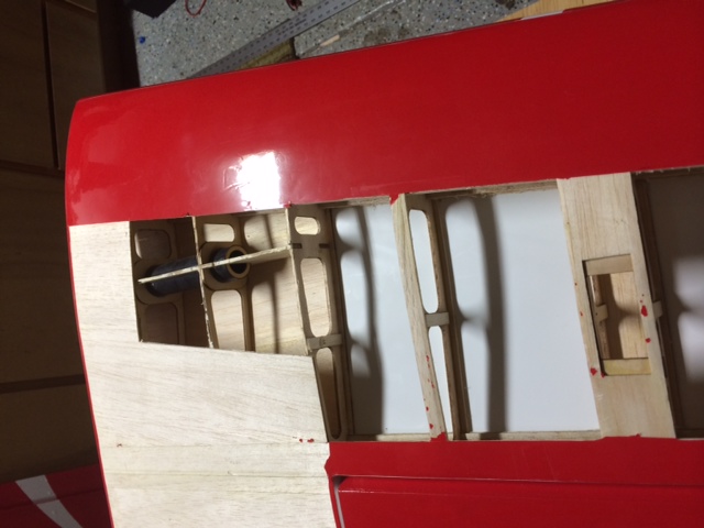

308jockey, did you ever get yours in the air? I haven't made much progress on mine, but hope to have it done in the next month or so. The wing mods are done, I just need to re-sheet the area of removed sheeting. The mods I did added 2.5 ozs to each panel. I'll post some pics when I can.

I filled the first 2 bays in front of the tube socket with expanding foam and added vertical shear web to the rest. What do you guys think?.
Ray
