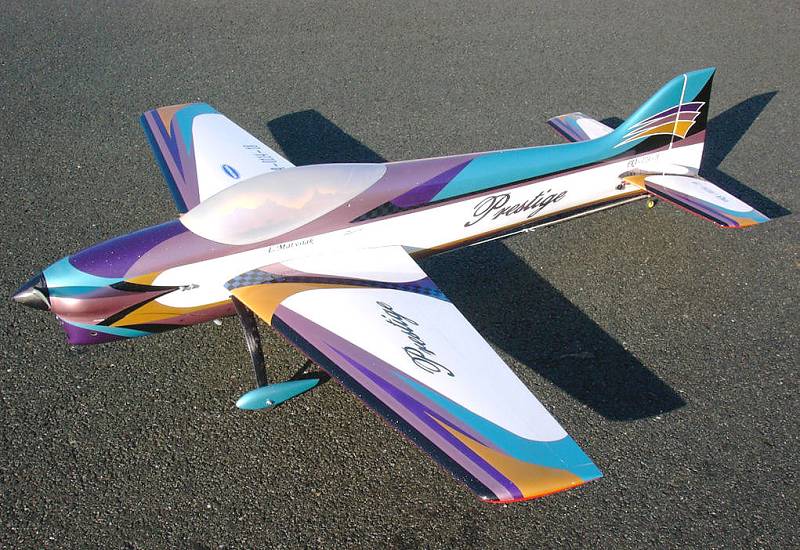

Hello
Thank you Matt and Jason for your answer about sub fin Dave'Prestige.
I'm going to relate the reasons to my friend Lolo owner of Prestige (original french design).
Claude

Very nice looking model Claude.
Subfins immediately below the top fin help counter how the spiralling airstream deflects off the horizontal stab and hence reduce the pitching to gear many models display. Some models require less and some more depending on other attributes a model has such as fuselage shape and power vector balance about the centerline. Another straightforward way to add ventral fin area is using anhedral in the stab. There are some detriments to anhedral stabs but the benefits outweigh these.
Another way to counter the effect of the spiralling air stream is to add a similar fin forward of the regular fin...this would be called a dorsal fin.
This type of "fix" helps reduce the pitch to gear with applied rudder to more manageable levels and the rest is then easily eliminated by electronics.
The best set-up of course is to have a model with zero coupling requiring no mix at all. That's a rare accomplishment but can be done with dilligent effort as Dave showed.
BTW, in CPLRs case the T tail behind the canopy helps straighten the spiralling stream some but helps rudder effectiveness even more. Consider a simple natural example, the shark, with the original version of a dorsal fin. Take the dorsal fin away and the shark wouldn't be able to turn on a dime as it does, and probably wouldn't be the predator it is.
And Jaz, my apologies in advance for the skyjack. Have you flown that other model yet?? Still looking for a flight report
rgds
Matt

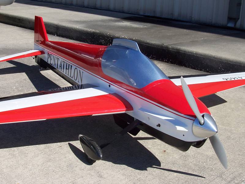

Here's an example of a design called the Pentathlon with the fins Matt described in his response. Got the opportunity to fly it myself through a few maneuvers. Has no detectable pitch or roll coupling with required top rudder for 4 pt roll, sloooooow roll, and knife edge to sustain level flight.
Go to http://www.geocities.com/markhunt_2000/INSIGHT to read more about this design.

In looking at the Pentathlon, and knowing its roots, the flight characteristics described are in line with its "cousins".
So, it appears that things are changing some in thepattern community but i find it funny that only after people "wellknown" as CPLR or QQ Som. use these "canaizers" or fins or whatever do they become "acceptable by everyone else.
i guess, unfortunately, we are a pattern fold tend to follow the herd, yet when others go against the grain (ie voodoo express) we tend to frown upon them becuase of the "different looks".
SO, as judges do we still tend to grade the plane instead of the maneuver? I have heard comments in regards to biplanes along the lines of "it looks different and hard to judge".
Are you kidding me??? so anyways... are these new designs that push the limits of contemporary stye pattern ships.. ie Twister, integral, Scandlous, narlar bipe (adventure) at a disadvantage unless being flown by a "name" top performer?
Just some thoughts, not complaining or *****ing, whining, just wanting to spark some chatter to opening the minds of those who think that planes such as the Pentahlon , Twister , (any bipe).
Is is time to challenge the status quo of pattern design sch as when we move to "widebodies" to where we are now making the next step in performance rather than aesthetics?
Hmmm, looking forward to any thoughts..
Chuck
