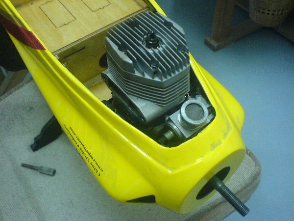

I just got my leo 110 and need some advice pls.[]
Here are the specs.
Wingspan
1740mm
Length
1770mm
Weight
4.2~4.4 kg
Wing Loading
77~81 dm/2
Airfoil
Naca 0012
Wing Area
54.2 dm/2
I have these two spare engine that I can use.
Saito 150 (with an inverted slimline smoke pitts style muffler) and
OS 120AX (with the standard power box muffler).
Which engine should I use for my leo? I don't have a perry pump at the moment.
Option 1 (SAITO150 with smoke muffler): Shifiting the fuel tank forward and putting a smoke tank at the CG and a smoke pump.
Option 2 (OS120AX): Get a perry pump, tank CG position, but Power box muffler sticking out.
Thanks in advance.

Why do you want a pattern with smoke? It is supposed to be as light as possible. Put in the Saito with the stock muffler. My 2 cents...

Saito i heavy, use the 120 ax.

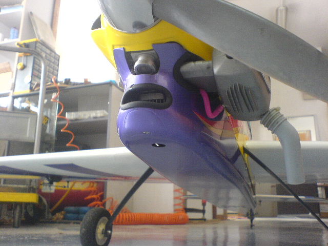

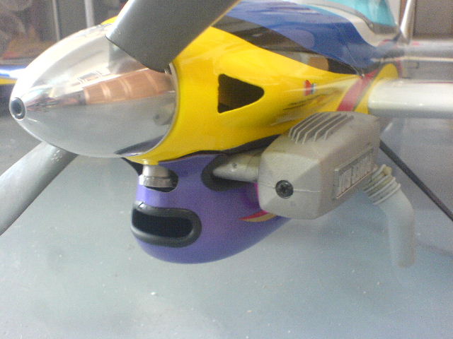

Decided on the 120AX. The smoke was not for this plane actually. I just got for another plane and thought of using it on the leo cause of the extra space I would have. I very new to pattern flying and learning alot form other threads and realised its not a good idea to add more weight. I just got myself a perry pump and now hunting for a header and a tune pipe that would fit the 120AX.
Any idea what a good size prop should I use?

APC 16X8 is what I use with the stock muffler. Probably a good brake in on the pipe; then move to a 16X10 APC.

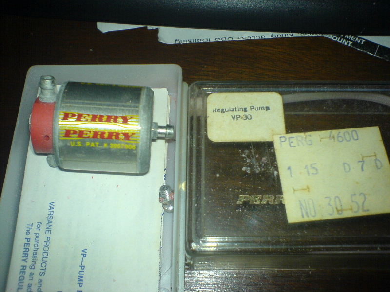

I got a perry pump from a friend but I think its the old version and it looks old and corroded abit. Model VP-30

Can any one recomend me a good fuel pump for this setup? OS120AX, CMPRO Leo, Tank at CG point. Using standard Pbox muffler. Distance from tank and engine about 12 inches. Thx
