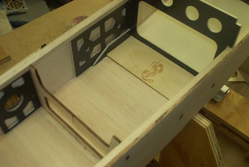

What it is:
A true thoroughbred plane designed for the most challenging FAI sequences.
Although mainly constructed from wood and foam, many composite parts are utilized for ease of construction, strength and weight considerations. This was done primarily because I have to build them myself to make weight with axi outrunners and the heaviest of battery packs. I didn’t want to have to pull my hair out to make it happen. Well, let me tell you now....it’s easily doable. This plane is the lightest, strongest and most durable structure in the world today. And that is including fully composite planes. Some may be lighter, some may be stronger, but none of them are this light AND this strong. Coupled with a design that flies like this.....BINGO
Designed from the ground up to be a laser/CNC kit. Parts interlock via built in alignment tabs. These kits are like nothing you have ever seen before. Every single piece of this aircraft has been well thought out, engineered for maximum efficiency, strength to weight ratios and durability. Parts have been tested, fitted, retested and refitted until nothing is left to chance.
Ease of building and relatively low parts count were of utmost importance to us. All wood is hand picked and cut to perfection. Once the foam cores are sheeted, an average builder can frame this plane to the finishing stages in only a couple of week nights and weekends. The work involved isn’t too much more than your typical ARF, and argueably easier than the lower end stuff. If you possess the skill to build a Sig Kougar or a Kaos, you can build this plane with ease There really is nothing to compare it to, because before now it didn’t really exist.
What it is NOT:
It isn’t anything like you’ve ever seen before in a “wood†kit. Forget the preformed opinions and stereotypes about building in general and wood planes, because they simply do not apply. If you “don’t have time†to build, you may now be kidding yourself. If you “can’t build a plane as good as the chineseâ€, you may again be kidding yourself...you can do it MUCH better. Finishing is still up to you of course, but the actual structure of the plane itself is extremely easy, rigid and light. Complex shapes were kept to a minimum so anyone can use monokote on all but the composite parts.
Forget the stereotype that a wood plane is heavier than a composite plane of the same size, that is utter bull crap and a generalization that is as old as the first composite plane ever made. It is simply untrue. All that is required is the right materials and the right design and engineering. If you put 3 lbs of paint on it, that’s your fault =)
Forget jigs and fixtures, you simply need a flat table with a single straight line drawn on it. Although I still much prefer the use of a jig, it can be done without one very easily.
This plane is NOT simply an updated or bashed version of the Black Magic V2. The entire design is completely different, from the ground up.
This plane is NOT an ARF. Although you do have to build and finish it, even a rank beginner or a person with very little time can easily have an airframe comparable to the most high end ARFs or professionally built planes.
This plane is NOT a compromise in any area. Some aesthetic things were kept simple for the sake of time and weight, but the plane itself is a cutting edge flyer. The kits are borderline ridiculous in quality.
This plane is NOT small. It is one of the larger F3A planes in the world. If you don’t like the “pregnant guppy†look, you will probably hate the looks of this plane. That’s ok, to each his own. Fly it then tell me how you like it.
This plane is NOT specifically an “entry level†plane. If you are not fairly comfortable with the left stick, you will be very soon after flying this plane. With that said, it is one of the easiest planes to fly, including heavy winds. Judging by the sheer size I was afraid it would act the same in crosswinds as other planes....it does not. This plane is designed to penetrate turbulence, yet still offer very slow downlines. The flight speed envelope is VERY wide. Don’t be shocked if you find yourself adding power in downlines.

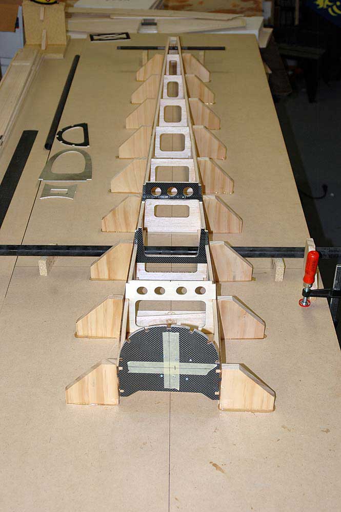

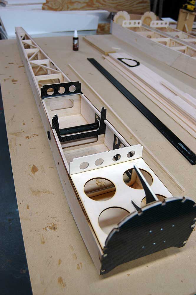

Hey Guys,
Some of you all know I've been good friends with Mike for a long time, actually it was love at first site, well I mean at my first pattern meet (Andersonville, Ga 2005) I saw the lovely Black Magic V1 prototype sitting in the pits. It was brand new, all done up in cub yellow and metallic blue trim. It was true love, I didn't know what that plane was or who owned it, I just had to have it. Well to make a long story short, I ended up becoming great friends with Mike and Melissa. I started building a V2 at the beginning of last years pattern season. Yea, I went though the ups and downs of pattern life with two midairs last year, the last one taking away from me that Black Magic prototype that Mike actually gave me after my first midair earlier in the season. Love can be tough at times. But I learned a lot about pattern, flying and competition from Mike and my other close pattern friends last year.
I was lucky enough to win a sheeted kit from Mike for my districts finish last year and Mike gave me the option of waiting a bit longer for his newest creation. It was a no brainer - I said "yes... hell yes" most likely the best decision I've made in a long time.
I've started my VF3 build last weekend, first I made a "fixture" style jig. Which like Mike says it isn't even needed because you can actually tape the fuse together, line it up on a straight line and hit it with CA. You can build the entire crutch in less than 2 hours including assembling the fuselage sides. Right now the most time consuming part of the basic fuse build is hand cutting the flooring which Mike is considering having laser cut. What is nice about my fixture jig is you can align the wing and stab tubes at the same time. Pete's jig works the same way. I also have Pete's Jig and have built a number of fuses with his setup as well, I do recommend Pete's jig to anyone.
Mike is right, this plane is so easy to build, it's freaky. I am rushing to have my secret weapon done in time for the majority of the D3 comps and Nats. To be frank about it, it's my only hope to have a good districts finish as I am up against some very great pilots in D3.
Here is a couple of shots of my build,
yea it's a VF3 BABY!
cheers all!
cheers all!

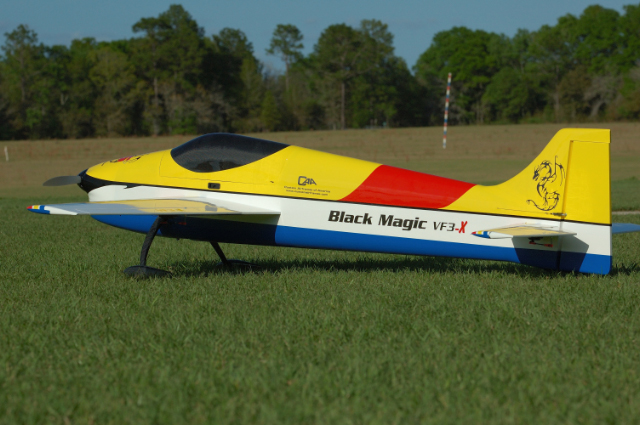

Steve, the plane in the pictures is all monokote. I intentionally kept some things simple just for that reason. the only 2 tricky spots are the fin area where it blends into the fuse (which may be replaced with a composite fin, working on that now) and the area right behind the cowl.
I did the fuse and rudder in one day.
-Mike
-Mike

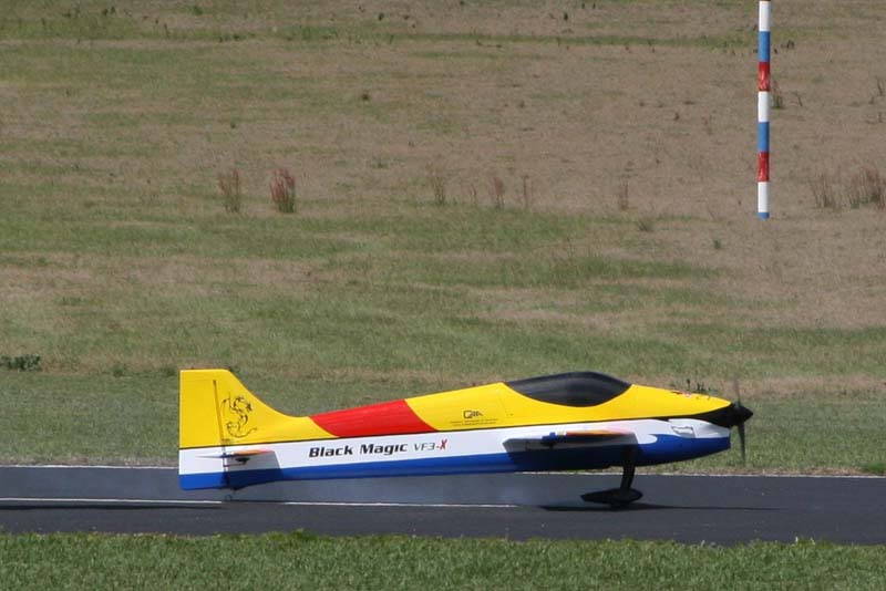

Here is some pictures I got of it in Ocala, to bad we were not able to get some in flight Mike but GMA is just around the corner. I will send these to you as well. See you in GA!!

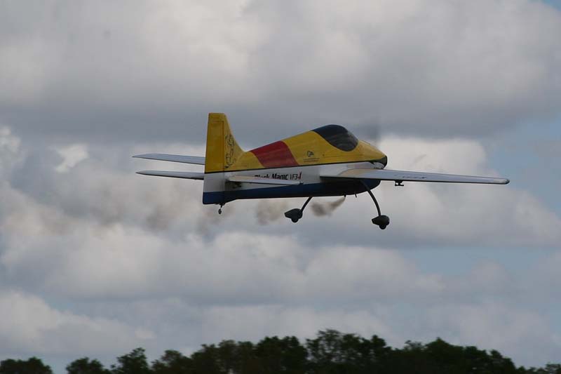

Guys,
I had the honors in Ocala with flights 1-3 and have the prototype now for more flying and evaluation. Getting the prototype in the air was fantastic "Team" effort with Mike & Melissa bleeding balsa dust,-paint-monocote, Dean adding some trick graphics, Jim Ivey checking on things, Don Hamilton's YS 160 setup, and I monocoted the wings/stabs and added the radio stuff to the equation. It all came together hot and fast with in the end to make it ready for Ocala, it was totally worth it, and I'd like to thank Mike and everyone for their contribution and hard work!
The plane flew INCREDIBLY well right off the bat. Anyone could fly this plane without mix and be very happy. Mike hit the CG spot on and it was off to some rate/expo adjustment and into F07. This plane has HUGE side area by flight #2 I was into Rolling S's, rolling circles, 1/2 outside loop with full roll, knife edges, -I even threw in some straight and level once in a while! The plane has an uncanny locked feel to it. It could do full field passes in very bumpy air hands off. There were a bunch of other planes in the air and you could see them being buffetted, where as the VF3 was just glued in place in the air! It was a pure joy and pleasure to fly.
This plane in one rollin'mother!! Even at low horizontal velocity the fuselage barely shows any kind of angle - like during 20 mph down wind, 1/4 throttle knife edge bottom of the reverse triangle loop. Later at the contest there was a line of folks waiting to try - most the FAI guys were drooling over it. While the look is of course similar the V2, one said after flying, "... This is a totally different plane." I say that to enforce that this is truly a new and different plane build for a single purpose - loop/roll-combination stuff, and by the way, happens to be the best overall plane I've flown too.
Last Saturday I flew it again at the home field on my own setups and transmitter and reinforced all the initial beliefs. Number one, it trackes EXCEPTIONALLY well in the wind. Miami was 15 gusting 25 down the runway. I flew it up down the runway, then turned 90 degrees for a sequence and the plane is just effortless to fly in the wind. I consistently did the BEST rolling S and 1/2 outside loops of my life! Gentleman - this plane has taken quite a bit of mystery out of these crazy maneuvers by being designed for them from the start. It has never been easier to hit pitch/yaw/roll at the same time during the exit of the 1/2 outside loop with full roll. Upline point rolls in the winds stay ON LINE, with only a little to no deviation - read as no excessive "lean-into" the wind type of effect going on.
My main feeling is that this plane is going to turn some 940's into 980s or 990s because I can SEE where it instantly cleaned up some areas I've struggled with - making them easier to perform, and dare I say, adding even more confidence to the pilot. Also - get ready to use throttle management.... on the downlines. If your YS is ticking at 1900rpms at takeoff, you'll have time for coffee and dohunts even during the 1/2 outside loop from the top with opposite 1/2 rolls -all while the "haul-but" option is still present if you choose to wield it (even on the 18x10)
I am VERY excited about this plane! I think it is going to be a scoring weapon for anyone who is flying one. I've struggled not to make this post sound "over-the-top" and actually resisted most the adjetives I've used disucssing it with friends. I will leave it to the others who have flown it to chime in if they want to. I congratualate Mike for bringing a world class plane, designed for the toughest manevuers, into a US Manufactured laser-cut kit that will be accessible to the pattern community.
My pesonal feeling is that folks are going to start to re-examine building again. There was a time that in order to get a new-cutting-edge design, you needed to go Euro with a ZNLine or PL Prod plane and the wood kits fell off the planet for a while. Now that the 'kit' community is up to speed again, I think the "builder" inside the "pattern" flyer is going to emerge once again because face it guys, we like things done our way...
Jim W.
