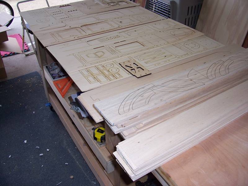

I have been hit with a few PM's requesting a new thread to document a start to finish kit build.
Step 1
First, inspect the contents of the kit...make sure everything is there.
Have a look at all the laser wood parts and the foam parts, make sure there was no shipping damage, etc.
You will want to check out the enclosed CD which contains many, many photos, dimensioned drawings, and most importantly, build notes. Feel free to play with your new stick plane will reading through the build notes.
-mark
