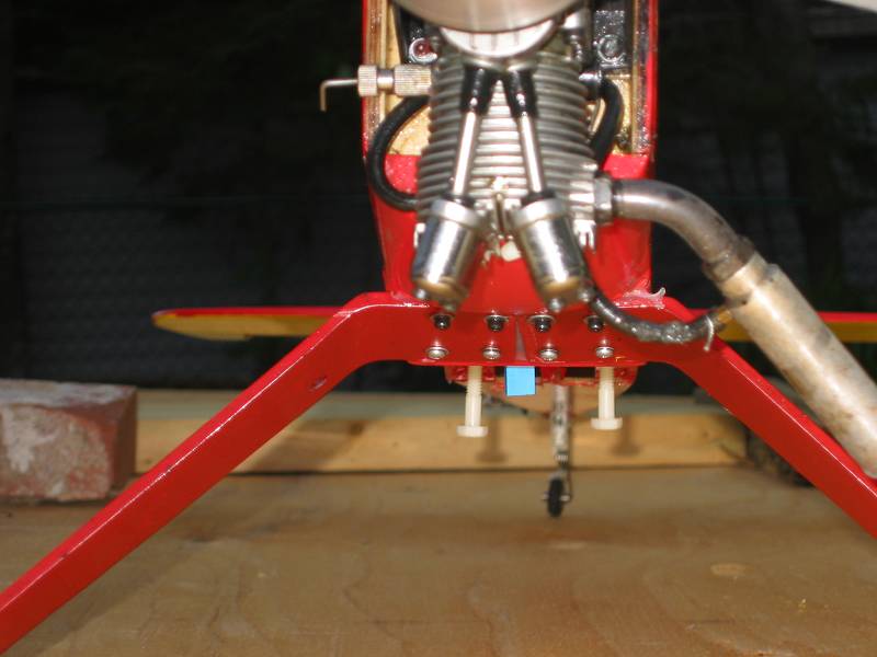

That is the question.
I've just bought a nice curvy set of Bolly landing gear legs, and I'm trying to figure out if I should cut them.
As it stands they're about 15mm (just over half an inch) too narrow for the fuse, but I figure I can fit some webs off the side of the fuse so that the legs appear to come out in the right spot.
Ooor, I cut them and spread them out the edges of the fuselage.
What's better?

I have cut lots of landing gear in order to fit the fuse width. Alumin., CF, FG, etc. Never sorry I did and it is the perfect time to put a bit of toe in in the gear and make it track better.
Here's an example of 1 of probably 5 I've done

If you decide to cut, install a small CF plate between parts to add strength if it's really needed.

cut and spread, then when attaching them to the fuse, put a "doubler" to support the gear as it flexs down like Kema suggested.

Another advantage to splitting the gear is that if you rip it out in a hard landing there will be less/no damage to the pipe -- if you are using glow power.
