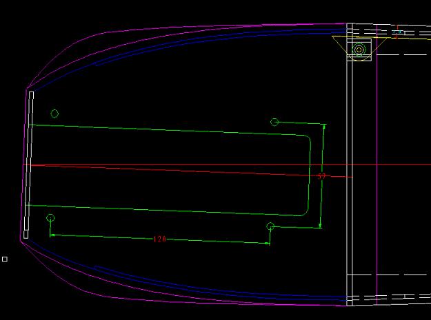

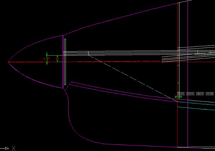

more engine mount inform for Element 170
ID:	1011012   Click image for larger version

Element 170.
Side trust: 2.2 degree.
Down trust: 0.5 degree.
Trust Line: 10mm (for mount space)
Rail mount thickness: 6mm
