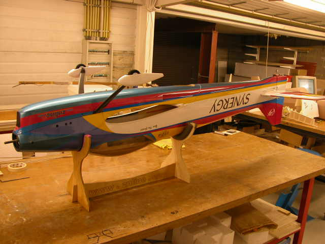

Our coverer and good friend Yves came by today to do some machining on his cylinder heads for his Synergys. He uses the OS1.60 with Cline Regulator and relieved some cooling fin on the left side of the head to allow a little extra clearance. The tiny bit removed should have zero effect on cooling, so not to worry.
Here are some photos of some things that have been done a little bit differently on this airplane.
Of course, first I want to identify the owner. He did ask CPLR for permission to fly with this paint scheme.

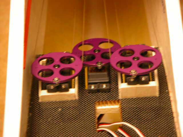

Default And the servos mounted.
He used aileron servo boxes to raise the elevator servos.
This is a six stringed Synergy. I wonder if it can play "Stairway to Heaven" while on the upward line of an hourglass.

Also, do you know what brand the servo pull pull wheels are?

Yes, please. I love the look of those servo pull-pull wheels. Whose are they. Please excuse the drool marks. thanks

Let me quess on the control horns and clevis. The control horns look like standard screws, washers and self-locking nuts of the appropriate size with MK little plastic screw-on dewhickies. The clevis are Tettra. How'd I do. The wheels still stump me.

Threaded rod, nylon washers, and locking nuts.
I am not sure about the pull-pull wheels. I think Hangar Nine makes the equivilant in the USA. I will look into the purple ones. I do like purple.
The pull-pull sets are Tettra pieces, coated steel cable, clevises, really simple stuff that just works so nicely and leaves money for those more critical attachements, like MK B.B. Adjusters which are very expensive but I think worth it.

Hi Mark, those pull-pull wheels are fabulous ! Did a search on H9 and CH and couldn't find anything similar. Could you kindly find out ? Thanks ............

anyone know if those wheels are avialable for hitecs ? I've been looking and it seems they exclude hitec for some reason. thanks for the help
