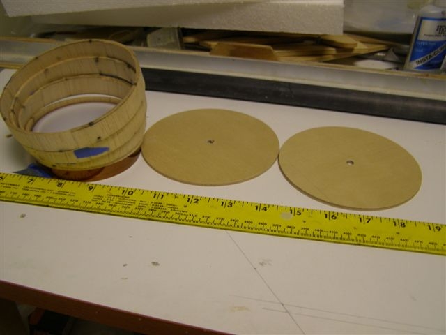

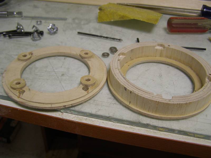

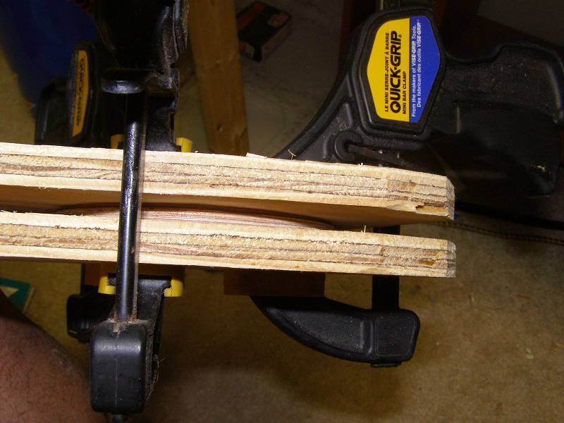

In this thread, I will be posting progress on the soft mount I am building for this engine. It may be of some interest to some Pattern folks who might have an interest in this engine. It is a bit heavy by Pattern standards but I am estimating that I can build my new design under the weight limit. Regardless, the new design is fairly large by current standards so it will be able to absord the extra weight with no effort

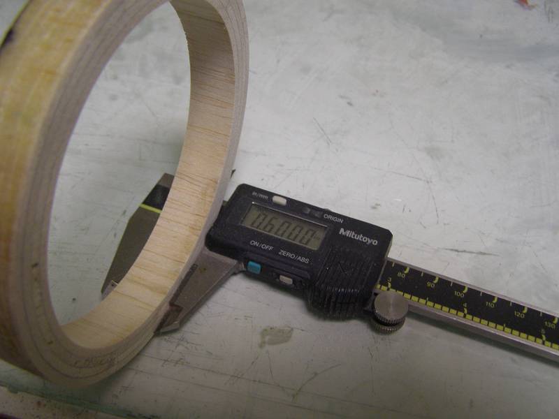

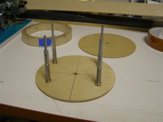

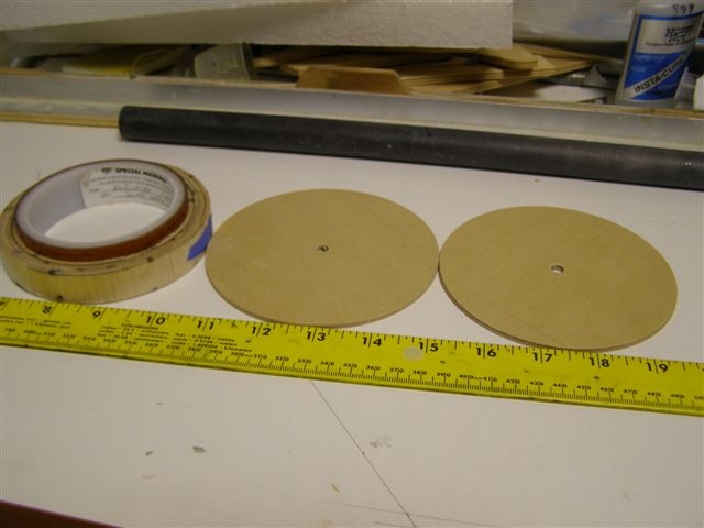

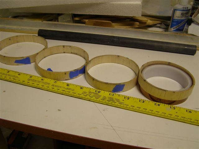

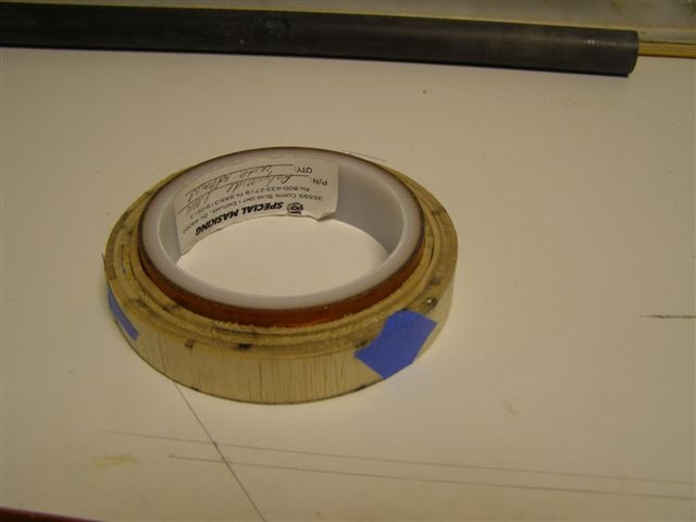

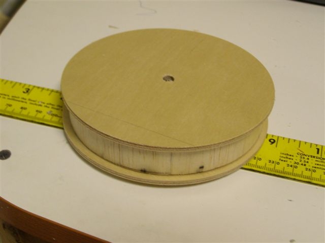

The first photo shows the loosely assembled set of cross grained balsa rings that will form the spacer section of the mount. Not glued yet
The second photo shows the individual rings with a ruler for scale and the third, the spacer plus the front and back 1/8" aircraft ply discs
MattK

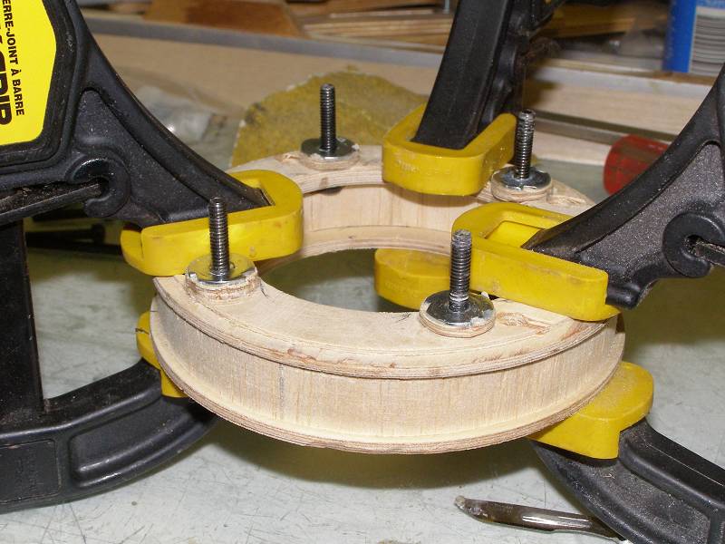

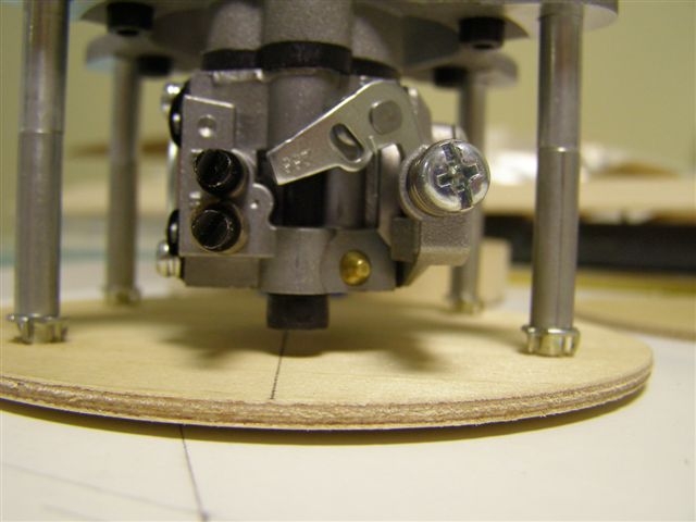

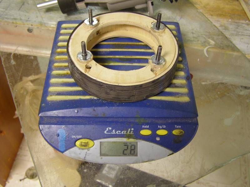

Some more progress
MattK

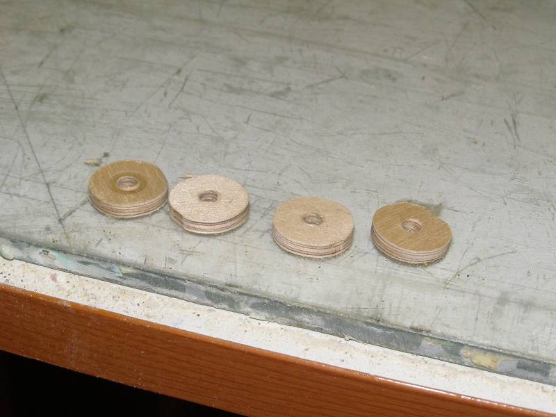

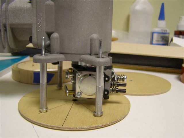

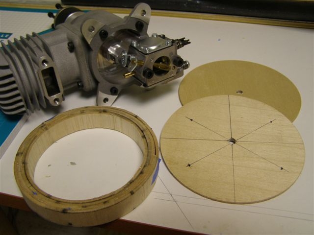

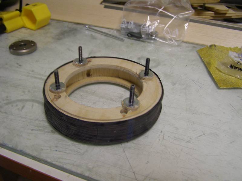

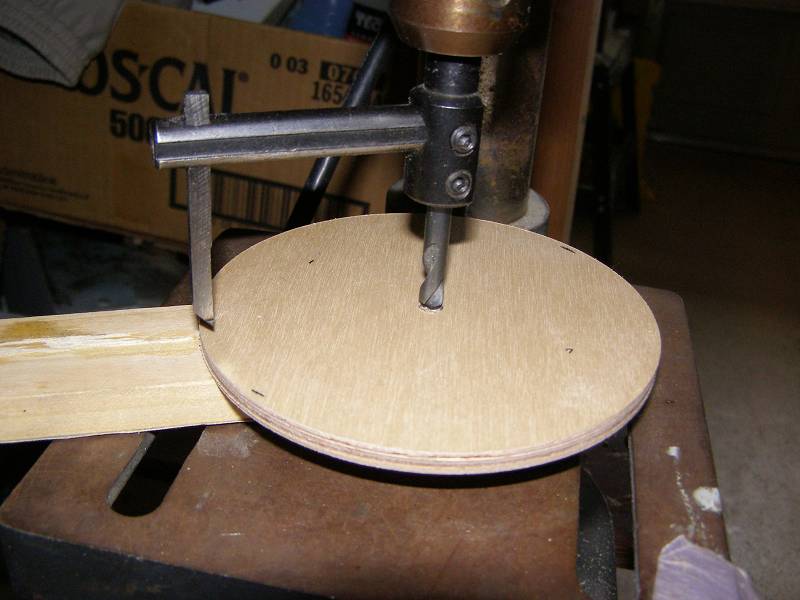

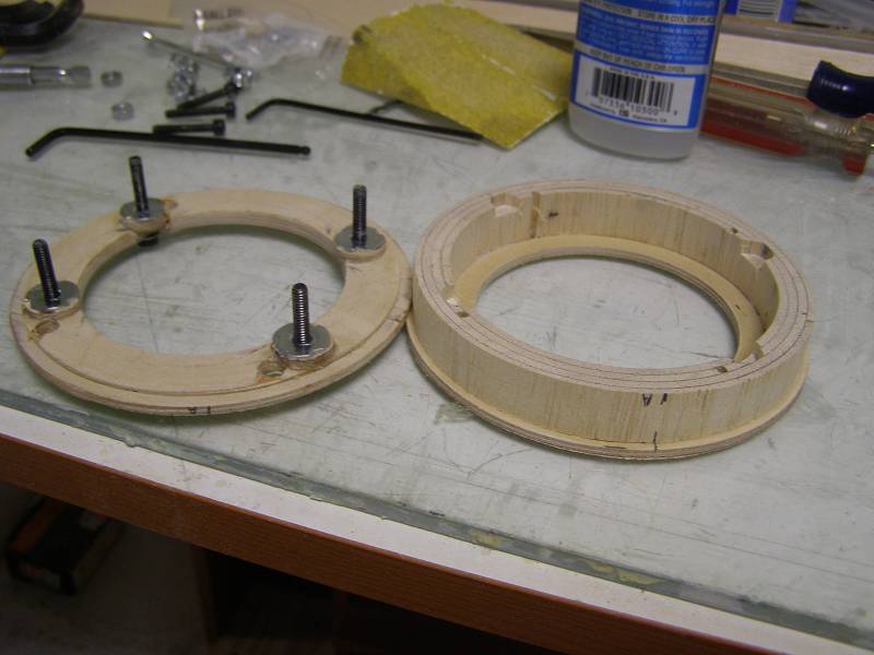

And a bit more. The idea is to assemble the whole thing, then remove the unecessary portions
Mattk

Old 08-28-2007 | 08:28 PM
MTK
Joined: May 2004
Posts: 5,386
From: Whippany, NJ
Default RE: ZDZ 40 RE F3A Soft Mount
Construction is 1/8" aircraft ply, 1/16" aircraft ply, 3/32" cross grained balsa epoxied with 2 oz glass cloth between the layers
Rubber stock is from inner tube of a lawn tractor wheel purchased at local ACE Hardware. Cuts easily with razor knife.
Note that rubber must be thoroughly cleaned with rubbing alcohol to remove any soap the manufacturer used to release the part from the mold. When this is done correctly, the rubber will adhere with regular CA glue to rubber tearing strength.
Note the weight of the nearly finished mount is about 3 ozs....quite acceptable for this size engine
MattK

Ran into a problem with the lawn tractor rubber. Just a little too small for my purposes. Purchase a larger rubber inner tube from the local motorcycle shop that's just right. The rubber diameter is 4" and the mount diameter is 4 5/8"....slight stretch putting the rubber in tension, but not so much as to make it stiff. It feels just right actually
Have the mount installed on my bench top and am just about ready to run the beastie. No nose ring yet but the rubber components are here already so I just need to build the thing. Prop is a zdz 20x10 for break in, zdz 20x12 after break in. It will be interesting how much noise the intake will generate since it is practically inside the doughnut
