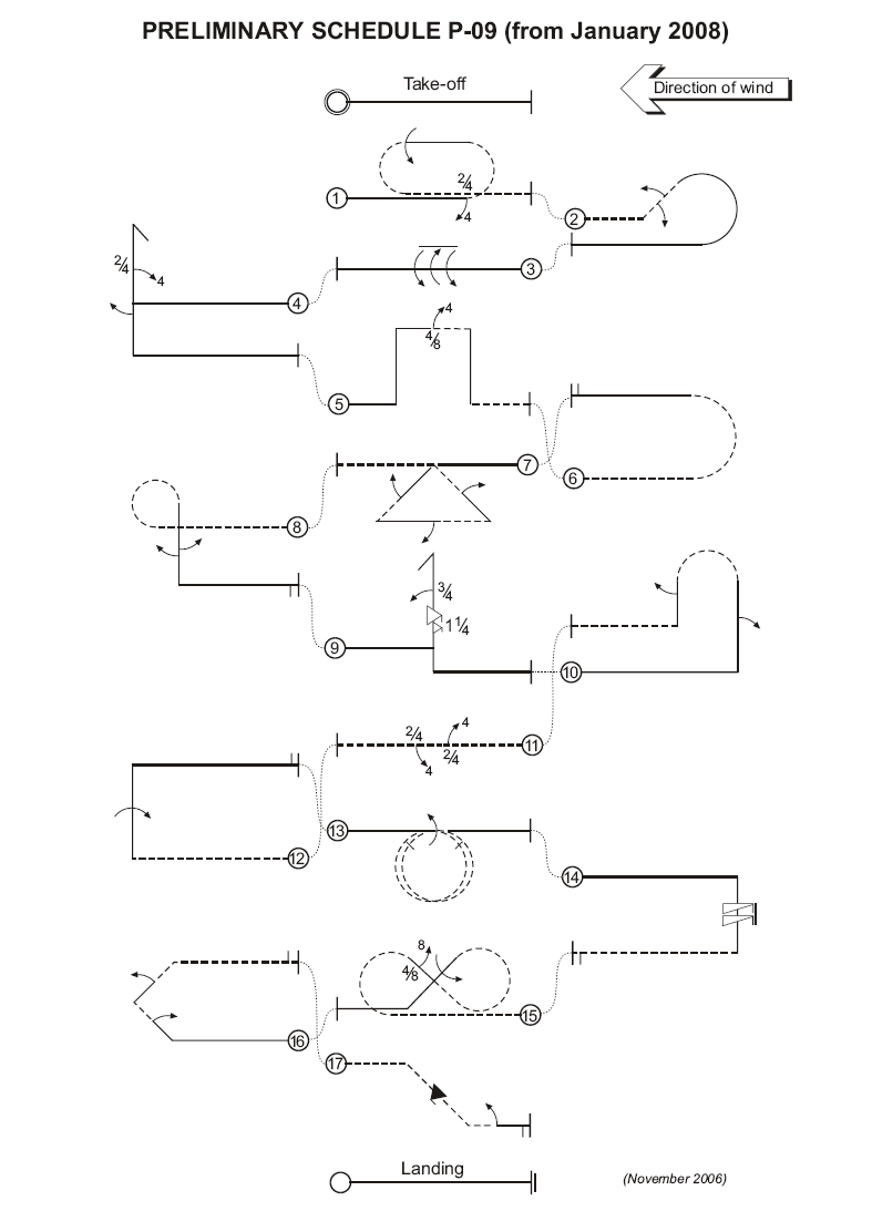

Very nice flight. I have a little question, in your video in manouver Nº 9 you perform a 3/4 point roll in the up line and a 1 1/4 positive snap roll in the down line. In the P-09 schedule (Aresti drowings) the manouver Nº 9 seems that have to perform 1 1/4 positive snap roll and 3/4 point roll in the up line ?
Which one is correct ?

The snap is on the downline.
-M

copied and pasted from the original description at the FAI meeting:
9. Stall turn, ¾ roll up, 1 ¼ snap roll down 5 (5being the K factor)

Interesting. As the figure is drawn it shows a 1 1/4 positive snap followed by opposite direction 3/4 roll, all on the upline. Notice figure 4, it shows the correct way to draw a hammerhead with rolling elements on up and downlines.
When will the official aresti and maneuver descriptions be posted by FAI?
