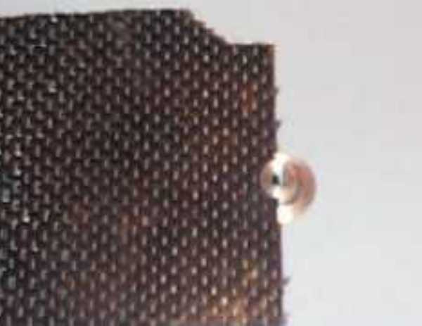

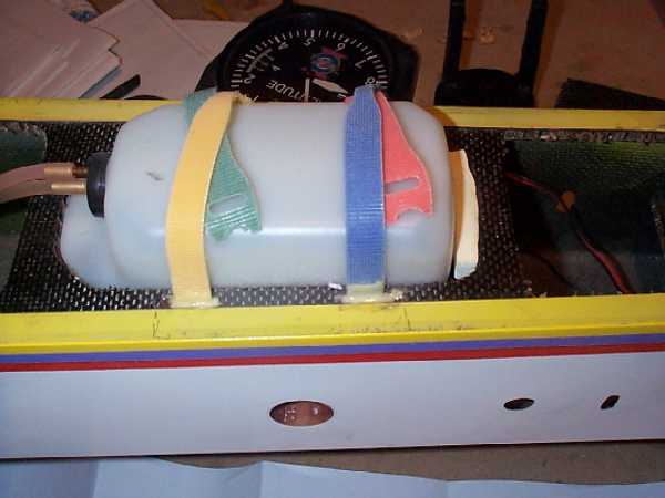

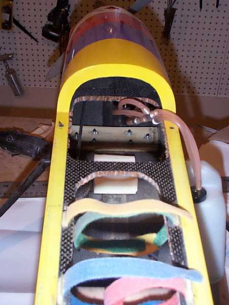

I have a pic on my website of the servo trays which are the same layup as the firewall, when I get home I will post more that I have on my local drive.
http://members.shaw.ca/patternwest/technical/ch.htm
It is important to use the correct cell size to help prevent crushing, but the pictures I have at home describe how I keep it non-crushed better. I saved probably in the neighbourhood of 4 ounces on my Vector, and have a much stiffer mounting for my servos.

Old 03-01-2002 | 04:27 AM
can773's Avatar
Posts: 2,286
From: Calgary, AB, CANADA
Default Composite Qns - Pattern Planes
As promised pics of what is going on
This one is showing an aluminum fitting that we made to support the plate. The part of the fitting that is in the plate takes up the compression loading from the bolt, and the larger diameter that sits outside takes up the thrust load and the torque loading on the glue in shear (minimal). These can be made of a peice of dowel and a ply disk, the bolt runs all the way through the fitting.

How many layers of CF cloth are there on each side? It doesn't look like more than 2. Very creative and innovative solution . I'm going to try this on a smaller plane with some 1/8" nomex core I have. I built composite landing gear a couple years ago with 1/8" nomex and CF. Very light and extremely stiff. I've worked in composites professionally for 3.5 years, building models with it for 12 years; way back before gassers went main stream with composites
ps: that hybrid stuff is nice but beware that you aren't getting dyed nylon instead of dyed Kevlar (aramid). The nylon hybrid's color fades less in sunlight but also sands like cr@p (worse than the kevlar).
It is just a single layer of cloth, as you probably know the strength even from one layer is pretty high for this application. The only place I didnt use it (well I did but it didnt work out well) is the landing gear.
