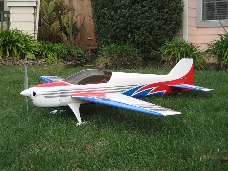

Got mine ready and now just waiting for a sunny day to test fly the plane.
Overall, the kit quality is very good, and very easy to put together. Hopefully the plane will fly as good as it looks.
AUW including battery is 5.8 lbs, and the Extreme flight motor fits the original mounting hole pattern perfectly, the only thing I added was four standoffs. The total wattage using 15X8 APC-e was 1140 to 1200W with a freshly charged battery, draws about 66 to 68A, and the RPM was around 7800 to 7900.
Here are some pictures of the finished plane.

Well, I had a chance to maiden the plane during lunch today, my impression from the first two flights were very positive. The power from this Extreme Flight motor/ESC combo was more than enough, in fact, on the second flight I found myself using less and less power on the verticals. Once I have the initial trimming done, I will experiment with 15X7 APC-e to see how that works.
I used far less throws on the elevator and aileron than factory recommendation, and I will cut it down even more before next flight. The factory recommended CG was very close, I moved the CG back slightly on the second flight, and the inverted flight was a little better, but the required down elevator still is a tad more than my liking, which I will try to move CG back a little further and see if that will improve more. Knife edge was pretty solid with the recommended 6% mix from rudder to down elevator, but I need more testing to get that finalized. Down line tracking was very straight with a hint of moving to the belly on very long lines, but I had 2% down elevator mixed in with throttle idle, I might either reduce the mix to 1% or taken out altogether. Rudder response was very positive, which make point rolls and slow rolls very easy.
One other thing I felt positive was the down line speed, it was slow enough that I keep on reducing the throttle on verticals to match the speed, and the second flight was definitely slower than the first, which presents better in the air. Overall, I am very happy with the result from this first trip, and I will find some more time this week to continue on the trimming.

Question I have for elan120. What are you using for servos? I have JR digitals all the way around, but am using a separate Rx battery and Castle 85HV controller. Just wondering if the Airboss ESC will work well enough with the digitals. Concern for voltage drop since I am flying spread spectrum. I do have the Airboss ESC sitting on the side waiting to see how it works for others before I drop it in. I can save additional weight if and when I put the Airboss ESC in.

Hi Joe,
Great to know that you are having similar mixes. The only other thing I did significant was to add more right thrust to get the plane track properly.
I am using all Futaba digital servos all the way around also, which consist of 3 S9650's on both ailerons and elevator, and one S9451 on rudder. So far, there is no problem for AirBoss ESC to handle all of them.
