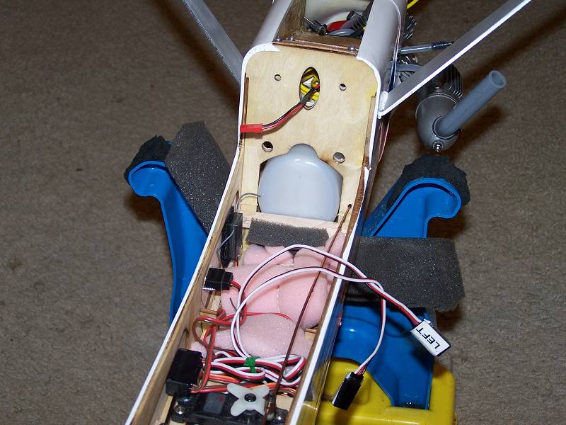

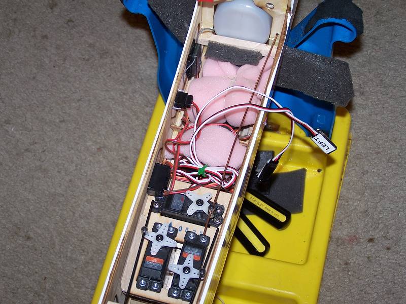

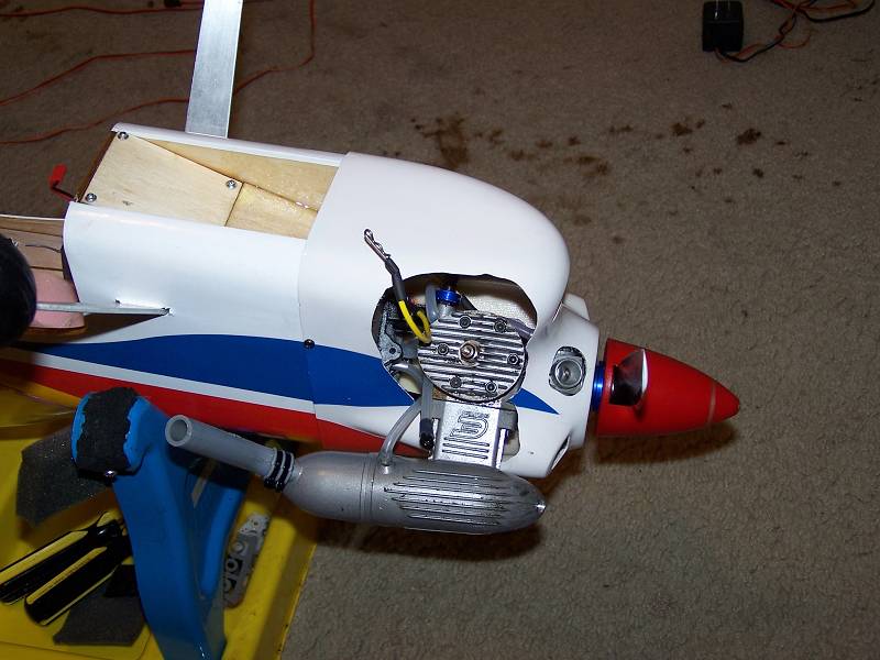

Does anyone have any pics of the Fashion 50? I trying to get and idea about how i should mount this .61 engine or any suggestions/ I was going to mount head right!

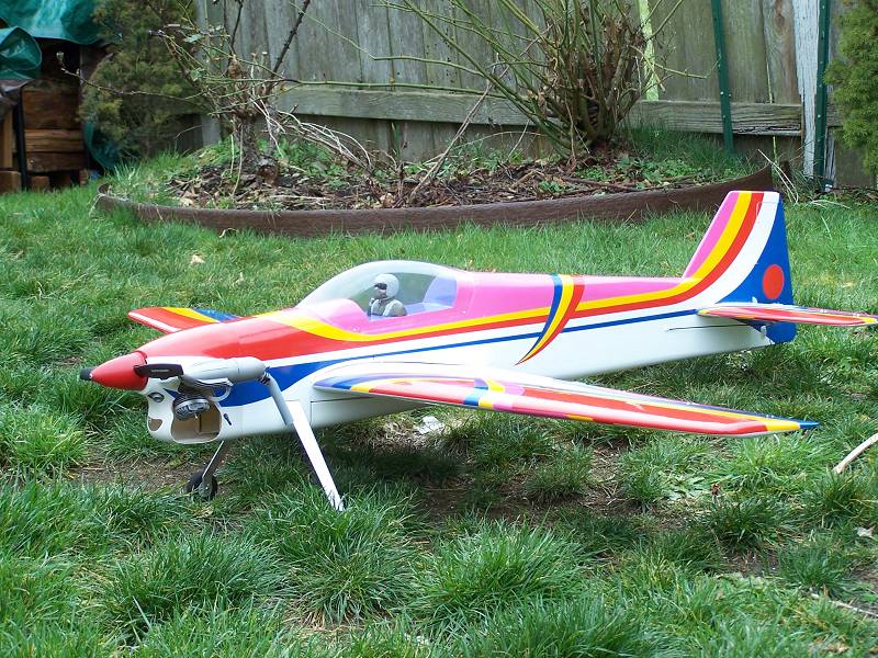

Here are a few picture of my Fashion 50!!
jet22b
