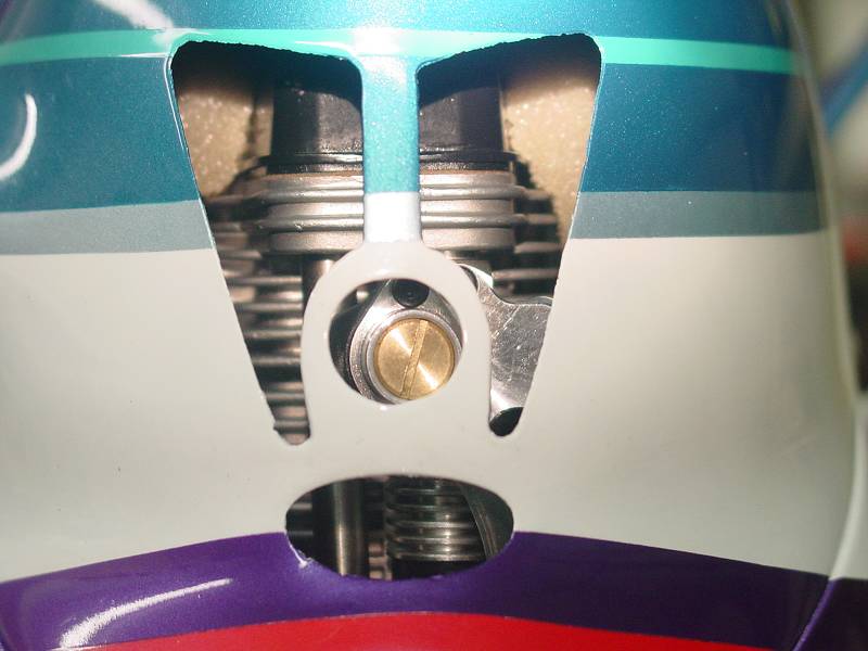

I do not know the temperature of the engine but it certainly does not seem hot at all, actually seems cooler than glow plug. I even set the needle too lean and flew it that way trying to find the perfect setting. Because it it does not set like a glow engine, it does not sag and overheat when too lean, just looses some power. It has shown no signs of overheating. I am runnng only 3/4 open on the high speed needle.
Fuel economy is unreal, I burned more fuel in the 1980's patterns with a YS60 SS than I do now.
I do have the engine baffled now that was not shown in the first picture, I use the YS shipping foam to baffle the engine. Tack glued to the fuse and case of the engine. This needs to be done on all YS installations, really helps in the hotter weather.
Bill
