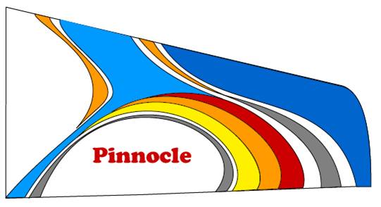

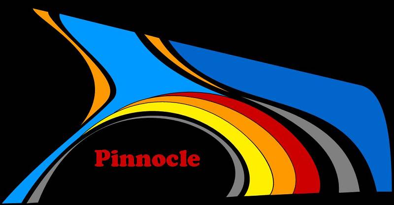

I always use Corel Draw and export the vector graphics for cutting the whole color sheme in making tape...

ORIGINAL: RainerSeubert
Thanks to all. This is going to be fun. Rainer, can you tell us more about using the vector graphics? Can it be used on the compound curves of the fuselage?

Hi Rainer,
What machine do you use to cut the masking tape? Are you buying masking tape in a big flat sheet?
Cheers
Jason.

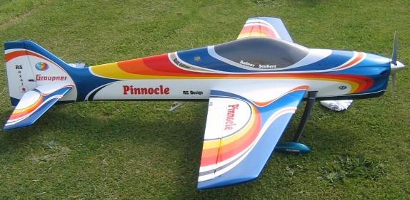

Yes, we use a simple vinyl cutter and the masking film comes from a roll ...
When you have cut the design of e.g. one wing upper side, add a transfer ribbon on top, remove the liner and cover the complete wing with the masking film. Start at the trailing edge, some more hands are really helpful ...
Remove the transfer ribbon and then u can remove the masking film color by color. Don't discard the film you remove, you need it again, you must cover the finished part again before you start with the next color!
I will use the same procedure for my next molded wing, that should be much easier, you do not have to cover the finished parts again, because you are brushing from behind!
For the fuselage I cut only templates for the curved parts of the design and use a simple tape for the straight lines ...
It's ****y work, but the result looks great !!!
Rainer Seubert
