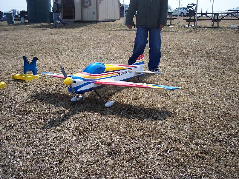

I got the new carbon gear from Hobby City. They are great quality,very light and a little taller than the stock gear. The plane balanced at about 125mm from the LE, 8mm behind the "ideal CG" in the manual. These things are usually conservative so I decided to fly it as is. The total weight was 5lbs 5.5oz. This after saving at least 7oz so AB models is way off in the weight estimate. Still, that's not too bad for 538sq ins.
We had great weather today (for Canada...12C and 10mph winds in March!!) so we headed out for the test flight.
Even at the relatively aft CG the plane tended to nose over on take off roll. The soggy ground and small wheels and increased sweep back of the new gear did'nt help, but the take off roll was straight and climb out very positve and needed little to no rudder. A click or two of down elevator, left aileron and rudder and it was trimmed. Not bad for an AFR that had a few "straighness" issues.
I dont think the CG is too aft at this location but it is pretty neutral...maybe a bit too much so. 117mm from the LE may really be better.
With no mixing, KE flight with left rudder is just about perfect though it pitched to the top a little with right rudder. Downlines are straight with only a slight pull out. Uplines require a little left rudder....I think the right wing is heavy or it's got too much right thrust for my liking. Inverted needs just a little push. The plane slows nicely for landings but you run out of elevator control as it slows. I think the stab is undersized.
With a 12-5 on the OS50 the plane has to be flown fast or you run out of vertical, engine screams like crazy even though it's rich (I should have tacked it). We'll try a 12-6 tomorrow.
Generally I think there's lots of potential for pratice up to advanced but it will need more grunt or will have to be flown fast. We'll experiment with props until we get the best performance.
We put 4 flights on it today. My son (10) flew all but the trim flight and is thrilled with his first Pattern plane.

Final update....
The carbon gear from Hoby City was swept back a bit too far and made take offs and landing on tall grass difficult as the plane would usually nose over. I found the perfect replacement in the3DHobbyshop 55" Edge gear. It's even lighter than the hobby city gear.
The performance with the 12-6 was not very good either so we went back to 12-5. I think we originally ran the engine too lean so this time it was set just 3-4 clicks in from very rich (4-cycling) and tached at 12.2K. At that setting the plane has very good vertical performance, slow downlines and good speed.
I took a little right thrust out and added 5gms to the left wing. Uplines are now very straight, loops need almost no rudder.
Rolling is very axial with 0 differential, snaps are super fast but are bit too deep....we are going to reduce the aileron and elevator to fix that.
The overall performance is exceptional for a 50 size pattern plane.
