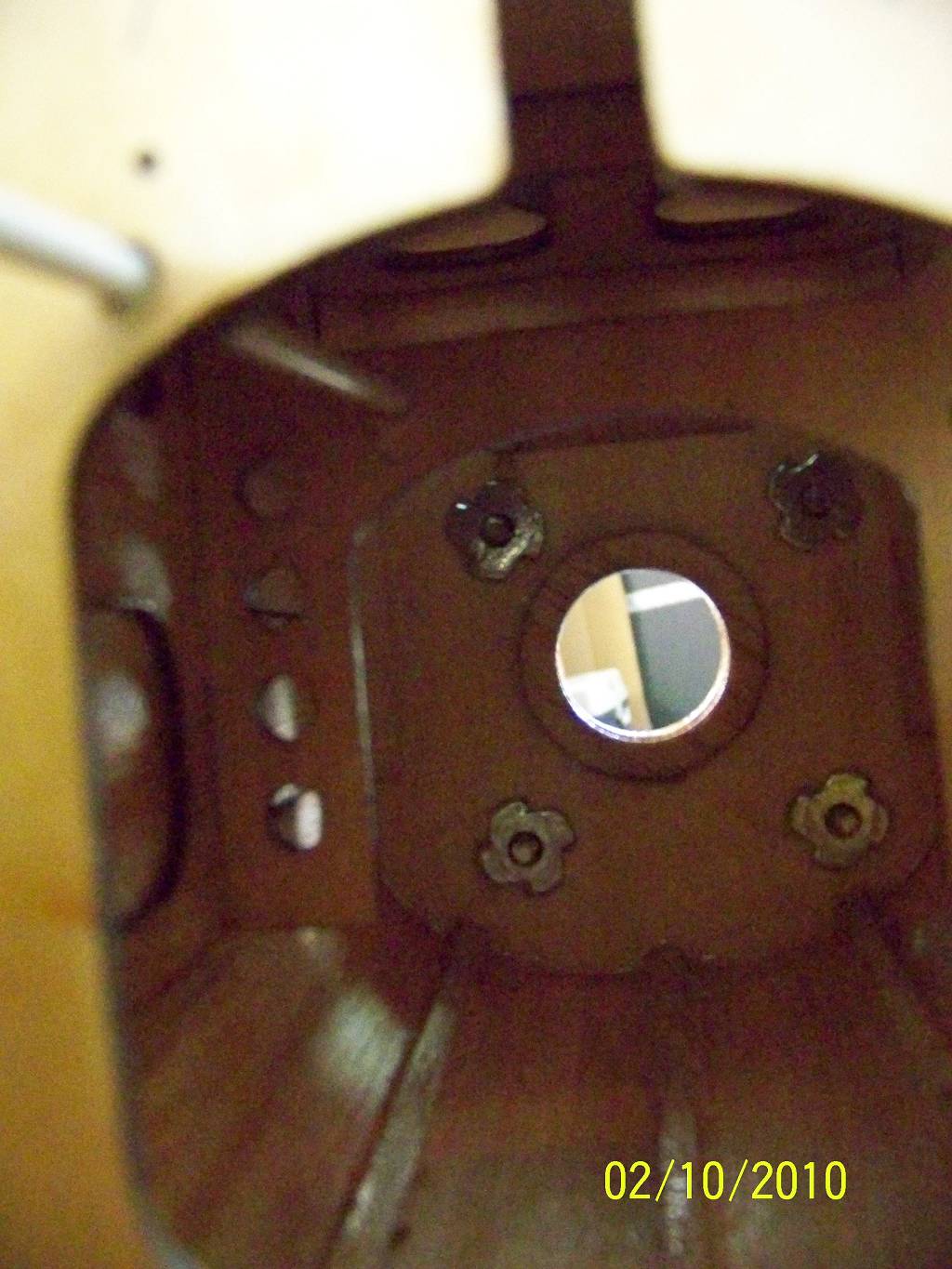

I have been building my Spot On for a month. The weather has been awful here in Virginia, with all this "global warming" I haven't been in a hurry to finish it.
Here is a list of what I have done and modifications.
I just bought the Spot On in Jan 2010 and when I got it home it was the original not the newer version???? I was going to return it but after checking it I found that all the covering was perfect and al the wings and fuselage were perfectly straight. So I kept it
1. Like all my ARF's, I epoxy (30 min) the inside of the nose around the firewall. They sometimes just hot glue this??? Then I thin epoxy with alcohol and paint the entire section from the fire wall to the cockpit bulkhead. This strenghtens and fuel proofs the area. I also paint the outside of the firewall and the edges to seal it and the covering edges. I then paint all the stringer joints and around the edges of all the landing gear and all the support structures servo trays etc. For god measure I spray the inside of the nose with fuel proofing clear coat. I tend to have my models for a long time and feel that the little added weight is better than having everything get fuel soaked over 200 -300 flights. I have several planes that have over 500 flights.
2. Then I reinforced the wood area around the landing gear base with triangle balsa strips & epoxy. This makes it much stronger so it won't break out on a so, so landing. I realize that a hard landing will tear up the fuselage but that's why we practice landings.

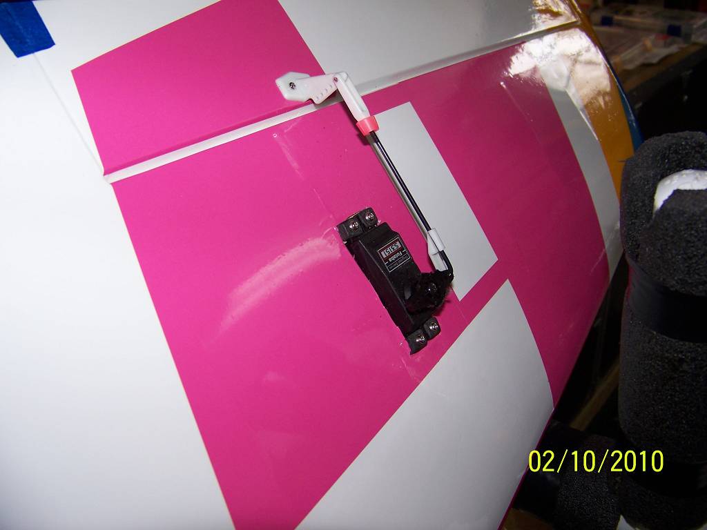

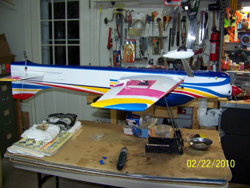

Here are some more building pictures.
The extra pushrod tube was for the antenna but I had too much interference from the pull/pull and elevator rods so I had to put the antenna on top of the fuselage.
The O.S. 55 with pitts required minimum cowl cutting.
I used the Dubro pull/pull vs. the cheap hardware supplied.
This is the original version with the aileron servos exposed.
I also epoxy paint the inside of the cowl and wheel pants for strength.
I used a 2/20 blind nut and hex screw to secure the wheel pants.
