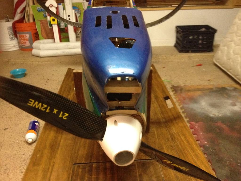

Here are some pics of the nose area. The chin is removable via an MK magic box. The batteries are held in place with just velcro strip and a strap on lite ply right behind the motor. You can see the big (understatement) ESC just mounted to some of the lite ply structure. The motor is performing very nice and is front mounted with a rear bearing support. Currently running a 22x12wide making about 2600+watts.

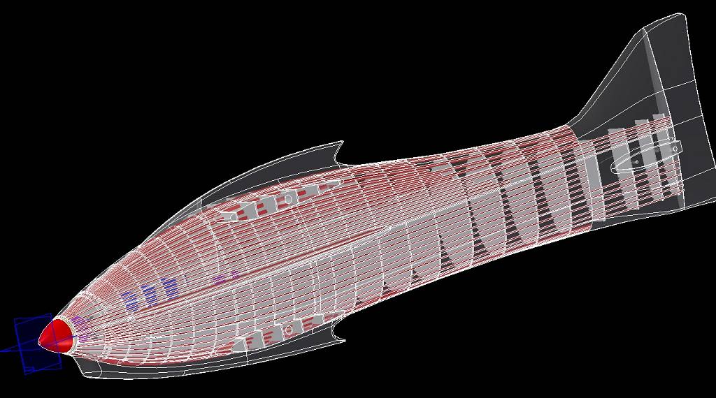

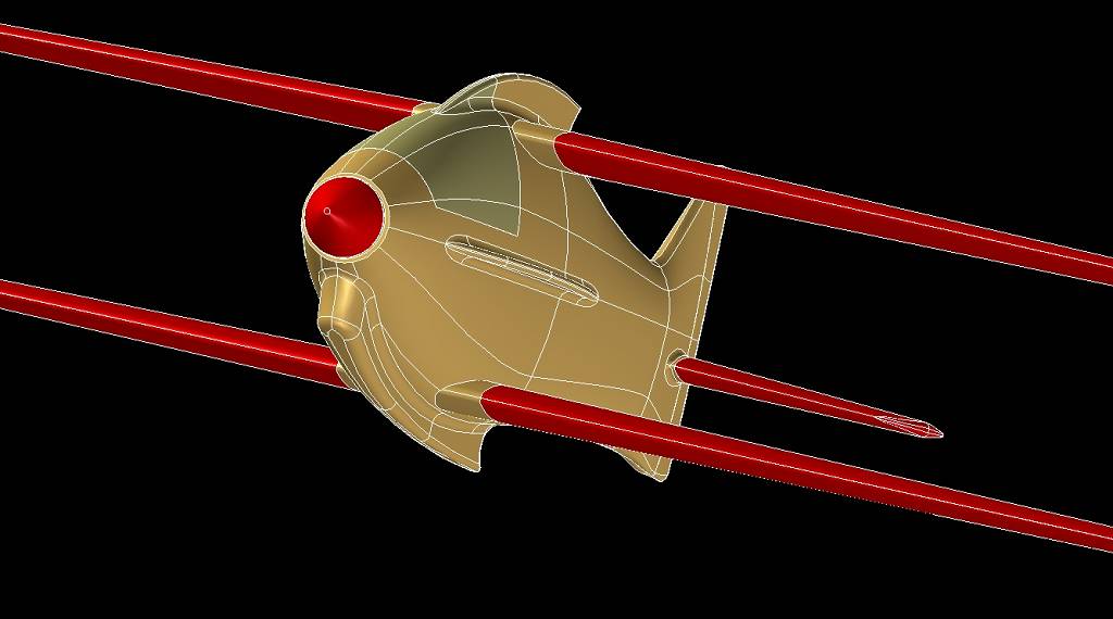

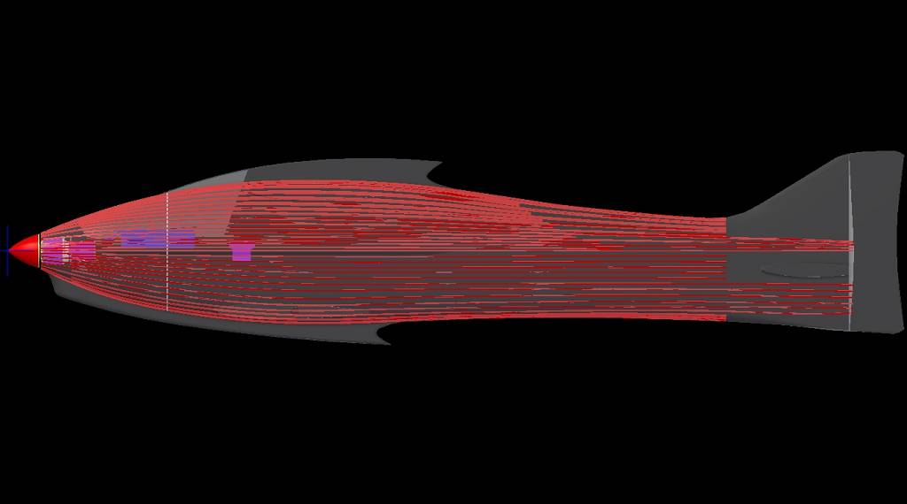

OK, Fat cat outta the bag. Please, understand that the biggest surprises lie beneath the surface and what you see is only a solid works model of the initial concepts.

Jesus Chuck! The fuse looks like a fish...
Looks like a very symetrical design.

All built up, wing tubes top and bottom wing, adjusters for the wings to fine tune incedence, goal of no flying struts.
Considering a gear setup similiar to the Geebee r3.
Very Retro... definite build thread once we get going.
Jason, funny you should mention fish, the plane is called the Remora.

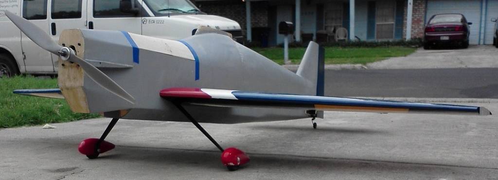

Here is the most recent project, really a frankenstein setup. I was wanting to try swept wings again, had a fuse that was originally for a bipe but got frustrated in how to mount the top wing...it sat for four years and so I mated the two projects.
Ala.... Sting Ray
It has one flight, faulty elevator extension on one half and had to abort testing.
Enjoy.
