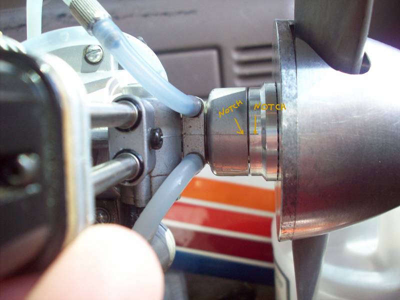

I also set the timing of the cam by lining the mark on the drive washer to the body and the dimple of the cam upwards.

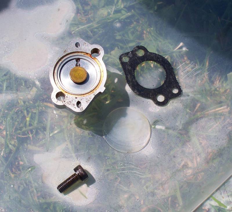

When first starting it up, fuel was leaking out of the regulator. Pulled it apart and I think the diaphram was not seated in right so I turned the regulator screw out about 5 turns from where it was so the diaphram would sit in there when putting it back in. Turned the regulator screw back in 5 turns. I took pics of how I placed the diaphram when installing (gasket goes on case side, clear diaphram goes on regulator side in the recess).
My initial problem was that fuel was not comming into the carb. I had to turn the regulator screw out a couple turns, then all the sudden, fuel would move. It started to move out of the regulator to the carb as I backe out the regulator screw 2-3 turns from it's original position.

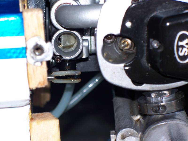

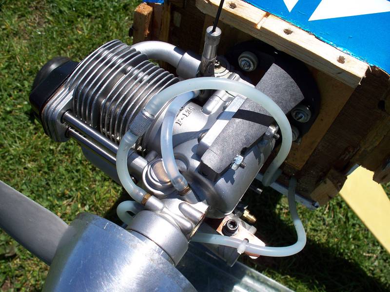

I took pics showing the order that I place the gaskets as well as the plumbing of the fuel lines.
One thing I'm not clear on by the exploded parts diagram on the central hobbies website. # 73 the Regulator Balast. I don't see that on my engine.
Either my buddy took it off and lost it, It was removed and lost back in 1998 the first time it was reworked or it never had it.
I did nothing to clear out the tubes that go through the regulator body #46 and I'm wonding if I should pull that apart and maybe clean any gunk I find on it. Should I take that apart and then blow compressed air though the holse to clear it out or soak it in something?

Additional information. The photo that shows the plumbing of the lines to the tank, the line that has the aluminum check valve on it goes to the top of the tank. The other line is going to the clunk. I'm wondering if that is even hooked up to the right nipples on the engine?
RE: YS 120 not running right after rebuild
dditch,
Yes, the hoses are correctly installed, and the engine is quiting due to lack of fuel, it is highly possible you have the engine internal fuel passages clogged, you will have to disassemble the engine completely and flush it, use alcohol, for extreme gum I use paint thinner (the paint thinner will dissolve the gum and all parts made of silicon like the regulator diaphragm so be carefull), and then try to blow all passages with compressed air.
After all that is done, you need to change all the seals, you show only the diaphragm side of the regulator, but the poppet valve (plunger) might be stuck or worn on the adjuster screw side, you need to take this apart also to clean it, get a new diaphragm, it looks in your picture like it is dented or marked on one edge, and if it leaked fuel I assume is because of this, the plunger and diaphragm are cheap so get new ones it might save you a lot of time, also, you need to change the O rings on the rocker arm push rods tubes.
The regulator should be flush with the housing after you reassemble the engine, do you have the engine manual? if not I'll email it to you.

I started it up this morning after finding that the regulator housing was on backwards (tab was to the rear). I re-assmbled it with the regulator on correctly (tab towards prop). Started it up and same thing. I looked closer and there is air bubbles comming from the regulator to the carb. The silicone tubes were changed everywhere except to the tank where I took 1/4" off the tubes and pressure tested them. I see NO air comming into the regulator, just out from the regulator to the carb. I'll take apart the regulator again to see what is going on.
The gasket, diaphram and the O-Rin in the regulator were all replaced. I did a complete gasket and O-ring replacement on the engine when I did the bearings.
Something is letting air get in.

Hmm, just finished taking it back apart, now I see what you meant about the diaphram. That was a new diaphram but since I originally installed it incorrectly, it left a crease on it where it was being pinched. In a semicircle but a pretty big dent on the ends of the creases. The design leaves no room for error the way that the diaphram seal is on the edge and if the seal is not good, air comes in from the outside. I like how my Walbro carb is on my Gas engine. The diaphram IS the gasket. Much easier to install.
I'll have to buy a new one (or two) and try again. I hope that's it.

Make sure you have the timing set proper on the engine. Look in the back plate of the engine and you will see the dot on the crank by the bearing journel. Line that up with the center seem of the engine then look at the cam gear and make sure the dot on the cam is to the top. Make sure the engine and gaskets are all back together right and then reset all needles. The high end needle should be 2 turns out and the low in needle should be 1.5 turns out from closed. The regulator screw should be flush with the regulator housing. Start the engine and let it warm up before going to full throttle. Once you get to full throttle adjust the top end to peak RPM and then back it off to a slite rich setting. Once the high end is adjusted start lowering the throttle to an idle till you get to around 2000 RPM. Let the engine sit there and listen and if the engine speeds up at idle then screw in the idle about a 1/4 turn at a time till you get the idle to hold. If the engine gets to 2000 RPMs and then starts to slow and want to quit running the turn the idle screw counterclockwise to lean it some and about a 1/4 turn at the time till it's right. Each time you make an adjustment go to full throttle and then back down. If you go to full throttle and the engine sounds like it's straining or if you know what predetination sound like you need to richen the regulator by turning it out. That gives it more fuel and if it's spitting and sputtering going up to full throttle then screw the reg. screw in to lean. Once you have the engine where it will idle ok and also transition good then you can go back to the idle and fine tune it some more. I hope this helps and once this thing is set you can forget it. Remeber the regulator screw controls the transition, in for lean and out for rich.

I set the cam timing based on the notch on the prop washer(drive washer) and the dot on the cam already. That's what it said to do in a manual I downloaded.

No joy.
I fired it up today at lunch.
First attempt was the same, but then I saw that I AGAIN allowed the diaphram to twist out on installation.
Pulled out diaphram #2 and installed being even more careful this time.
Installed and fired it up.
No air between the regulator and carb this time so looks like problem solved.
There was LOTS of fuel comming out of the muffler but I think that was from when my diaphram was installed wrong since it stopped later on.
But I still have the same problem, I get up to half throttle and it dies suddenly. No girgle, no spudder, dies.
I tried turning the regulator out a turn or two as well as opening the needle to 3 turns but still no luck.
If I turn past 3 turns on the needle, the o-ring seems to show.
Pictured is how I set the timing. Dot on the cam is straight up and the two notches are aligned. I pulled off the cam cover to verify this (put a sharpie mark on the opposite side of the dot since the lifter covers the dot right now.
What else should I look at?

I flushed out the carb w/ fuel and tried again.
still the same.
I used byron 30% heli fuel.
I also wondered if I put the throttle arm on right. So I loosened it and rotated it 180 degrees and tried agian. same thing if not worse.
Here is a photo of about idle to 1/4 throttle
Is this right or should I rotate it 180 degrees back where it was?
still the same.
