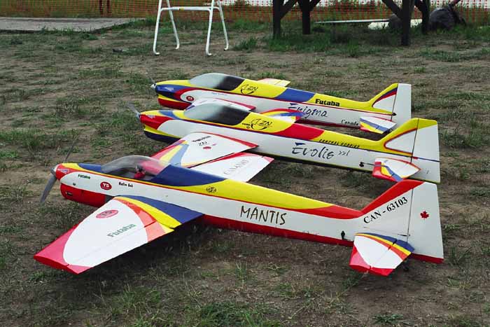

Default Help A Biginner Out - Engines on a 2M pattern plane
Steve,
OS140RX is fine for your setup.
All you need to see the engine running again and practice.
It will be just fine.
As a second engine you can go with OS160FX and a wrap around header!
Of course we use YS140DZ but for the planes below.
