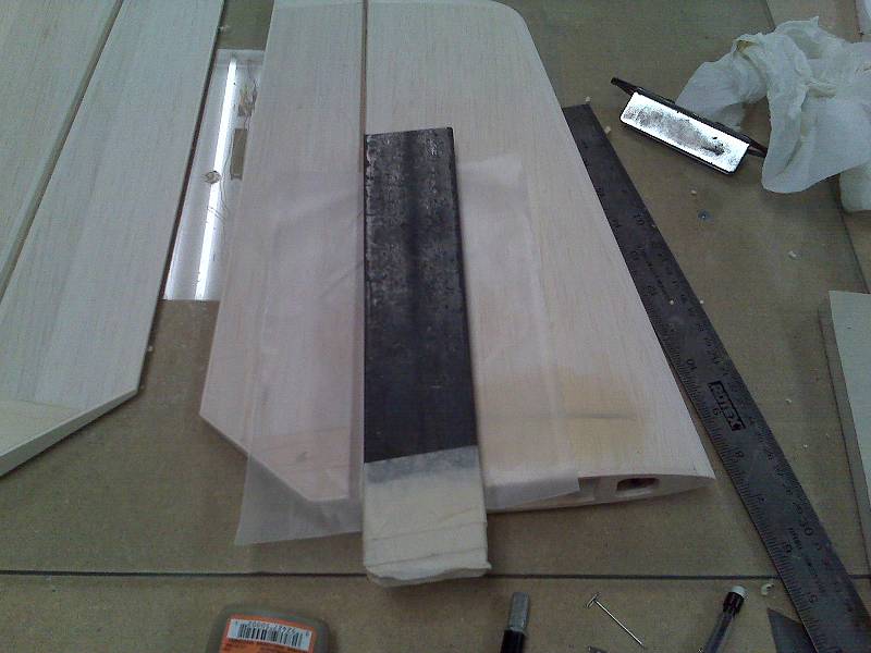

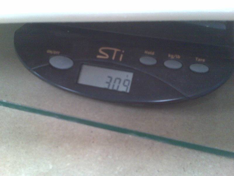

Basically thats it for the wings, all thats left to do at this point is shape the LE and wing tip to match the airfoil.
Here is a picture of the finished ready to cover wing, as well as the weight.
A little more woodwork to do to the stab which I will post up tomorrow and then its into covering.

Hey Chad,
How do you get a nice even and accurate bevel all along the aileron and wing? I find I can get it close but not as good as I would prefer.
Hi Chris
No magic, just take your time is all. I set my planer to remove as little wood as possible and use lots of new blades, then I just slowly plane away until I am close to my center mark and top mark (tape, pencil, whatever works). Then a long aluminum sanding bar with 120 grit to make the surface uniform.
Its a painfully slow process, to do all 4 wings and stabs took a few evenings.
Chad, what's the reason for double-beveling? For twice the work.....I'm sure there is a benifit.
Also, what did you use to cap the TEs.
Last one. I have never used the Ploy glue you refer to...is it a better alternative to Aliphatic resin for caps and epoxy for stuff like hard-points?
Reason for double bevel is two-fold, a) it leaves as much of the capping intact as possible. Since there is no spar, the cap takes load, so the more of it there is the stiffer the wing. b) it just looks better when its all done. Although the total bevel is the same, there is an optical illusion that a double bevel seems to not leave as much gap.
TE's are capped with 1/16" balsa
I did some checks on the poly-u glue to see how far it penetrated the foam, ZN uses a pretty open cell foam and that stuff goes about 1" into the foam, so that capping is really on there. When I cut out the stab root cap a huge amount of foam came with it. I have never been able to generate that kind of bond with any other glue.

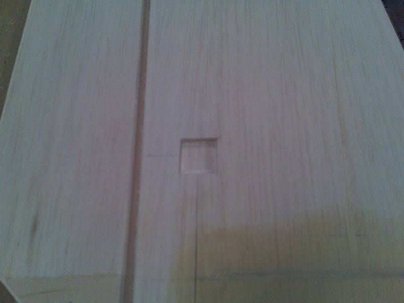

The stab has one more small bit to do, and that is for the hardpoint for the tube bolt.
Again using the milling attachment and bit, mill out a square hole to fit the 1/8" lite ply hard point that is included with the kit. Take a bit of time to locate it so that its going to be in the right spot for the bolt to hit the tube!
Once the spot it milled out then use some poly-u glue to glue in the hard point, and place some weight on it to hold it in place as flush as possible.
Once its setup you can drill the hole and counterbore into the hardpoint. You can at this time place the stab to the fuse and drill and tap the stab tube as well.

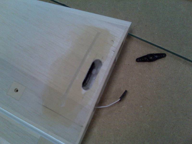

We are nearly ready to cover.
I do this part a little different maybe than most. What I do at this point is actually glue the hinges in, and then use white covering and gap seal top and bottom prior to covering.
On the ailerons you should also cover the inboard root of the aileron before hinging.
I only took a shot of the stab with the elevator hinged and covered.
Once that is done, you need to figure out where the slot for your elevator pushrod will go. I did this after hinging so that I had the elevator location and travel fixed.

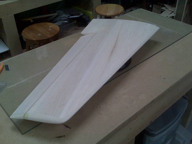

So before covering, you need to fill all the dimples, holes etc. and sand.
I start at 120, then 180, then 220, then 400, then 600. Then carefully clean it off with compressed air and try to avoid hitting anything with the parts
I am lucky enough to have access to plotters at work. So I create the covering scheme fullsize to match the wing/stab surface size in AutoCAD. I then plot that full size, use spray glue to stick it to bristle board or similar and cut out each of the pieces. Take care to figure out where the overlaps need to be, I make them about 2mm.
The best for cutting is on glass, it works so much better than on a wooden surface. For the really thin stripes, you want to peel off the backing of the covering and spritz some water on the glass then place the covering down and squeegee out the water so it sticks while cutting.
I didn't take many pictures of covering.
