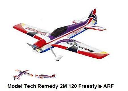

I previously asked here what would be a good ARF pattern plane for around $300 - $500 dollars and got some really good suggestions. THANKS!!
I plan on ordering a pattern plane next week for sure. Based on the recommendations I think I'll go with either of these planes:
The [link=http://www.hobbypeople.net/gallery/123749.asp]Model Tech Remedy 2M 120 Freestyle ARF[/link] at around $350
the [link=http://www.modelflight.com.au/sebart/sebart_angel_50.htm]SebArt Angel S Evo 50E[/link] at about the same price with shipping from the uk.
I'd appreciate any comments on which would be a better choice and why. I realize the Remedy is a 2M plane but the SebArt seems to be a better plane overall - just my impression.
I plan on making whichever one I choose an electric. Would they be comparable in price when doing so?
Thanks in advance.

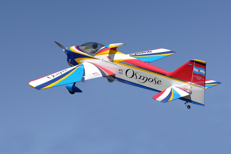

I just got a Koyosho Osmose 70 but not flown it yet..I'm new to "modern" pattern aircraft and have very little "expertise" to pass along..

Both are smaller planes but apparently fly very well..I have read they fly like a 2m ship..The Osmose is noticeably bigger than the Oxalys and has allot of fuselage side area...I'm looking forward to flying that one for sure..

It's not the 2-meter, both the picture and the link show the 50-size version. The 50-size Angel is a little bit bigger than the Kyosho Osmose and Oxalys and is lighter and better suited for electrics with top hatch for battery change etc.
The Modeltech 120 is a lot heavier and will cost you double to power it properly. With the Angel, go with the recommended Hacker setup which is plug and play but make sure you use a 6S Battery, 5S is not enough for F3A manouvers with that size plane.
