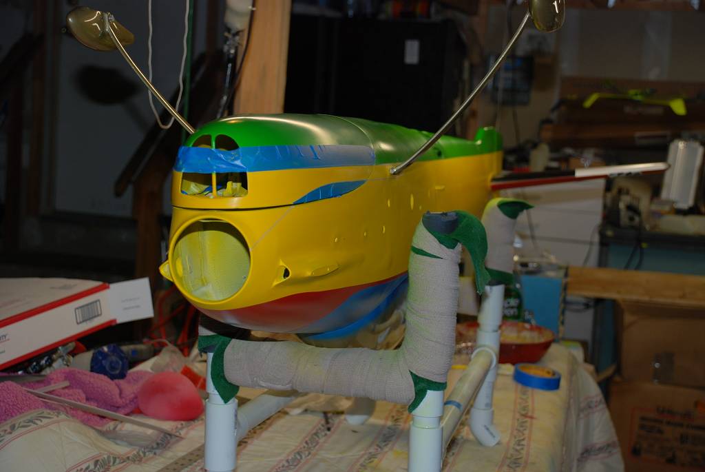

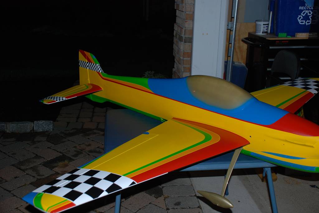

Not exactly SAP 180 HP related but the engine will go into this plane. Nearly all the base colors are finally applied

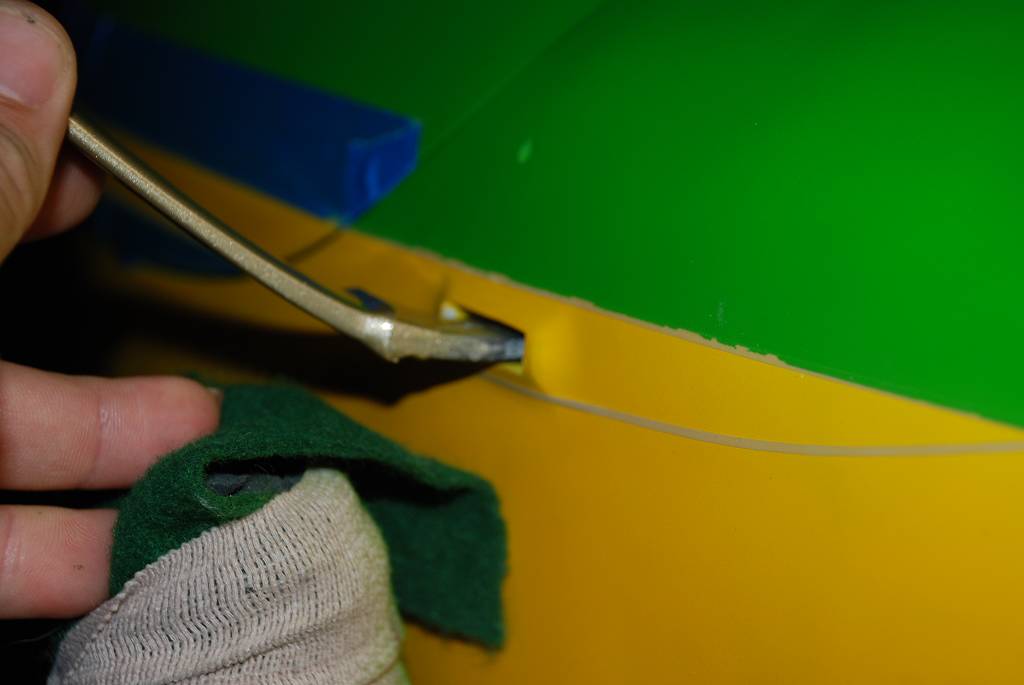

The gear is installed in similar fashion to that used on WistModel planes. I added a more secure socket set-up that each gear plugs into. Each gear is bolted down on the opposite side with a single 4-40 bolt just to keep the gear from coming out laterally. The sockets and gear flexing do the rest. Sockets may be lined with rubber during the construction to greatly reduce noise
The cannards are there for show (BG)

WOW! I can't wait to see it fly![sm=thumbup.gif]
Any projections on the AUW?

Bob,
I have final trim, lettering and pin striping yet to apply and then the clear. I expect to pick up about another 5-6 ozs or so which will bring weight to 5# 6 give or take. Equipment is pretty close to 5 lbs so probably around 10 # 6, maybe a little more.
The plane is considerably bigger than Temptress, much wider and deeper fuse. Wing is a little larger too. I should be able to see this scheme better than I can see Temptress. Temptress almost disappears in overcast sky...too much white.
The large cheks on the bottom should be better visual ques as should the top ckecked areas on the tips. At my age I need all the help I can get in terms of visibility.
Temptress told me why I couldn't draw a straight line the past month. The left aileron servo finally went...almost wrecked the plane in the process. I was very lucky only suffering canopy and rudder scratches and slight cracks. Oh, the plane flipped on it's right wing tip landing on its back when the left aileron went full down uncommanded. This on the TO roll. Very lucky to have the plane

Hey Matt,,
Nice work , like always
I like the forward canards are those cheekcowelizers?
did you use slikspan and dope, or glass and auto paints?

Bryan, thanks,
Silkspan and nitrate dope to do initial sealing/bedding then KlassKote epoxy paints to fill and primer stage. I keep trying to come up with a simpler way to bed and prep but no matter how you slice it, it's a lot of elbow grease
Paints are Stits vinyl base one part uncatalyzed. Similar to dope in consistency, pigment content and application. The yellow doesn't cover worth a damn unfortunately. But all the other colors were much much better. Clear coat will be Omni 2 part Poly U.
BTW- Stits are full scale paints designed to be gasoline proof. FM Enterprizes (Grand Prairie, TX) has formulas for both Full Scale and Models. They charge the same for the full scale (more concentrated) and model (premixed with correct amount of solvent). I bought the full sclae type and a gallon of thinner. I premixed about 8 colors and stored them in water bottles. Works fine.
Overall weight build up is reasonable for a plane this large. Wanted less than 5 lbs but didn't quite make it
Oh, one thing of interest to all who paint, Stits offers something called FC900 which is their filler/primer paint. I really liked this material. Easy to spray, quick drying and sands to feather edges extremely easily and fast. May be sprayed with Stits top coat or Poly U and allows very smooth flow out

OH YEAH BABE!!!! OR CHEEKAs FOR SHORT??
If they don't work, they are removable. One of these days I just might build that egg crate for the prop slip stream

I have a general weight gain, not after each step. Let's talk wing panels.....area is 525 sq inches; each panel complete with socket and servo mount in place before any covering but including aileron was 245-250 grams (just <9ozs). I fitted the panels to the fuse and built a fillet at the joint, adding another 1/4 oz. So each panel before covering was 9 1/4 ozs.
At this stage of finish, with no clear coat or lettering, my panels are 12 1/2 ozs. Add maybe another ounce for clear and lettering, and final weight should be around 13 1/2 ozs.
A monokoted panel would have been around 12-12 1/2 ozs finished and ready for equipment.
I picked up unnecessary weight in the yellow paint...it took 6 coats to hide almost everything and it is still not as solid as I would like. A different color would need 2 coats and much less weight. BTW- initially I used yellow KlassKote original formula and that didn't hide either and weighed even more than Stits. I sanded it all off and started over.
KlassKote new yellow formula hides similar to KB according to Ed Alt who used the stuff. I wish I had known in time. Lots and lots of unnecessary work.
To answer the question, I believe the method can produce as light if not slightly lighter weight gain than monokote. But have got to have good, solid pigment, opaque paints.
