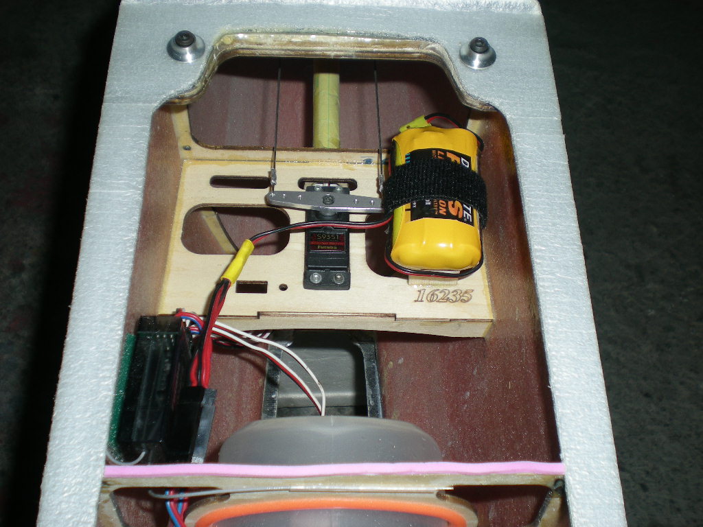

Hi Amram
I'm flying my Axiome with the CDI, an two separate batteries, here is hoy the setup ended, (pictures later)
CDI unit is about 2 inches from the firewall, CDI regulator ( duralite ) and CDI Switch, about the same place, receiver battery (duralite 2.150mah) in ons side of the rudder servo, CDI Battery, (lipo 950mah) on the CG
I started with the CG where Oxai recomends, but I had to move it back
weigth of the plane is 4.950g
Regards

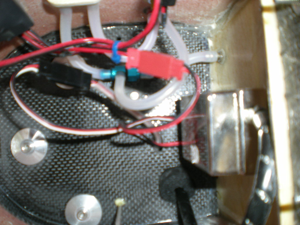

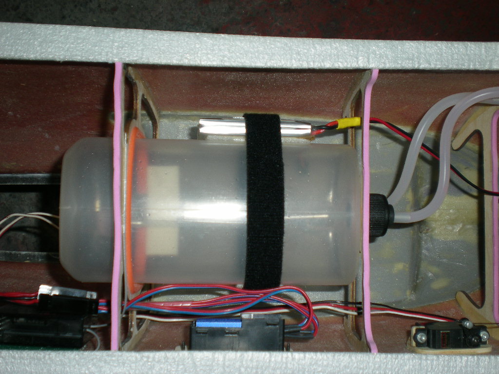

Old 03-28-2010 | 01:39 PM
Joined: May 2005
Posts: 615
From: caracas, VENEZUELA
Default RE: Axiome (Oxai) CG
hello Amram!
here are the pictures, hope they help.

Old 03-28-2010 | 01:48 PM
Joined: May 2005
Posts: 615
according to Oxai, the cg is 190mm from the leading edge, mine ended up behind that
best regards.
TUNY

Hi Tuny,
thank you very much for the pictures.
I see on your model PowerBox Sensor double Digiswitch which is two independents switches and regulators ( I am planning to use same)
However, I see another small switch on the other side. Make I ask why do you need 3 switches?
Regards
Amram

Old 03-29-2010 | 08:38 AM
Joined: May 2005
Posts: 615
Hi Amram
I use the powerbox switch for the receiver, I like redundancy, one battery with two plugs and the energy goes to the receiver from two independent systems, the smaller switch is for the CDI with a separate voltage regulator. I know is not necesary but it gives me peace of mind...
Best regards.
TUNY
pd: that header tank idea is brilliant!!!!
Old 04-02-2010 | 10:39 AM
amram's Avatar
Joined: Sep 2003
Posts: 358
From: Holon, ISRAEL
Well,
It came out with all accessories at place exactly 190mm of the Wings LE.
This with PowerBox Double sensor switch and 2 x LiPO 1320MAH Bat
Located under the Canalize (Can be changed by removing the Canalize)
APC 19X11 prop, and CDI unit just behind the Firewall.
This will allow me to work 190mm of the LE and move it backwards by moving
The CDI unit backwards if needed. The total weight ready for lift-off is 4920.
I hope this will work fine.
Thank to all helpers….
Amram
