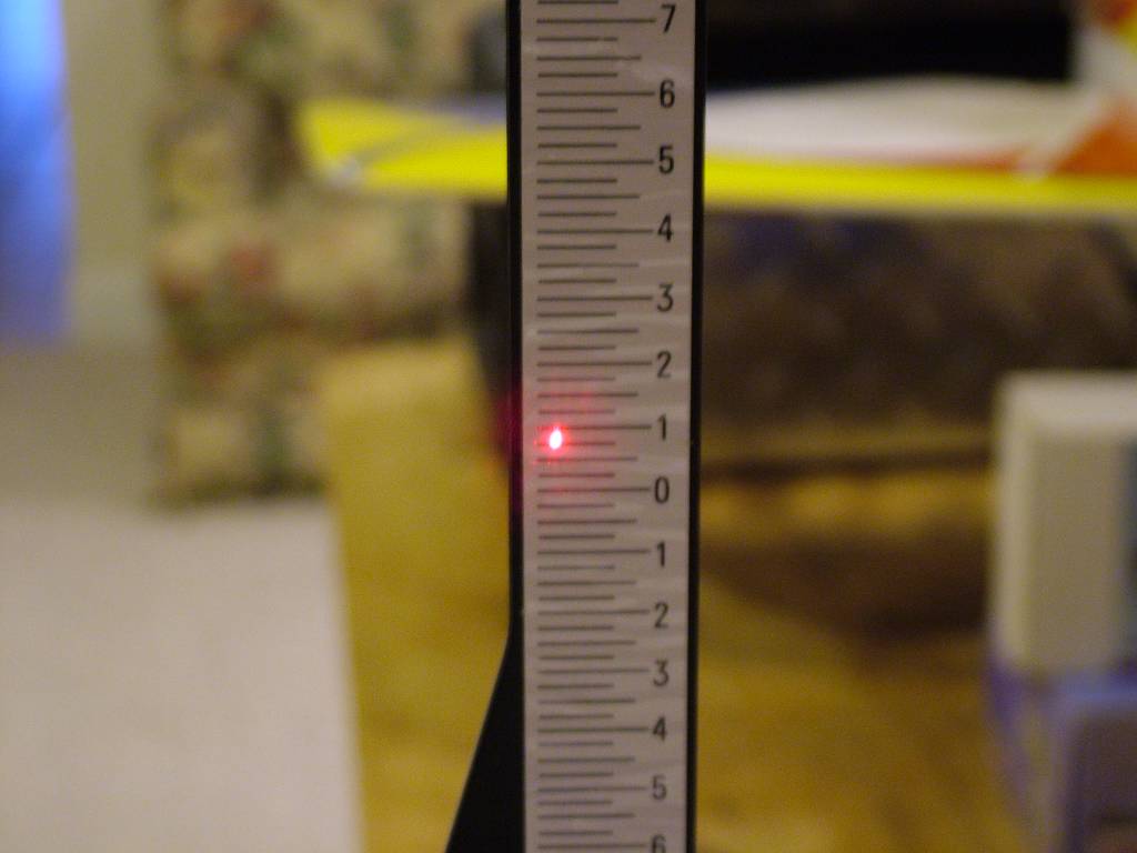

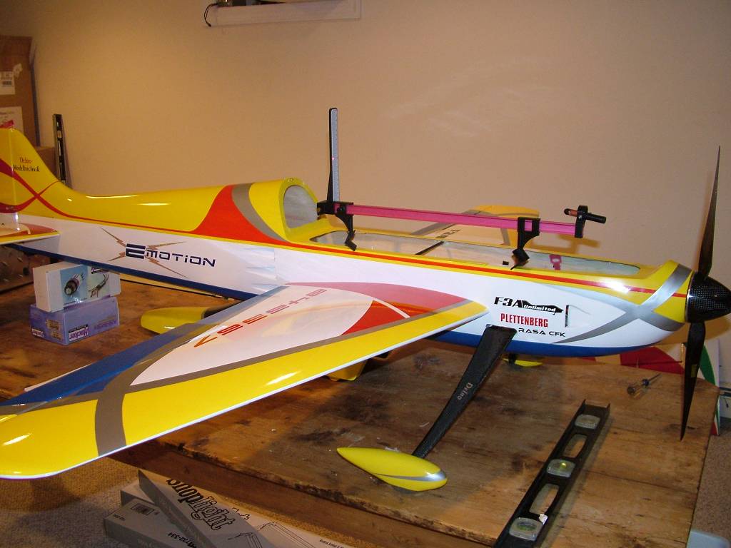

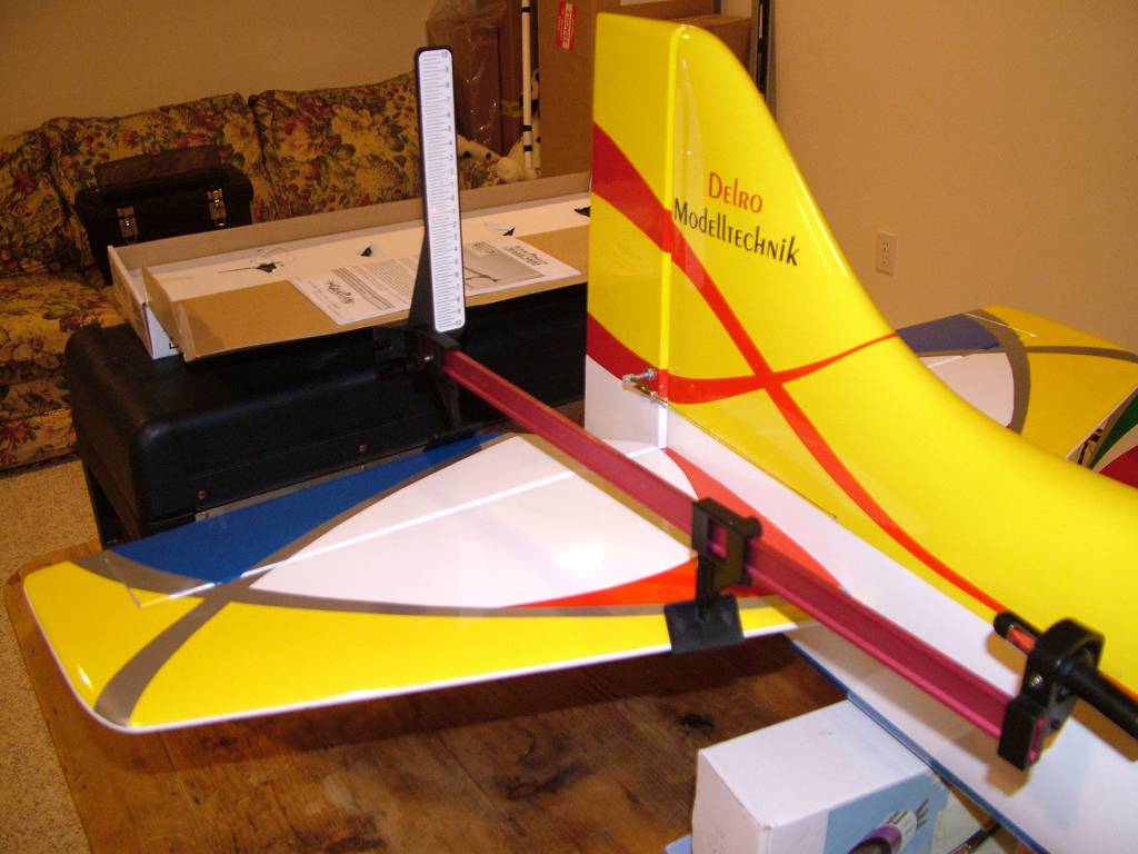

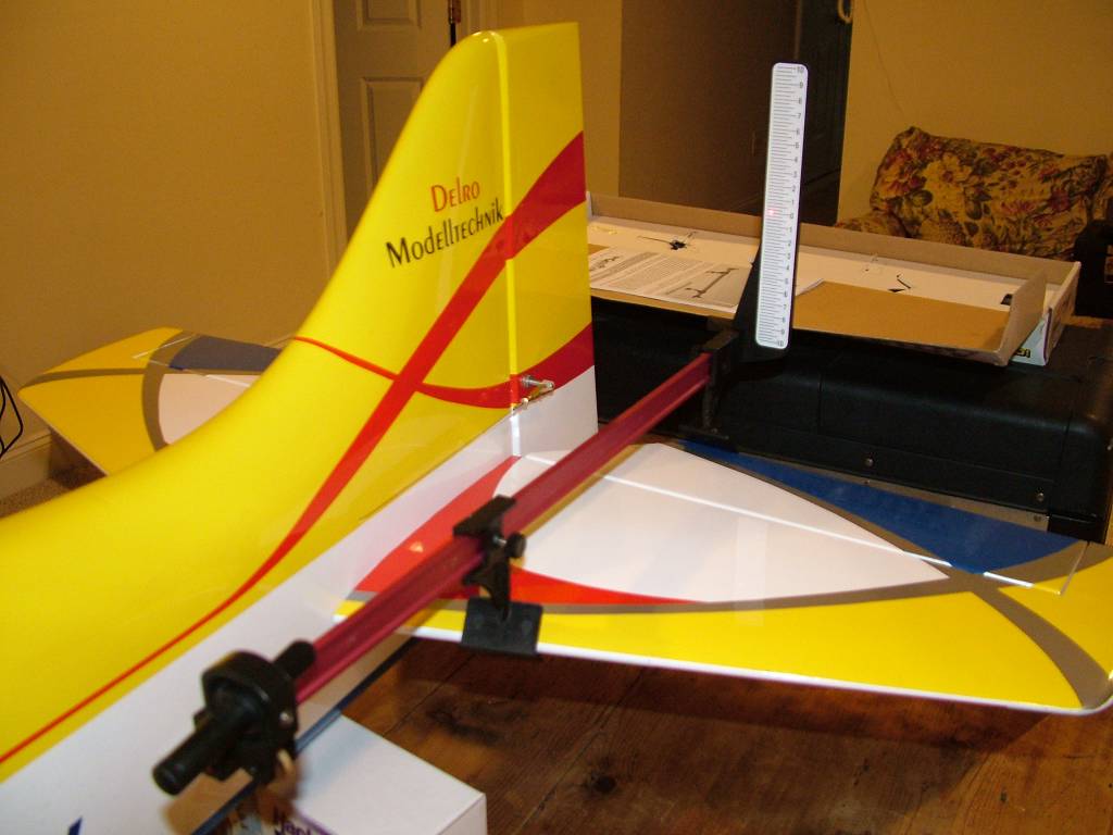

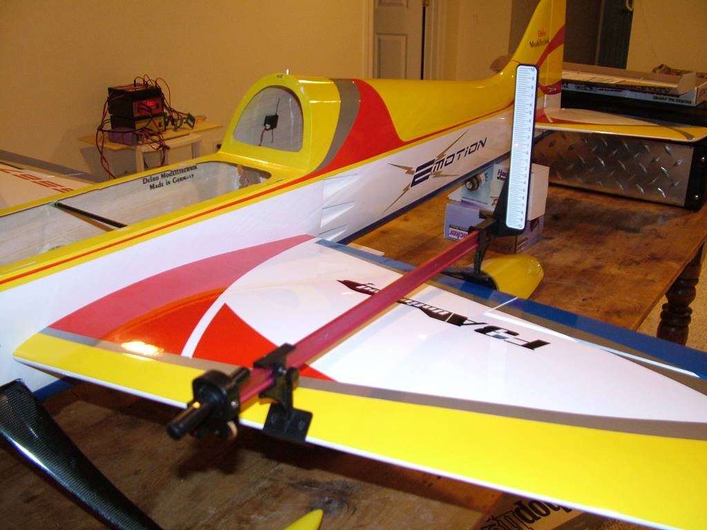

So I went to work today on adjusting the wing incidence on my Delro E-Motion because it was needing a couple degrees of up elevator for level flight and I figured I'd rather have it "correct" meaning zero elevator trim for level flight. Anyways, after carefully checking my starting point and adding a tiny additional amount of positive incidence, I decided to check the stabilizer halves for comparison to the wings just for fun. What was intriguing is that there is a 0.5 degree difference between the two. The right half has a 0.5 negative incidence compared to the left half of the stabilizer. Could this be by design to counter act the torque of the prop? If not by design then what, and what would be the best way to adjust for it?
The good news is even with this tiny quirk the plane flies awesomely well, and my biggest concern is that I will mess it up in trying to "refine" the trim, but as always trying and learning is half the fun.

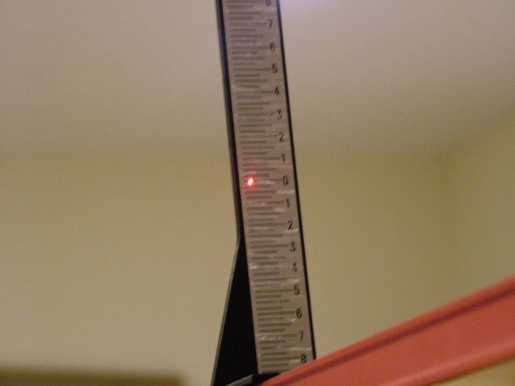

I'm using a laser meter. First I used the canopy as a reference point set to zero. Then I took readings around the plane 5 times to be sure I got everything right. I don't know how to check my motor thrust lines with what I have, but from the best I can tell using a level and my eyeballs it looks like I have the normal right thrust and down thrust built in. And, yes I found Bryan's article on trimming during my search for insight on incidence. Really a wealth of information in his [link=http://hebertcompetitiondesigns.com/triangulation.aspx#]Triangulation Article[/link]. Thanks for the tip though. Definitely a "must read"!

Subtle differences in leading edge or trailing edge sanding or even placement and angle of your meter relative to the fuse centerline can lead to different readings. Since the E-Motion has front and rear carbon fiber tubes, any side being low will cause the opposite side to be a little high which will show up as the stab out of square to the fin. The stab halves are not adjustable so whatever happens to one side would affect the other side. Since the fin and stab are square, I would look to a tool or possibly placement induced cause.
I've been using negative incidence in the right stab relative to the left stab for 20+ years. Geometrically straight and aerodynamically straight are not the same when there is a single propeller on the front of the plane (causing spiral airflow). When you have the amount of bias in the stab correct, the plane will have the same pitching behavior in both KE's, and then you can you wing incidence, CG, or thrust to perfect the KE. Mixers are not preferred as they will only be 100% correct at a single airspeed and angle of attack.
