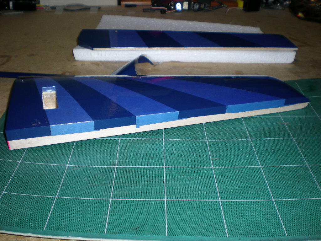

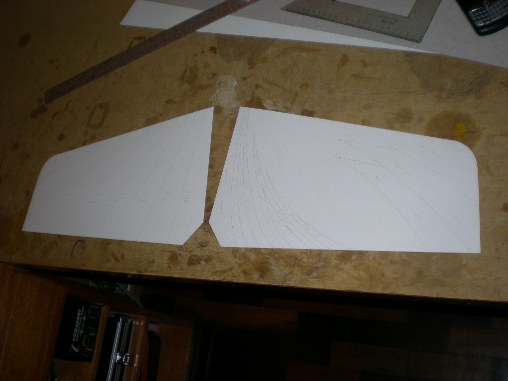

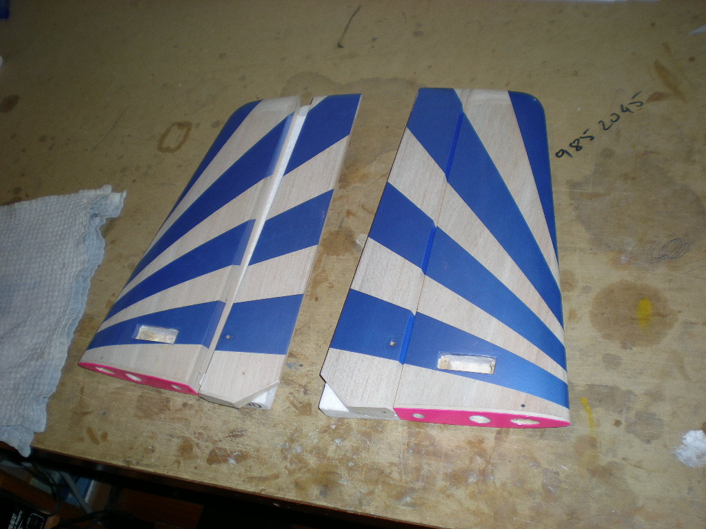

more...

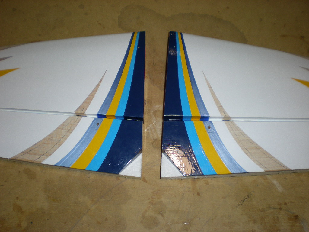

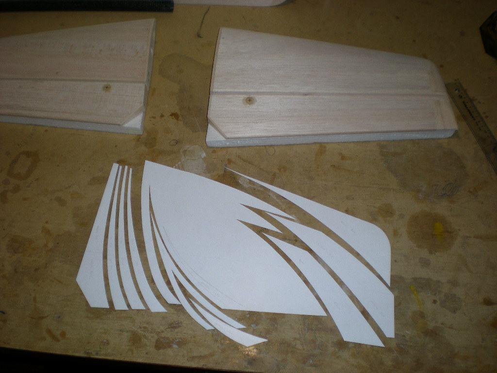

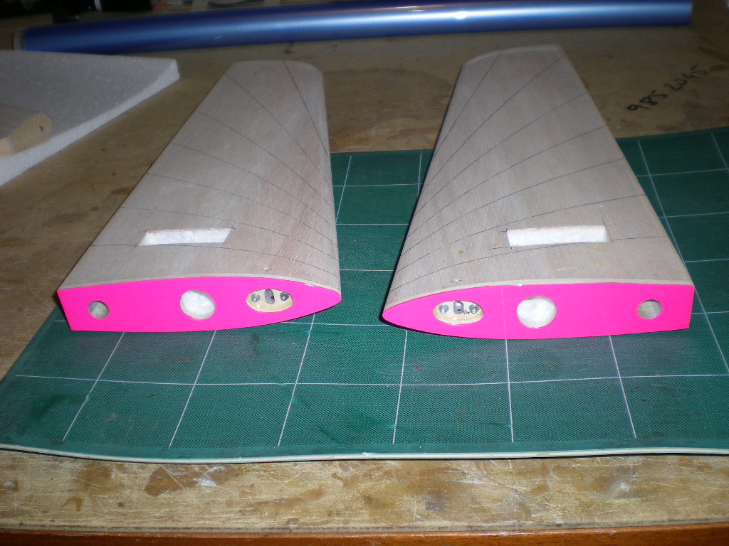

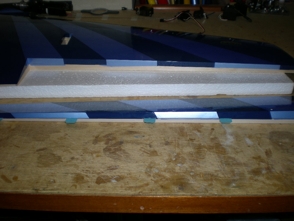

filler added where needed, now wings are almost done, just final sanding and covering left. they ended up very ligth.

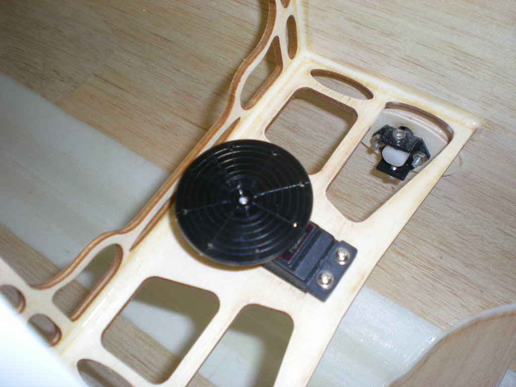

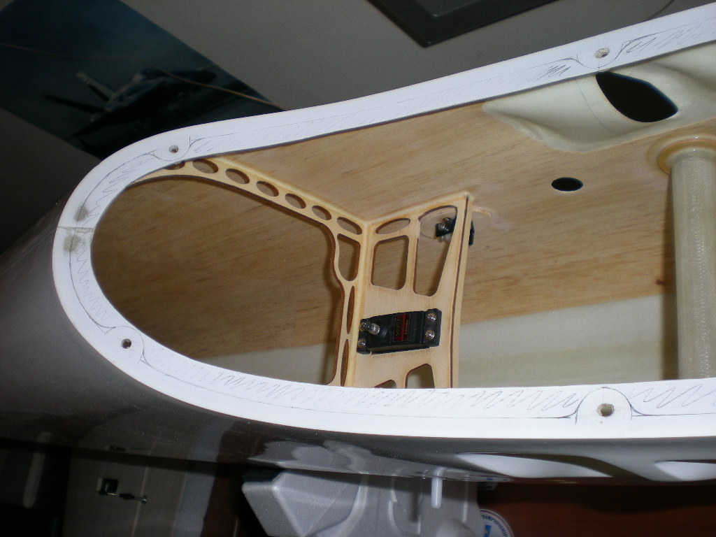

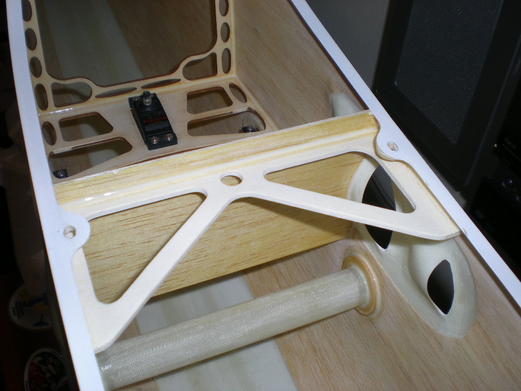

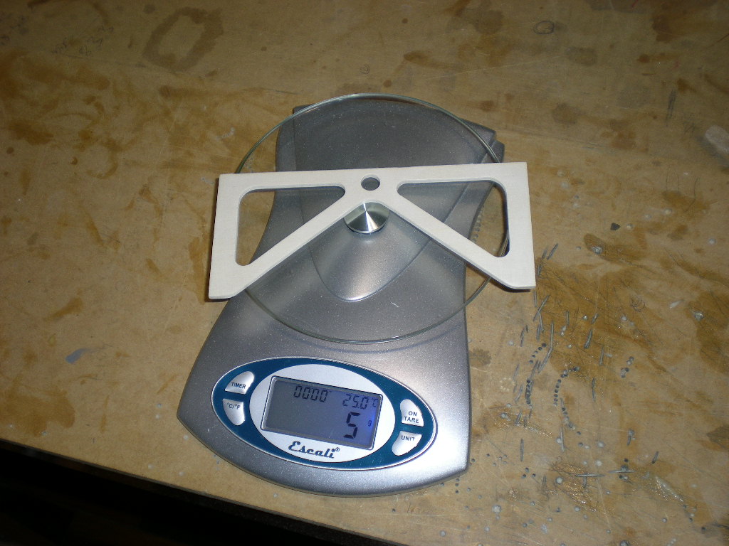

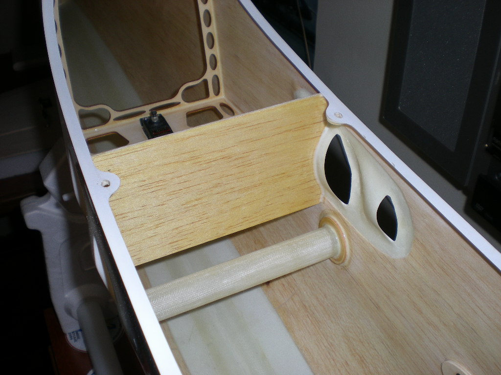

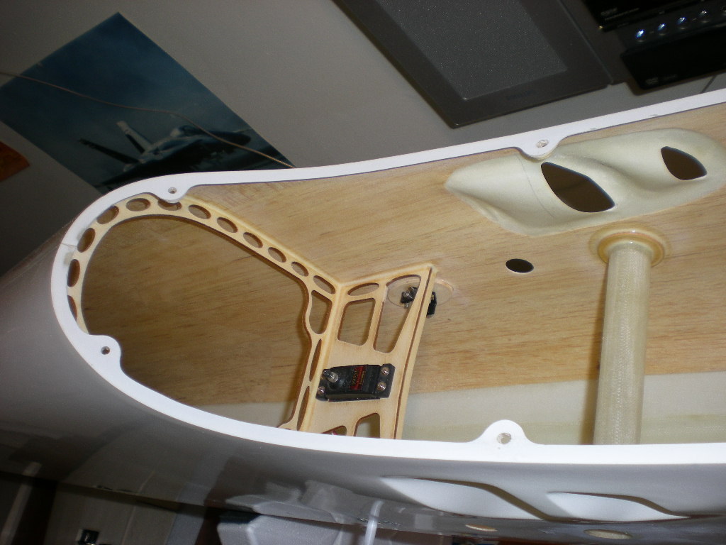

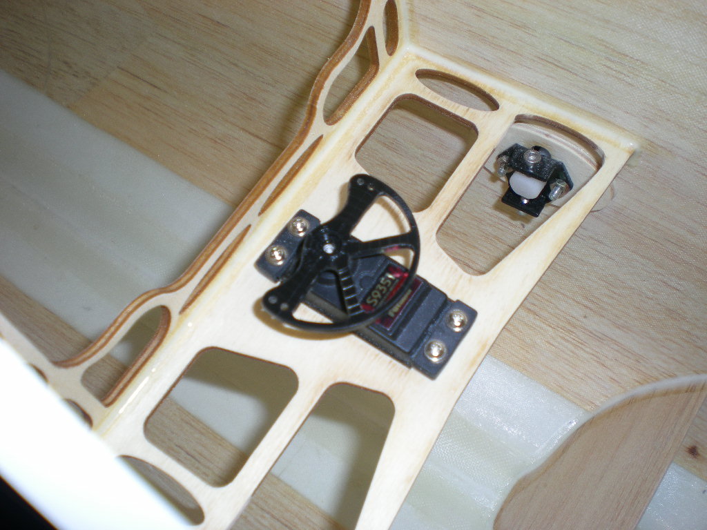

rear former and rudder servo tray.
I used the supplied pieces as they are very good. I added a little piece under the rudder tray to reinforce it a little bit and avoid bending, I also removed some parts to allow better acces to the wing adjusters. all glued to the fuse with 30 min epoxy and microballoons.
pics...

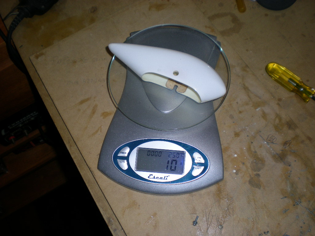

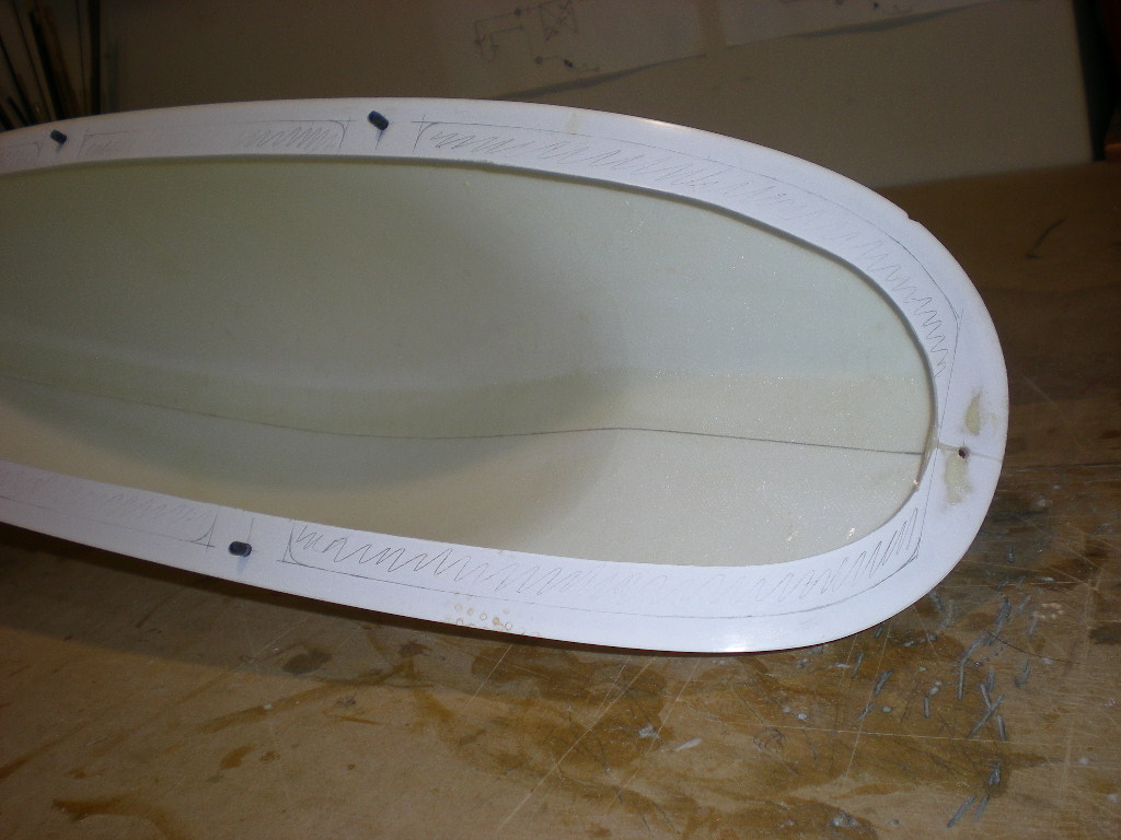

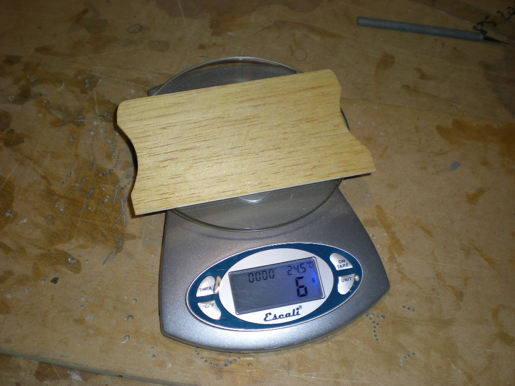

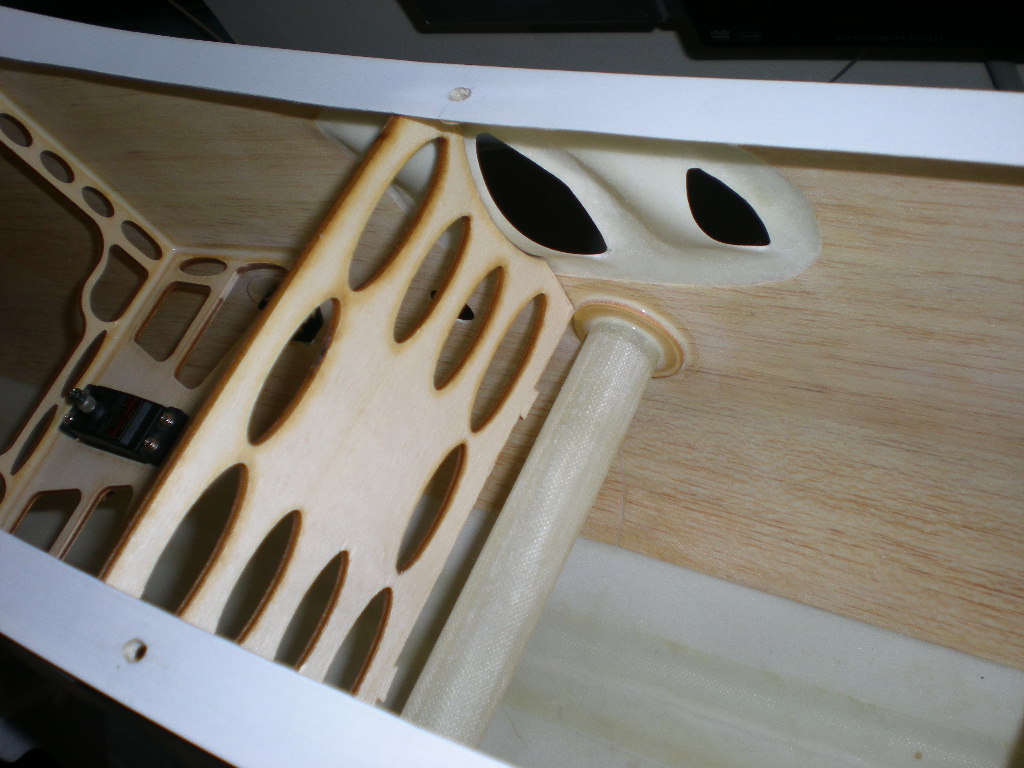

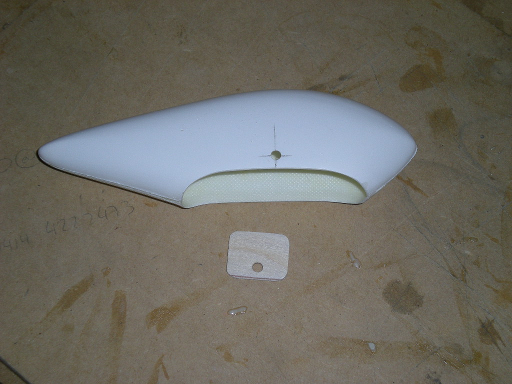

the included former for the ventilation holes, (this former improves ventilation and add strength to the fuse) is made of 3mm plywood, I will replace it with a 2mm balsa with 3/4oz glass on both sides, also I included an extra former made of 1/8 lite-ply to eliminate any twist possible in the fuse. all this is lighter than the original former.
then saved some weigh by reducing the canopy frame on the fuse.
pics.

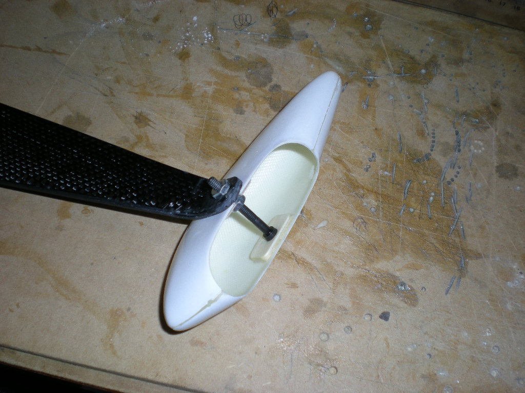

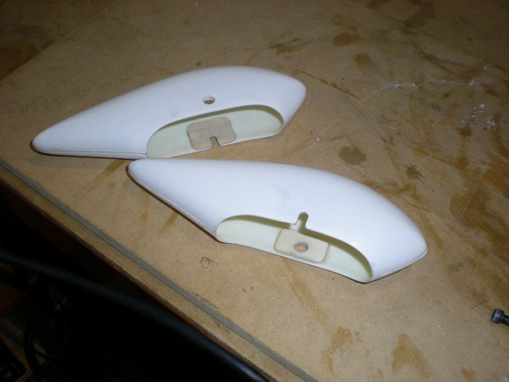

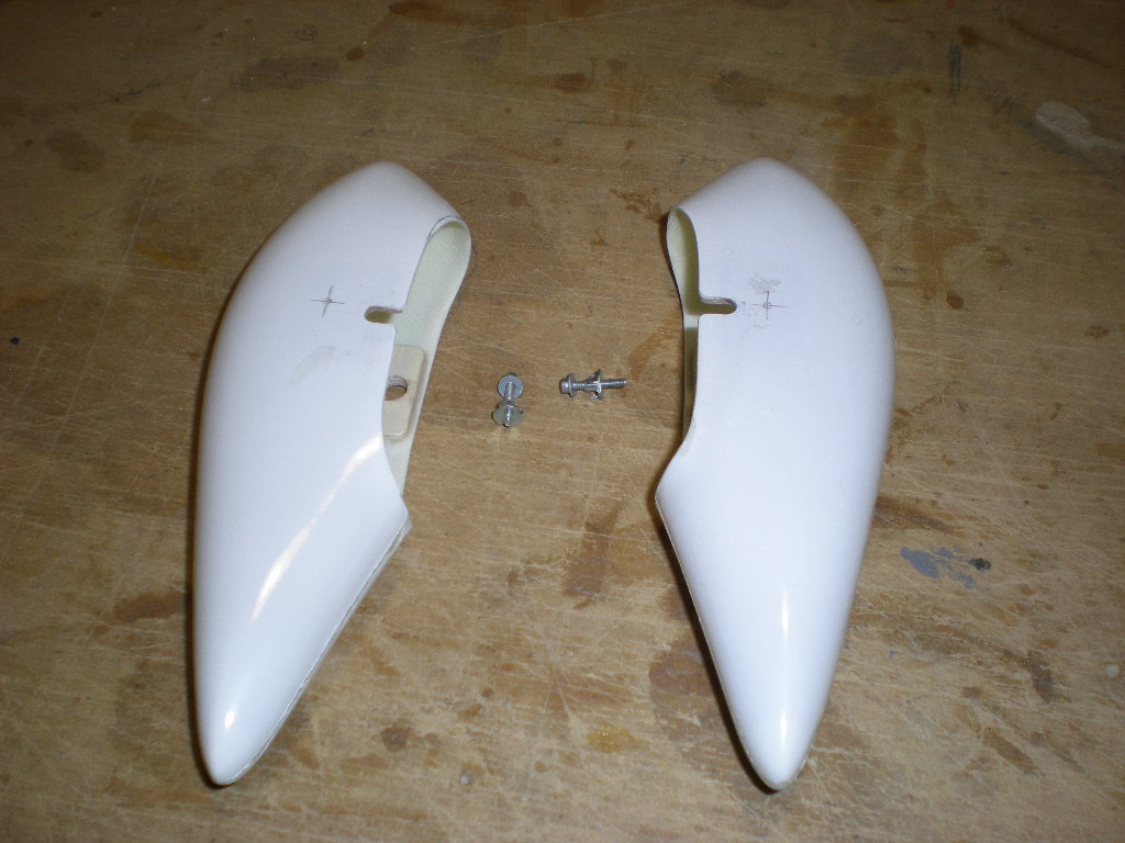

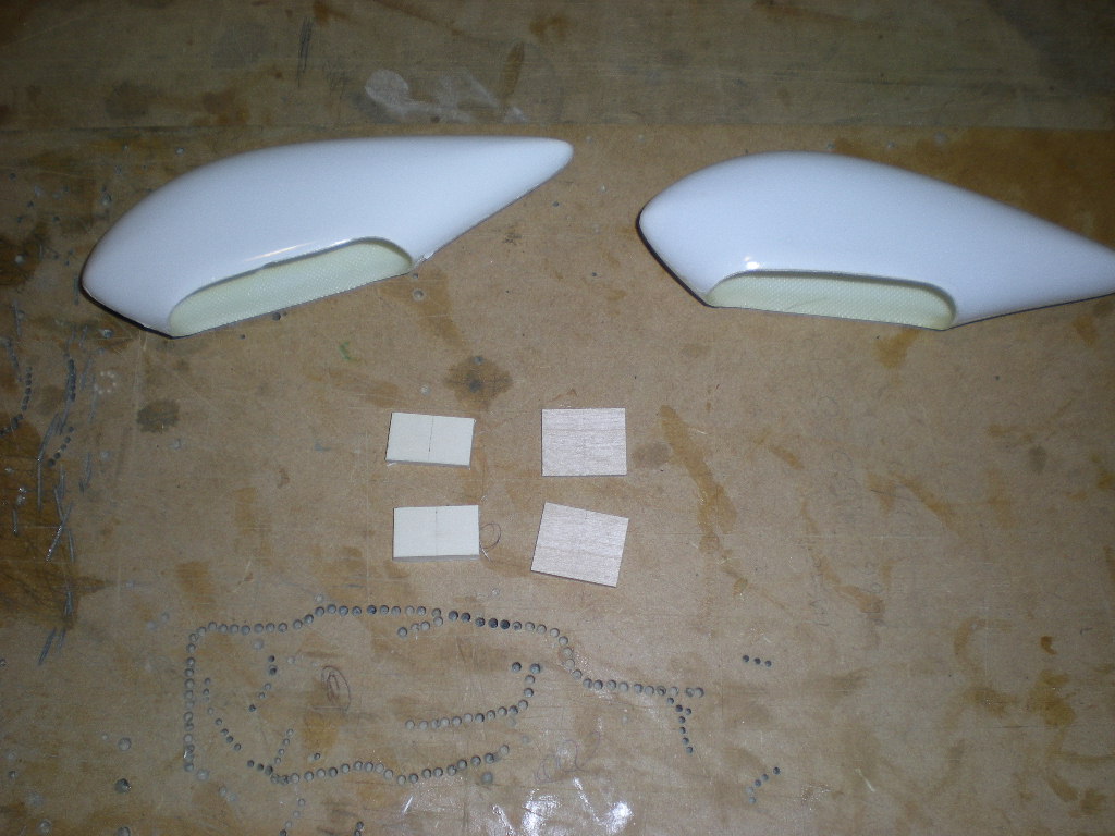

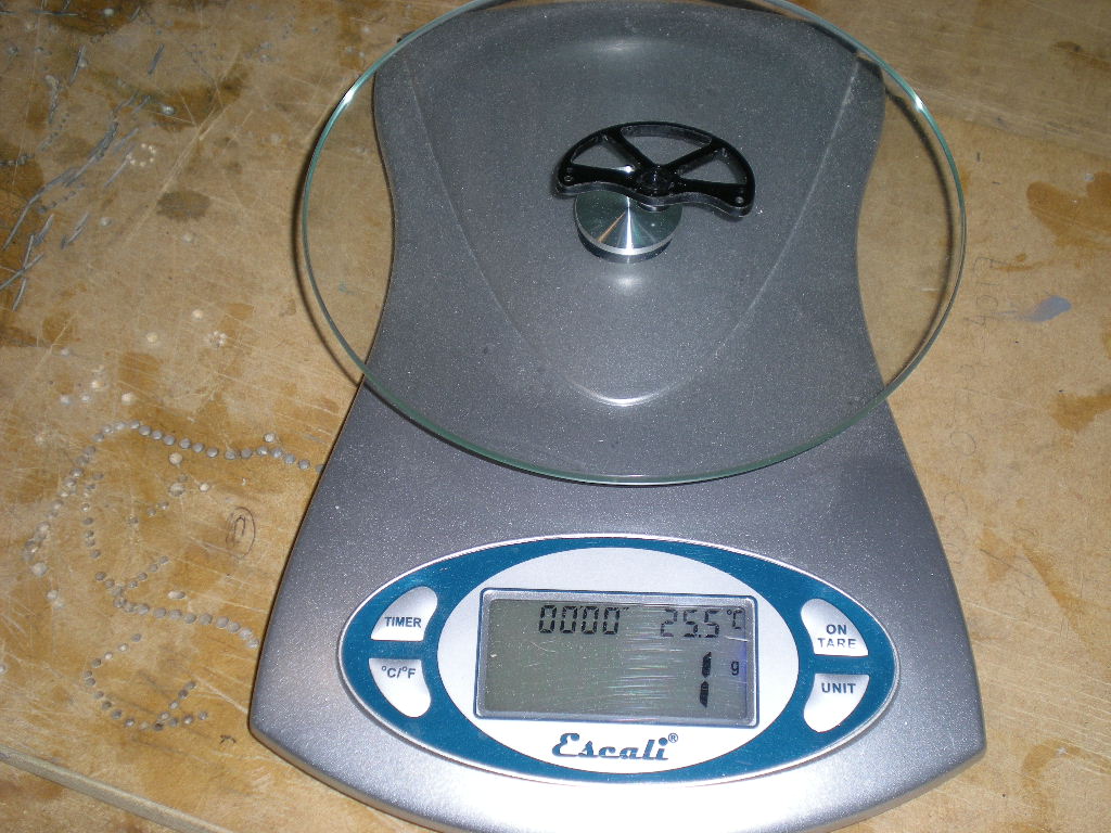

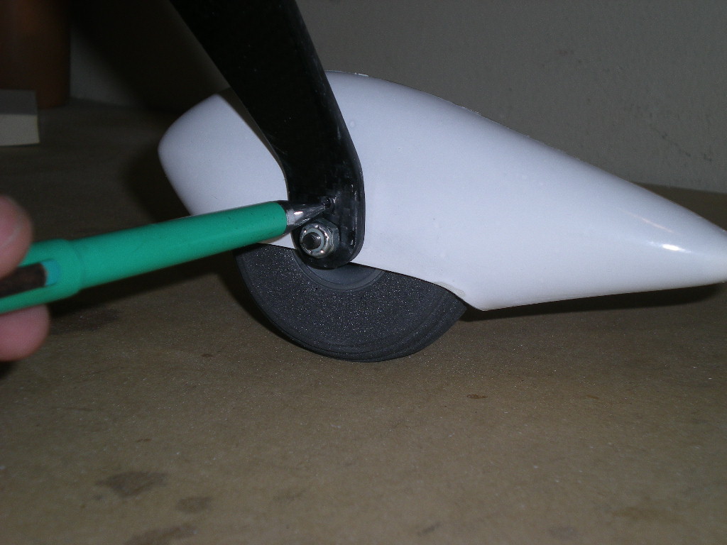

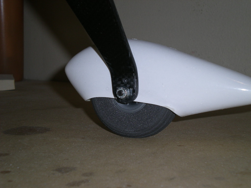

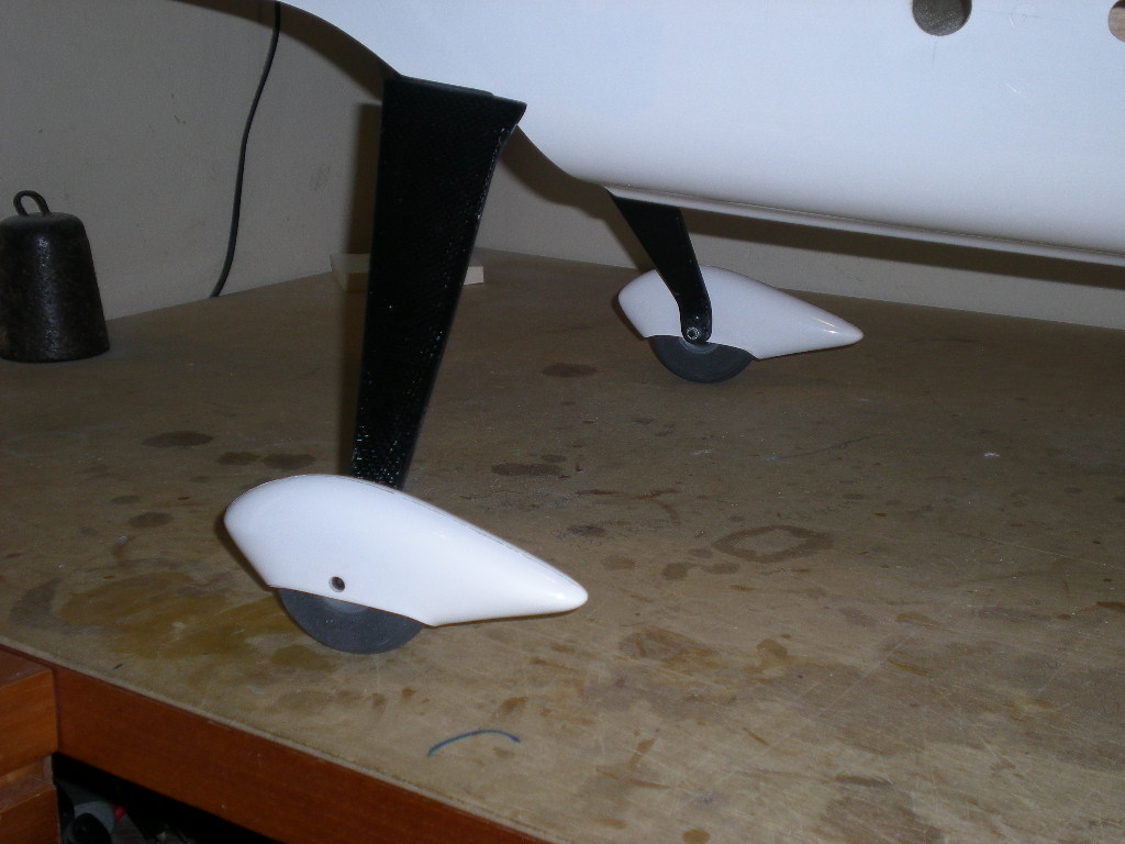

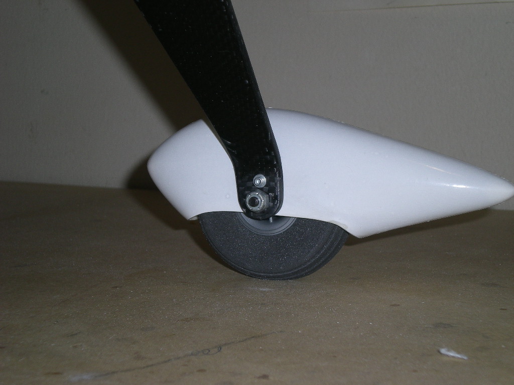

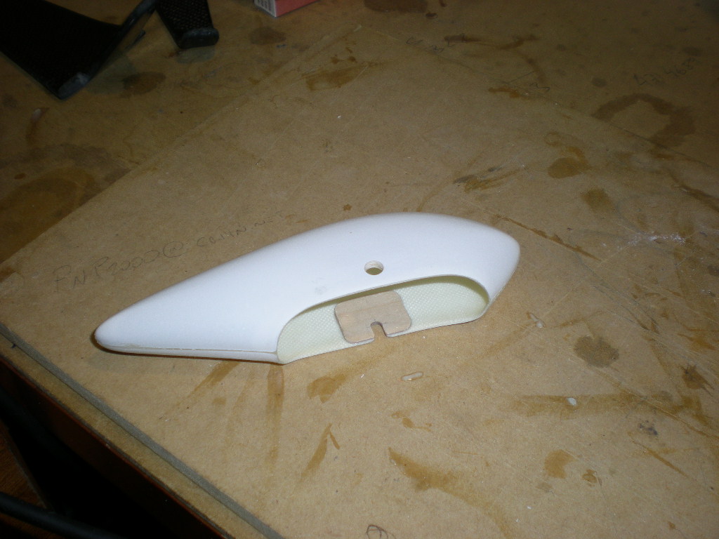

Wheel pants.
the wheel pants are attached by a 8/32 screw that works as the wheel axel, and a 2/56 as an anti rotation screw. all mounted on 1/16 plywood reinforcements.
on the outer side I use 1/8 lite plywood as a guide to the screw.
I have mounted my wheel pants this way for a long time and it is absolutely bulletproof.
pics...

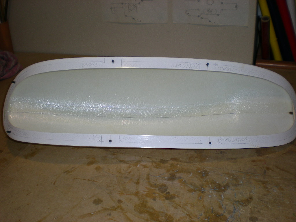

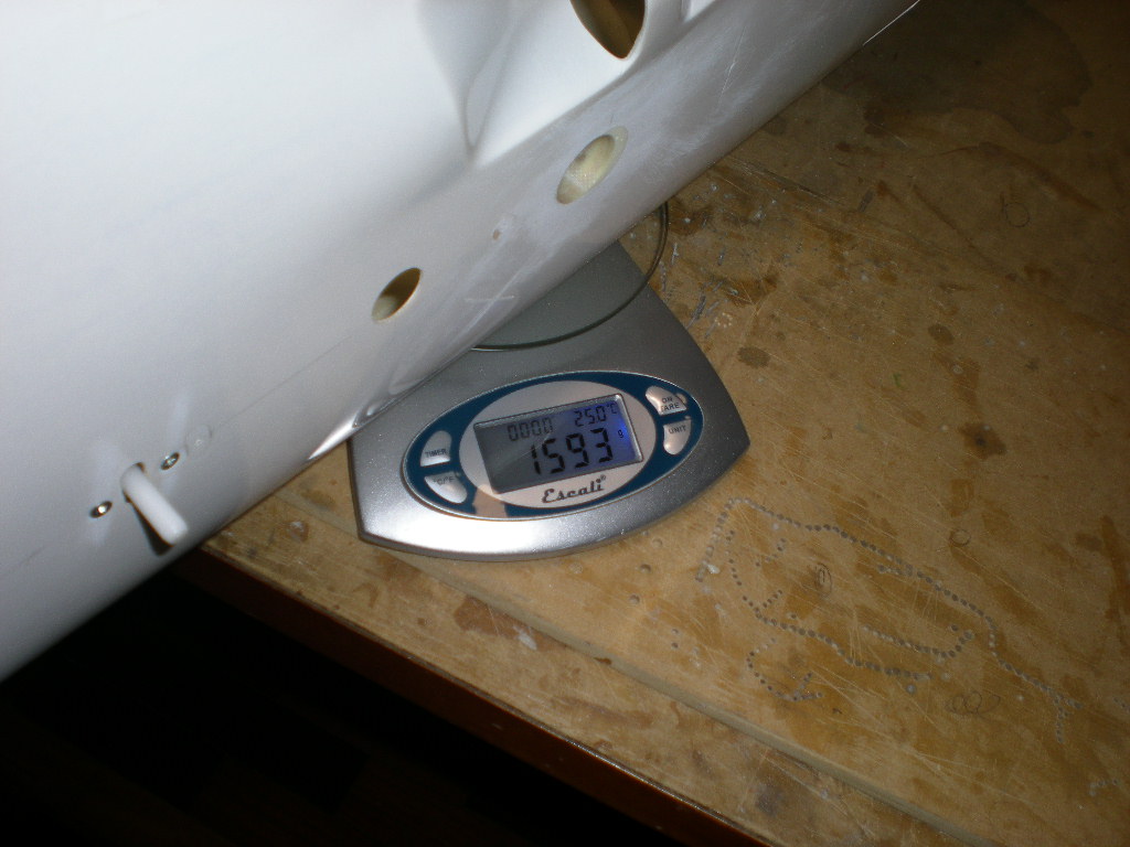

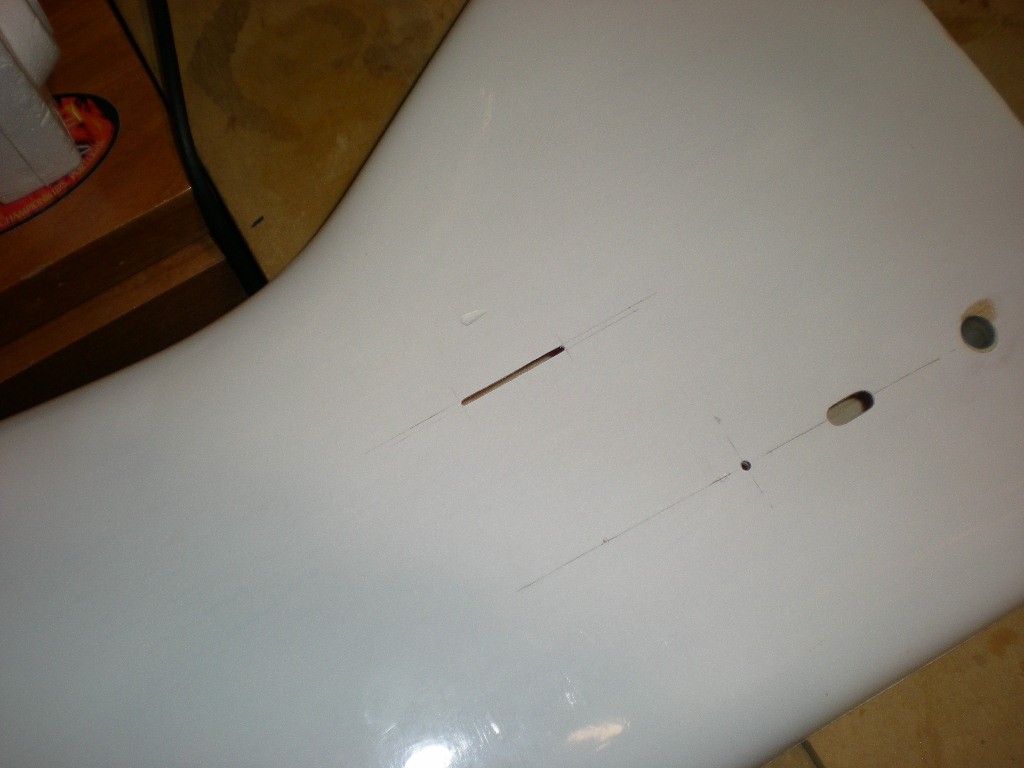

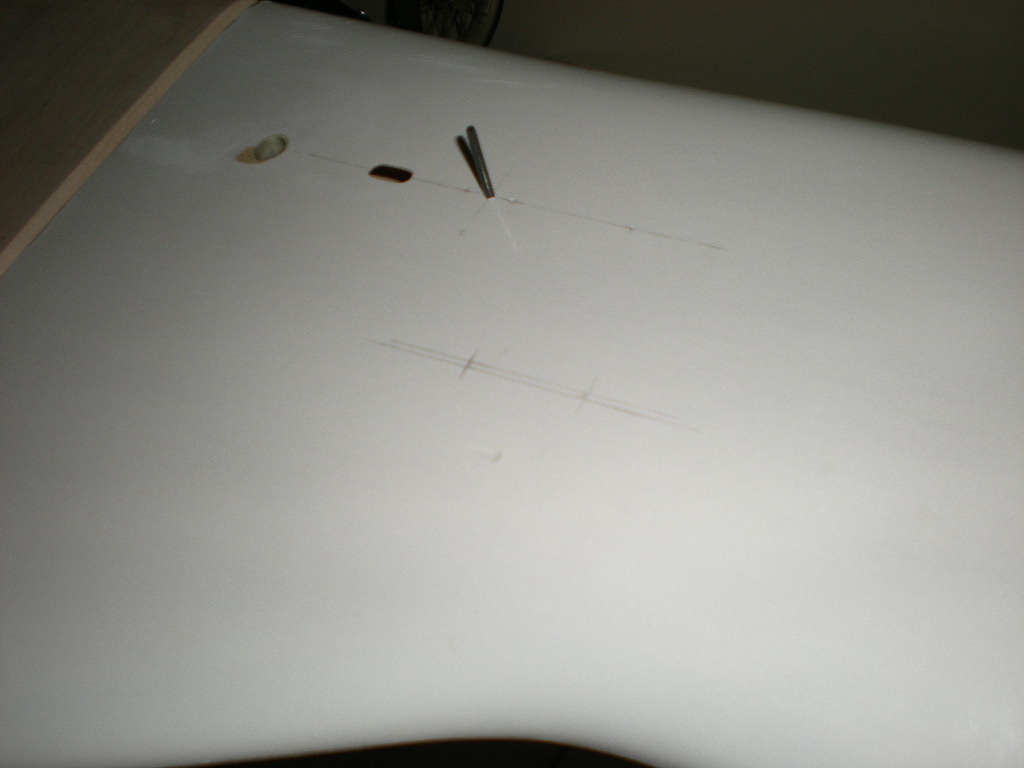

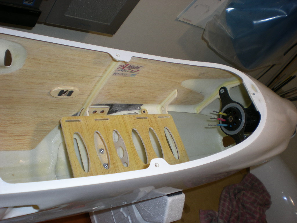

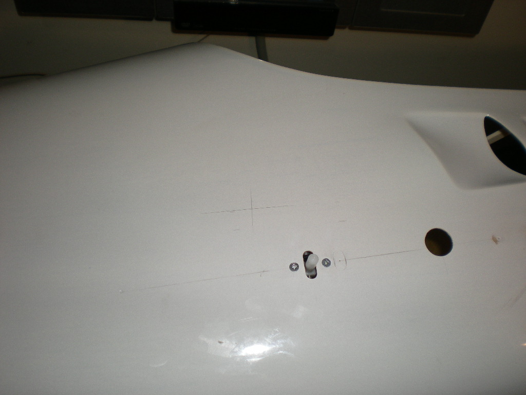

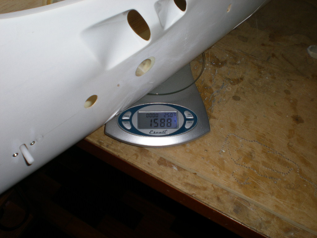

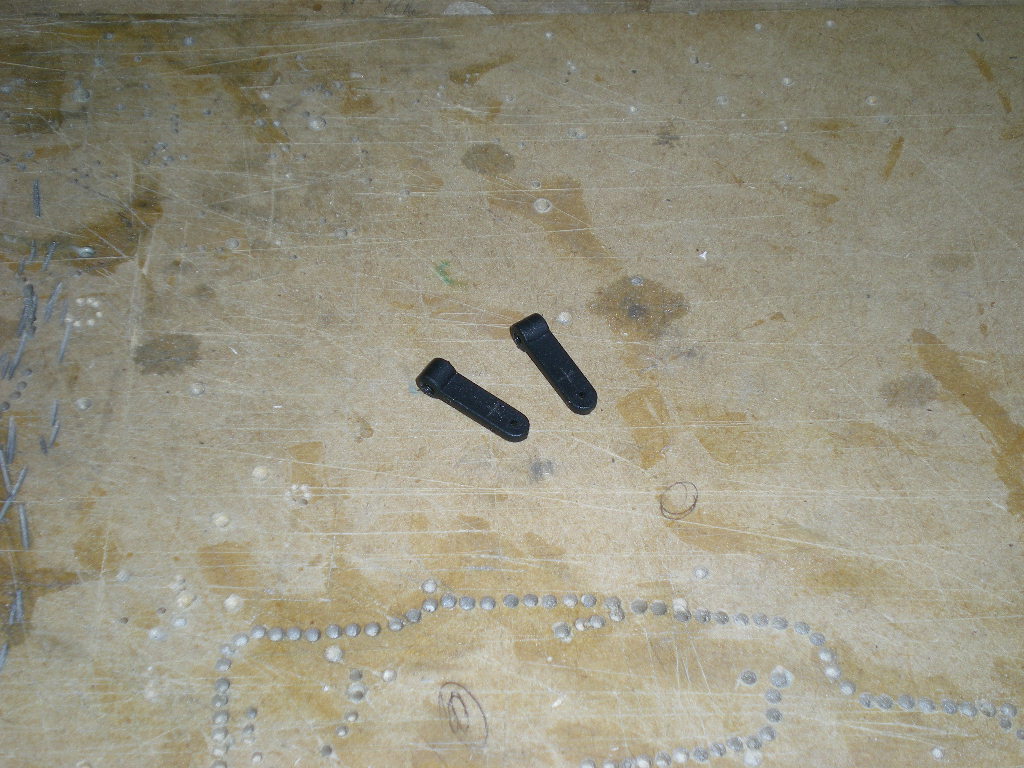

I added another ventilation exit hole in the bottom of the fuselage, and installed an extra former to help the air out, this former is just 1/16 balsa.
then cut the servo horn for the rudder and mark the rudder pull-pull cables exit holes and rudder control horn location.
pics...

Hello Tuny:
what tool and speed did you use in the mototool to do that job in the servo arm? i've tried that several times and i have problems avoiding it to melt down.
exelente trabajo!!! Gracias!

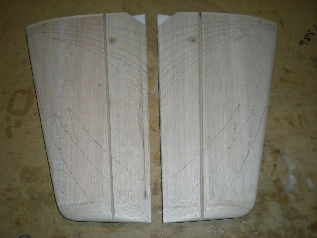

first make rough holes and then use a 1/16 drill to smoth the holes, this way it wont melt.
more....

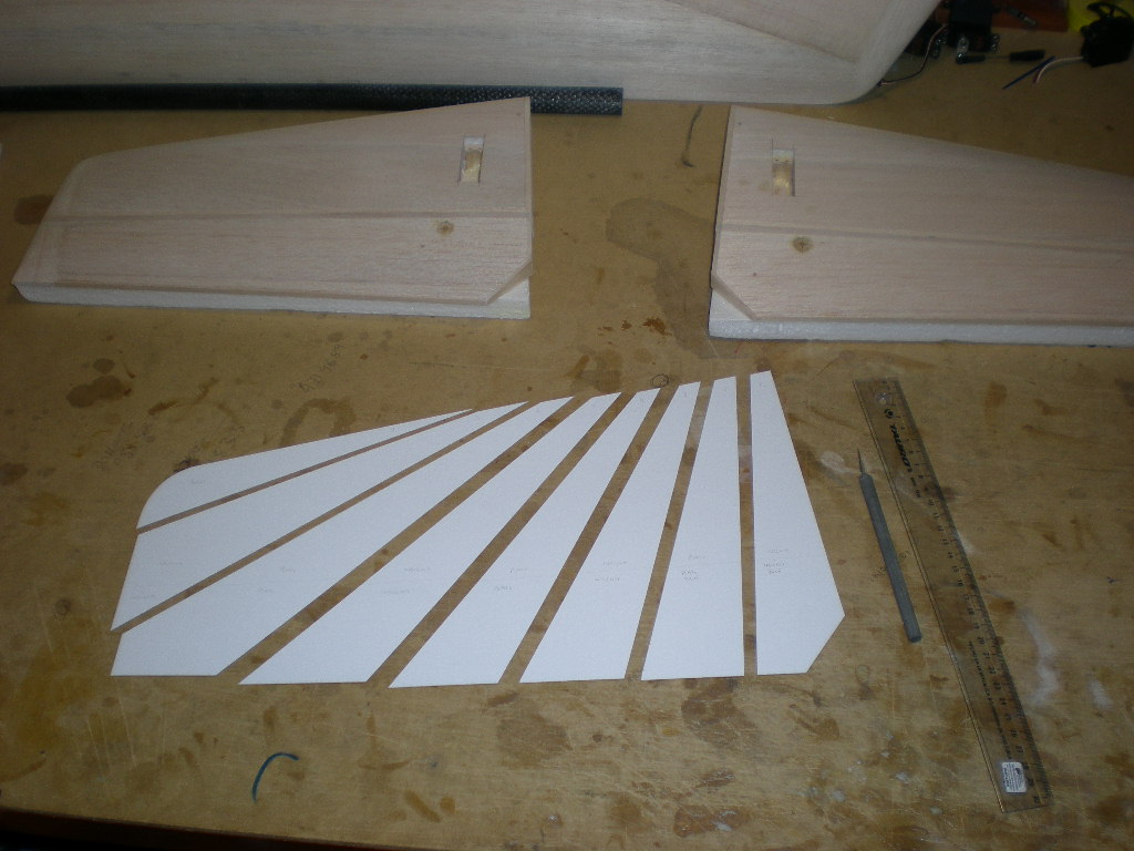

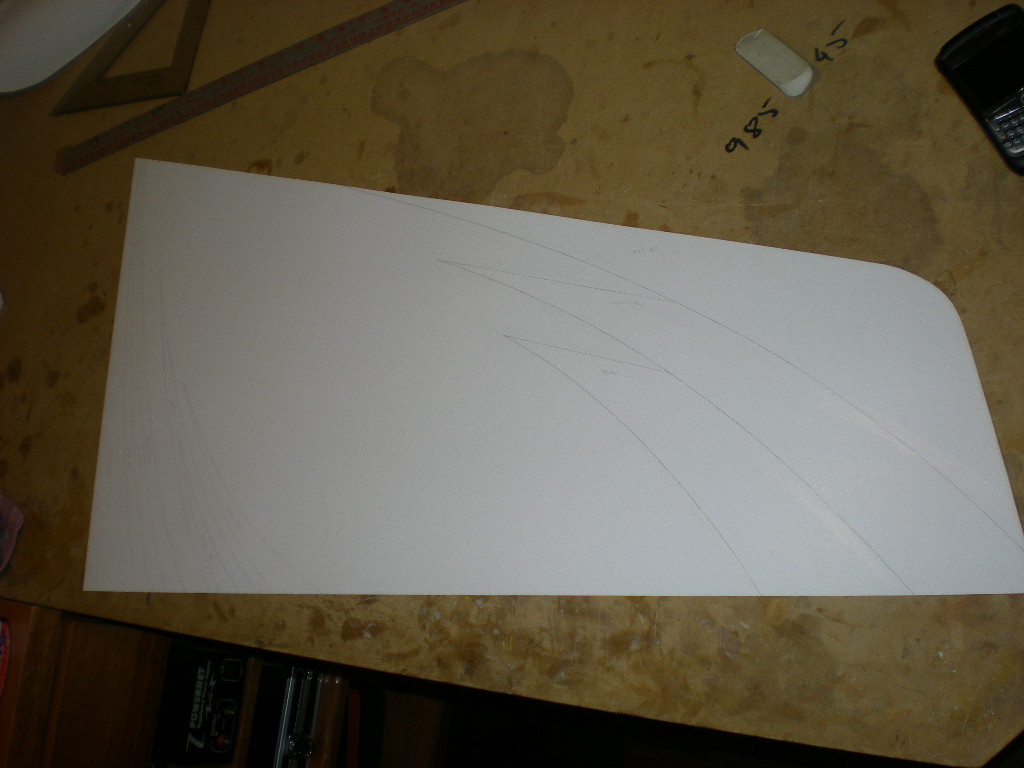

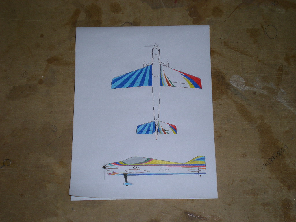

rudder finished, control horn installed, holes in the fuse for the rudder cables finished.
now ready to cover and paint, but first I have to work on the scheme.
pics...

Old 06-29-2010 | 10:00 PM
  #63
Joined: May 2005
Posts: 615
From: caracas, VENEZUELA
Default RE: CA MODEL ONAS BUILD
finshed the scheme and started working on the cardboard templates for the covering.
pics...
ID:	1460572   Click image for larger version
ID:	1460573   Click image for larger version
ID:	1460574   Click image for larger version

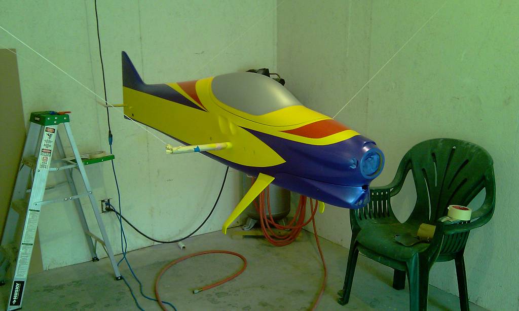

I just finish paint mine yesterday only got left graphics and clear coat

Old 07-02-2010 | 10:50 PM
  #68
Joined: May 2005
Posts: 615
thanks Rodney, yes, I love kit building.
looks very nice Vquick! let me know how it flies and finished pictures.
more....
all surfaces final sanded (320 sandpaper)
cut the cardboard patterns and make the lines on the surfaces, next start to cover.
pics... (there is one on my scheme, not the exact colors but you can get the idea of what I´m trying to do)
ID:	1462250   Click image for larger version
ID:	1462251   Click image for larger version
ID:	1462252   Click image for larger version
ID:	1462253   Click image for larger version
ID:	1462254   Click image for larger version

Old 07-11-2010 | 07:57 PM
  #73
Joined: May 2005
Posts: 615
Thanks Highfly3d!!!
more...
ID:	1466399   Click image for larger version
ID:	1466400   Click image for larger version
ID:	1466401   Click image for larger version
ID:	1466402   Click image for larger version
ID:	1466403   Click image for larger version
ID:	1466404   Click image for larger version
ID:	1466405   Click image for larger version

Old 07-12-2010 | 09:53 PM
  #74
Joined: May 2005
Posts: 615
more...
ID:	1467122   Click image for larger version
ID:	1467123   Click image for larger version
ID:	1467124   Click image for larger version
