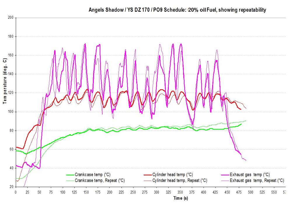

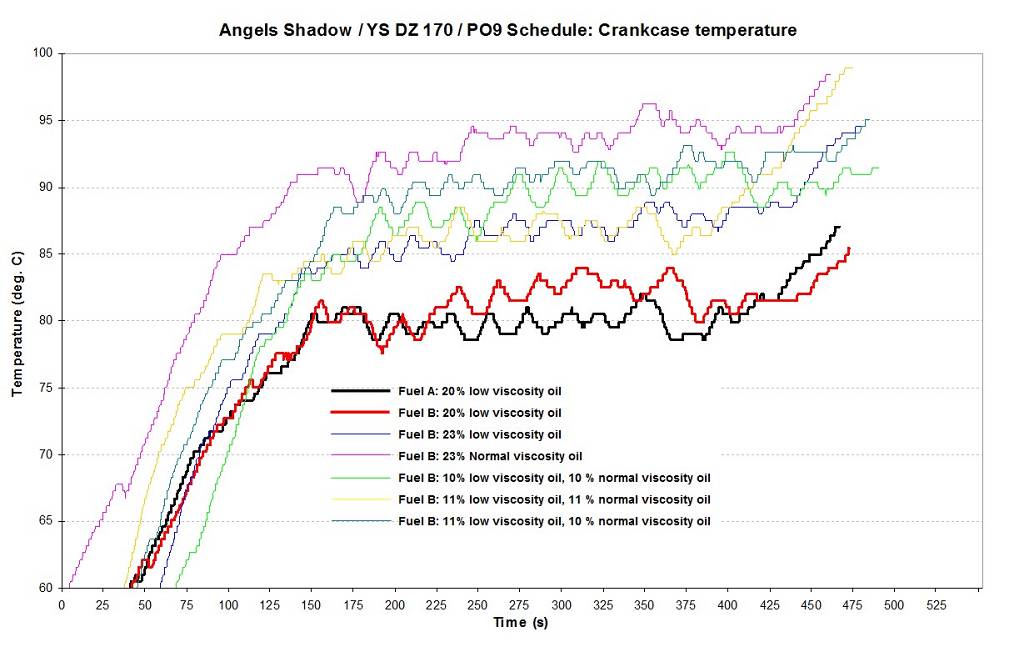

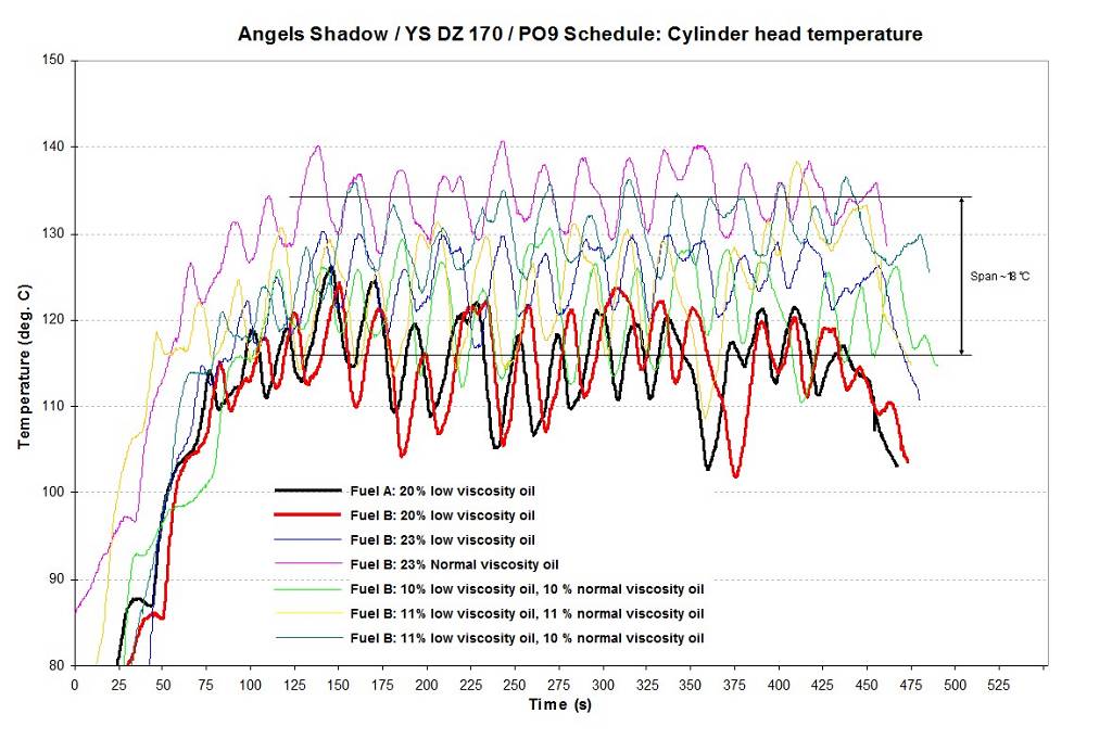

I wanted to share my experiences with different fuel viscosities. I undertook some fuel testing a couple of years ago to compare a leading 30% nitro heli fuel (denoted Fuel A in the graphs) with a prototype fuel of similar constituency (Fuel B). There were several aims with one aim being to test the engine performance as a function of variation of fuel viscosity and another to reduce the smoke production during F3A flights. All tests were done on the same day so weather conditions could be comparable. Needle settings were optimised during each test. A single schedule of PO9 was flown and the model landed. Each time crankcase, cylinder head and exhaust gas temperatures were recorded.
The results were surprising in many ways but the relevant bit here was that more oil lead to higher temperatures and lower engine speeds. At the worst case 23 % KL200 oil (standard Klotz super techniplate: denoted normal viscosity oil in graphs) reduced engine speeds by up to 200 rpm compared with the 20% KL198 (denoted low viscosity oil in graphs) mixture with engine temperatures rising by 22 degrees C at the cylinder head.
I guess any thermodynamic system will have an optimum lubrication vs fuel mixture but the evidence here clearly suggests that anything more than 20% oil in a DZ170 leads to poorer performance and higher temperatures, with the incumbant effect on engine longevity.
Best wishes
Keith

Keith, was there any reason for running 23% KL-200? as opposed to the 20% KL 198?
Old 07-07-2010 | 02:19 AM
Joined: Dec 2004
Posts: 166
Received 3 Likes on 1 Post
From: Crewe, UNITED KINGDOM
Default RE: How to adjust needle with low oil fuel on 170 CDi?
Hi Bryan / Rendegade,
Yes the YS instructions state oil content as 20 - 23%. Most pilots like their engines to last and would try to provide best conditions for longevity and hence might lean to 23% oil. In fact some manufacturers produce fuel to cater for YS engines using 23% oil. This I believe is partly to allow pilots to stick within warranty conditions and / or for the afore mentioned feel good factor. I think however if depends strongly on what oil you use; maybe there is an oil out there where 23% content is good, but clearly this is not the case with the oils I used, and which are present in most heli fuels that YS use.
I hope to do more work like this on the CDi blends; currently I'm using 25% nitro / 10% KL198 oil with great success and my CDi turns an APC 18.1 x 11 at 7950 - 8000 rpm with idle down to 1500 rpm.
Keith
