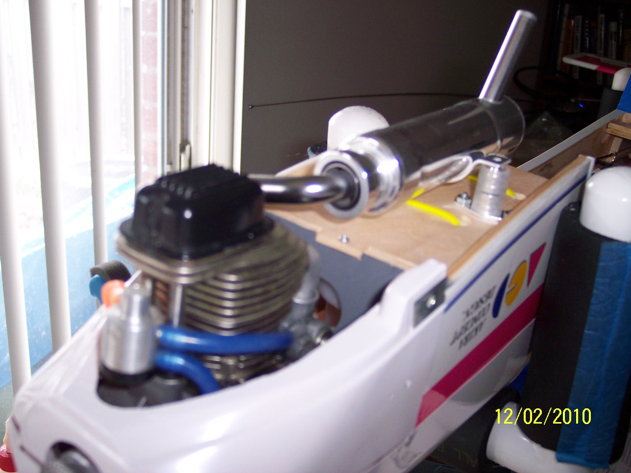

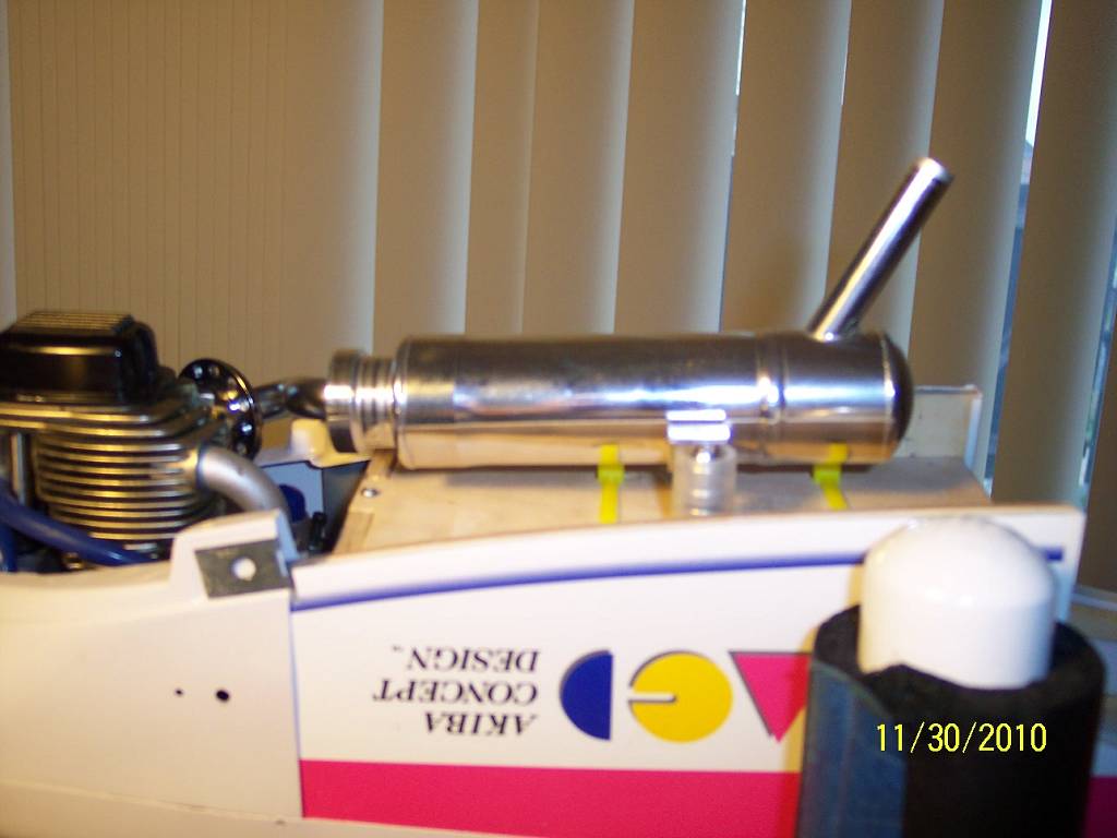

Looks like your header is all the way in to the muffler.
You will want to have at least 1/8" space between the muffler and header because of the vibration. I will try to take a picture and post here.

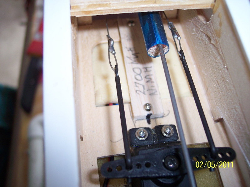

I think you use a digital “high torque” S3152 servo for elevator (second picture post 39).
Push and pull forces in the pushrod can be (with that lever on the servo of 10 mm(?)) about 5 a 6 kgf.
With these forces the servo will rotate a few degrees around the mounting screws I am afraid, so elevator position is depended of load (aero dynamical forces). I would prefer mounding in length direction.
It’s only an advice, maybe the servo never has to do that heavy job, but even then I always mount elevator, rudder and aileron (low torque!) servo’s in length direction for better positioning of the control surfaces.
See picture.

Normally a flexible rubber mounting reduces the vibrations, so the servo has to be free mounted, and not touching the servo bay only the screws and rubber.
In that case a lengthwise position is always the best (also for hysterese in the mounting position!), but I also think the forces arn't too much in your situation, so I think it is all oké.
Maybe other people do have their opinion, I do not know this plane in detail!!!
Keep in mind, when you fly the plane and have the re-trim level many times, to look again at this subject!
Cees
It was just a note.
Cees
