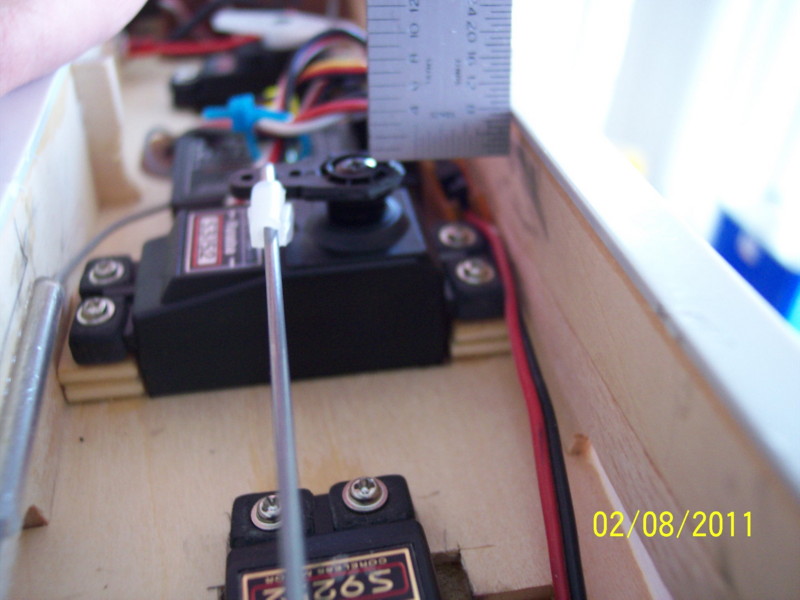

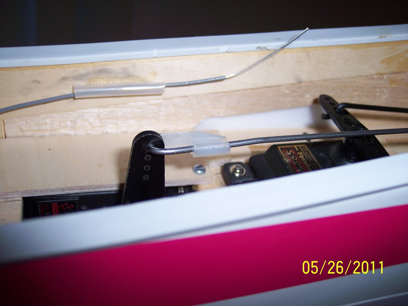

I couldn't stand it. After considering the issues concerning the elevator I decided to look at the possibility of changing the orientation of the servo. I found that the Futaba S9551, which is a low profile servo, just might work. It just did.
Also, I did notice that the engine thrust is about 1/2 degree up which doesn't seem right to me. The mount for the engine is a flat plate that is secured to the beams. Do I need to change that?
I also decided to go with the YS FS70 which is lighter than the YS63S and has a bit more power.

I'm impressed you went as far as that for a 50 sized model, I tend to look at them as the epitome of KISS principles.
That said I've never noticed much of a change on elevator halves on any of my aircraft with a horizontal elevator servo.

Excellent work on the elevator servo! I never thought of doing it that way.
Don't change the thrust. there should be a reason for that unless manual specifies how much down/side thrust shoud there be.
Have you flown it? How does it fly? any coupling problem with rudder input?
