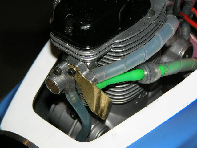

I don't think you have to specifically put fins onto the pump area just to cool them. I believe anyone who flies a glow plane with either a chin cowl or a bvellypan already will have an opening right at front where the pump is located, no one will be flying a plane with a totally enclosed frontal area. As much as cooling the pump is important, it is also essential to ensure the rest of the engine runs cool as well - the valve cover area, the cylinder - that's why they have cooling fins along the side of the engine.
In addition, it's real important to install foam to redirect cool air onto those specific area. Otherwise, even though, the pump may get direct cold air, the rest of the engine will still be hot. Thus, will still contribute to "vapor lock".

I think we might have to disagree on that point.
I accept that good cooling and venting arrangements are essential. And I also accept that the pump faces directly forward into the airflow. However even a small increase in pump operating temperature may be sufficient to trigger cavitation. I think that may be why the problem of eroded valve seats is affecting some YS170’s (especially the CDi’s) when it was never really an issue with YS160’s. It would also explain why:
# Propeller load is a significant factor in the equation and why YS are advising that the RPM should be kept above 7,300. More load means more heat generated, which in turn means higher pump operating temperature and a higher chance of cavitation.
# Relocating the pump position of the original YS140 Dingo was enough to solve the problem (at least initially).
No matter how effectively cooling air is directed over the engine, cooling fins on the regulator body could only help with keeping the temperature down and thereby reducing the chances of cavitation. They would also help the heat to dissipate more quickly from the regulator/poppet valve assembly on completion of a flight.
The photographs in the attached link show just how destructive the effects of even a small amounts of cavitation can be - http://www.google.co.uk/images?hl=en...=&oq=&gs_rfai=
In the process industries, even when exotic steels are employed in a pump or valve body, the erosion that is caused by cavitation can eat the metal away in no time. When that metal is an alloy (as in the case of the YS poppet valve seats), it might as well be cheese. Even a very small amount of cavitition could give rise to the pockmarked valve seats that many YS170 users have experienced after relatively few flights.
Anything that can be done to reduce the pump operating temperature could only be worthwhile. Larger cooling fins on the main crankcase would also help in reducing heat transference but at the expense of much more weight, not to mention the higher development costs associated with a new crankcase mould.

In the meantime, I have fitted one of my engines with some additional cooling for the pump valve body. It takes the form of some brass strip, filed and bent to act as a heat conductor. I have bent the strip in a way that should also help to channel more cooling air over the pump assembly. It is very Heath Robinson and because of the imperfect contact between the brass strip and the pump body I would not expect it to do nearly as good a job as some proper fins machined into the poppet valve housing. Nevertheless, it should help to keep the operating temperature of the pump assembly a few degrees lower. Only time will tell if it slows down the erosion of the valve seats.
In examining the pump assembly more closely, I also noticed that there is at least 2 mms gap between the rear of the fins on the pump cylinder and the front of the main fins on the engine crankcase. This would allow YS to increase the diameter of the fins on the pump cylinder from around 15 mms to around 17 mms if they chose to do so. I believe this would also help with reducing the pump operating temperature and the speed at which the pump assembly would cool down between flights.

I also have trouble with 2 org.170 cdi low oil
the one I have in my Euphoria, has run 30l fuel 12.5 30% mixture
the problem is after 10 15 seconds at full throttle, lean itself out and go hard
and if I give it a couple of clicks on h needle, then turn it some CDI "farts" ;-)
I bought this little 5g delicious case from Robbe, the meter, Max and Min temp.
and stores them,
on my two flights today have been the max of 85 87 degrees
here som pic
a great tråd.ther are made here.
and stores them,
here som pic
