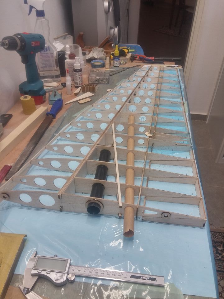

As Bo said, every builder can make his own improvements if he thinks it is necessary. But before extending the secondary spar and wingtube please analyze the examples below and compare them to the Vortex wing. Both are top, proven designs, already on the market for a couple of years.
The first image represents the complete wing structure of the Naruke Ascent monoplane right before adding the balsa sheeting. Here are the main differences to the Vortex wing:
- Ascent doesn't have a secondary spar to reinforce the wingtube, it only has 2 stringers not connected between them or to the wingtube. Vortex has 2 stringers at the top and bottom of the wingtube and 6mm balsa shear web in between which creates a strong secondary spar;
- Ascent wing root rib is made of balsa, the one on the Vortex is made of 3mm liteply;
- Ascent root rib has only a plywood roundel as reinforcement, while the Vortex has a doubler that connects it to the top and bottom of secondary spar;
- There is only one other rib doubler on the Ascent (near the wingtube end). All 4 ribs on the Vortex have plywood doublers.
The second image shows the wing structure of the Neo Stage which is also sold as a kit in Japan. The structure design looks similar to the Ascent. There are probably dozens of these models already flying in the world, so the structure is obviously strong enough for F3A flying. I am only trying to say that the Vortex wing is overbuilt by comparison, so please make sure you are not trying to solve a "problem" that doesn't exist.
I would strongly advise against cutting into the main spar to make room for the wingtube in an attempt to join the 2 spars. This would create a weak point in the main spar which can affect the wing structure.

No problem with yours wings.
Mine have hundreds flights and snaps, plane is equiped with Yamada.
Picture shows wing before balsa 2 mm light sheeting. frame 1 and 5 are in light plywood.
Flexural strength is given by the carbon tube and not by sleeve in the wing. So it is no necessary to reinforce by adding balsa beam.

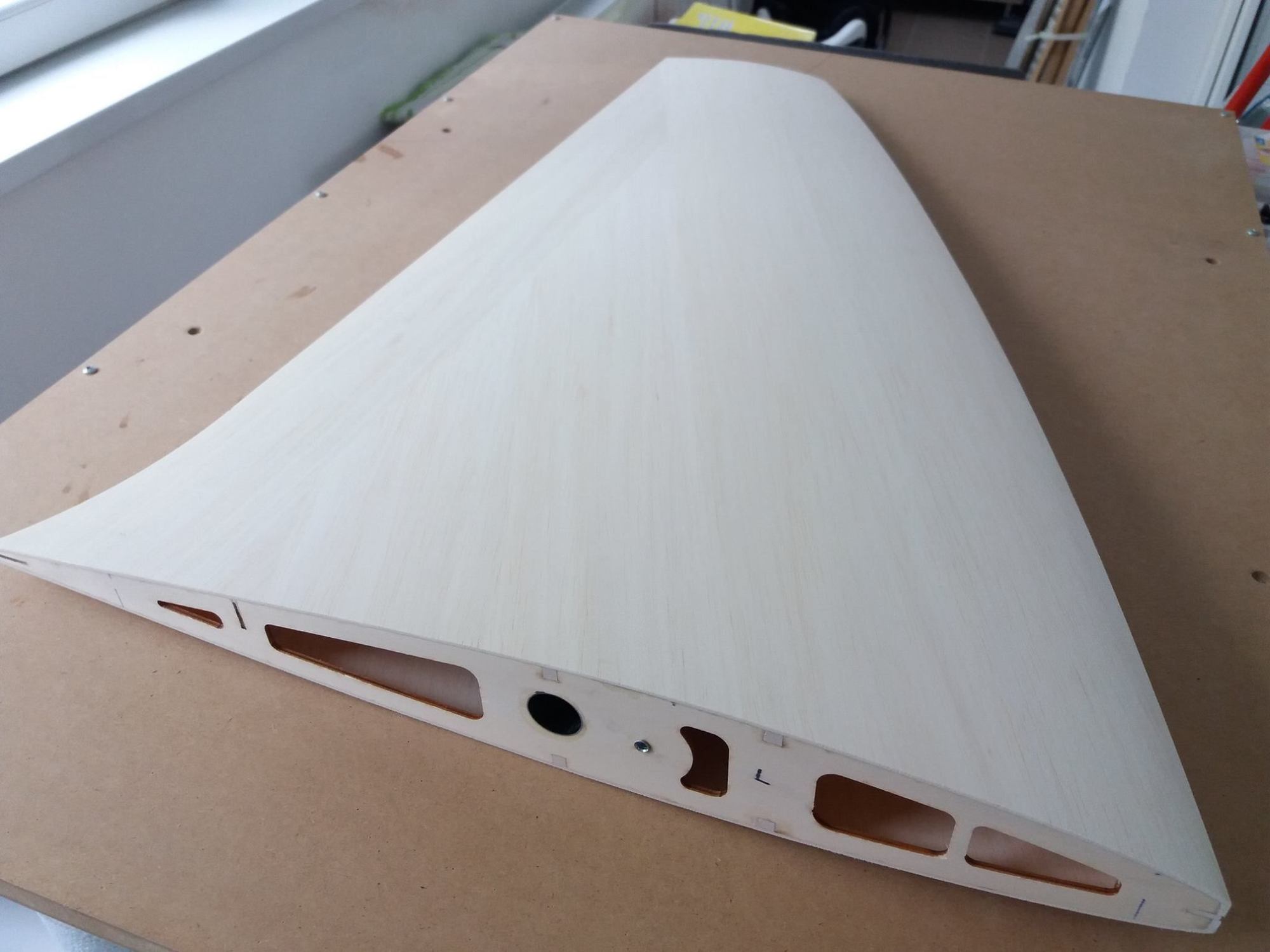

Friend of mine Sebastien makes wings more simple and lighter than mine on his own plane Excellium without any issue.
First pic shows wing before sheeting.
claude
https://cimg2.ibsrv.net/gimg/www.rcu...ae6c0632ad.jpg
https://cimg0.ibsrv.net/gimg/www.rcu...70df842d8e.jpg
https://cimg1.ibsrv.net/gimg/www.rcu...d3e668cedc.jpg
Alex Voicu 09-14-2019 06:04 AM
Thank you Claude. I think we now have many examples proving that the wing is strong enough as it is and doesn't need any modifications.

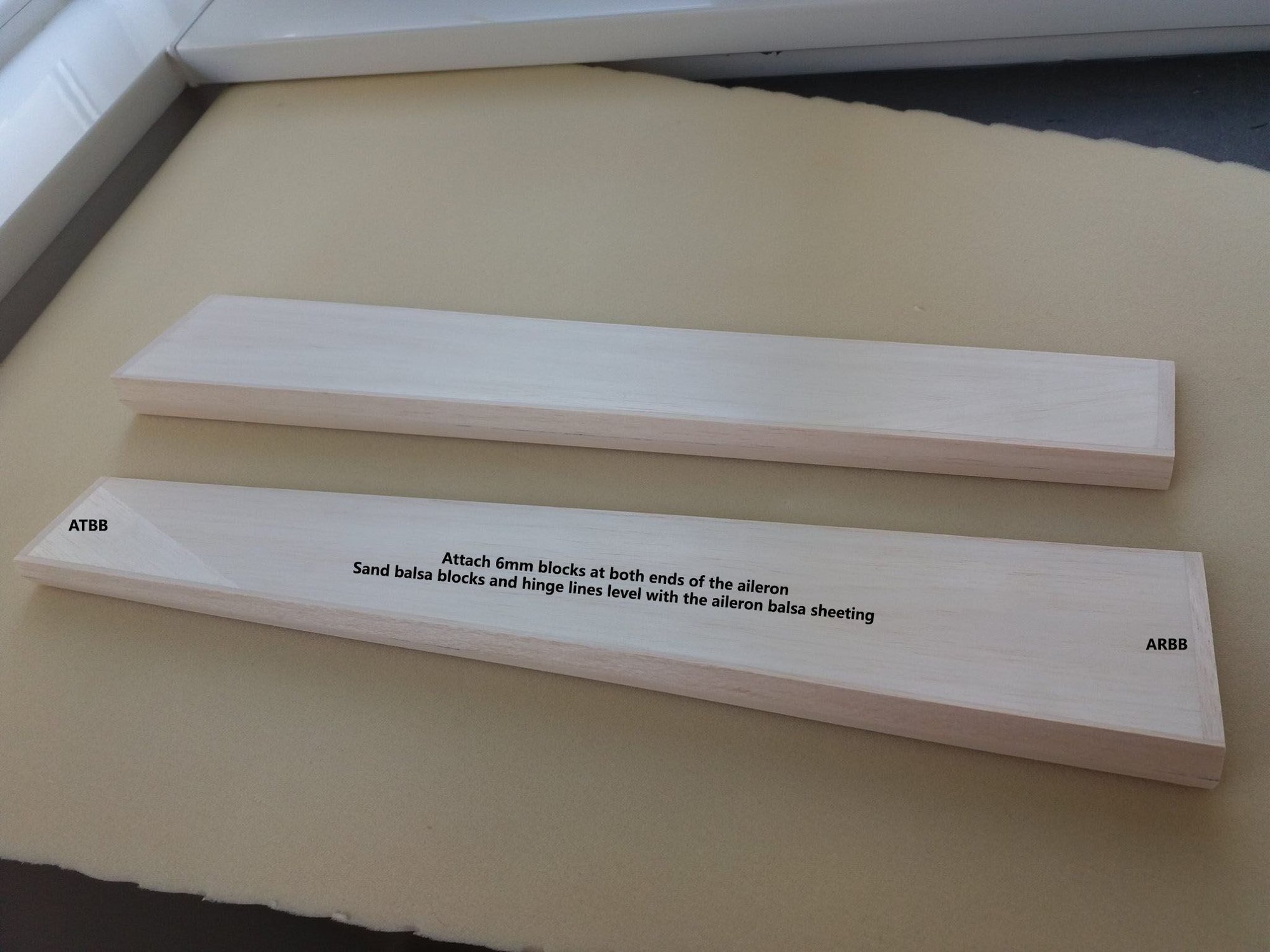

Hey Alex. You're workmanship continues to impress. Those parts look perfect. I recall possibly back in post #44, you listed your preferred adhesives for the fuse build, do you mind doing the same for the wings? With Don getting closer, it looks like time to stock up on all the glues and hardware. Also, with the weights you posted and the fact that you only used AAA grade wood, how do you think the finished weight is looking? Thanks, Ted.
Alex Voicu 09-21-2019 12:31 AM
Thanks a lot, i am glad you like it. The wings and stabs came out very nice and smooth indeed, there is no need for filler anywhere. The fuselage needs a little here and there, because the sheeting is made of separate pieces.
The structure of the wings and stabs is mainly assembled with CA, including the stringers for the main and secondary spars. The plywood rib doublers were glued to the ribs with epoxy, as was the wingtube sleeve.
The shear web parts of the main spar were glued with aliphatic resin, and the ones for the secondary spar with polyurethane glue (similar to Gorilla glue). Polyurethane is also used for attaching the balsa sheeting, leading edges, trailing edges and wingtips.
The weight looks good so far; it is 100g lighter than my Radiance which was under 5kg, while the fuselage is 140mm taller. I'm not sure how much glassing and painting the fuselage would weight, but i plan to go with film covering since i don't have the room and tools for painting.
