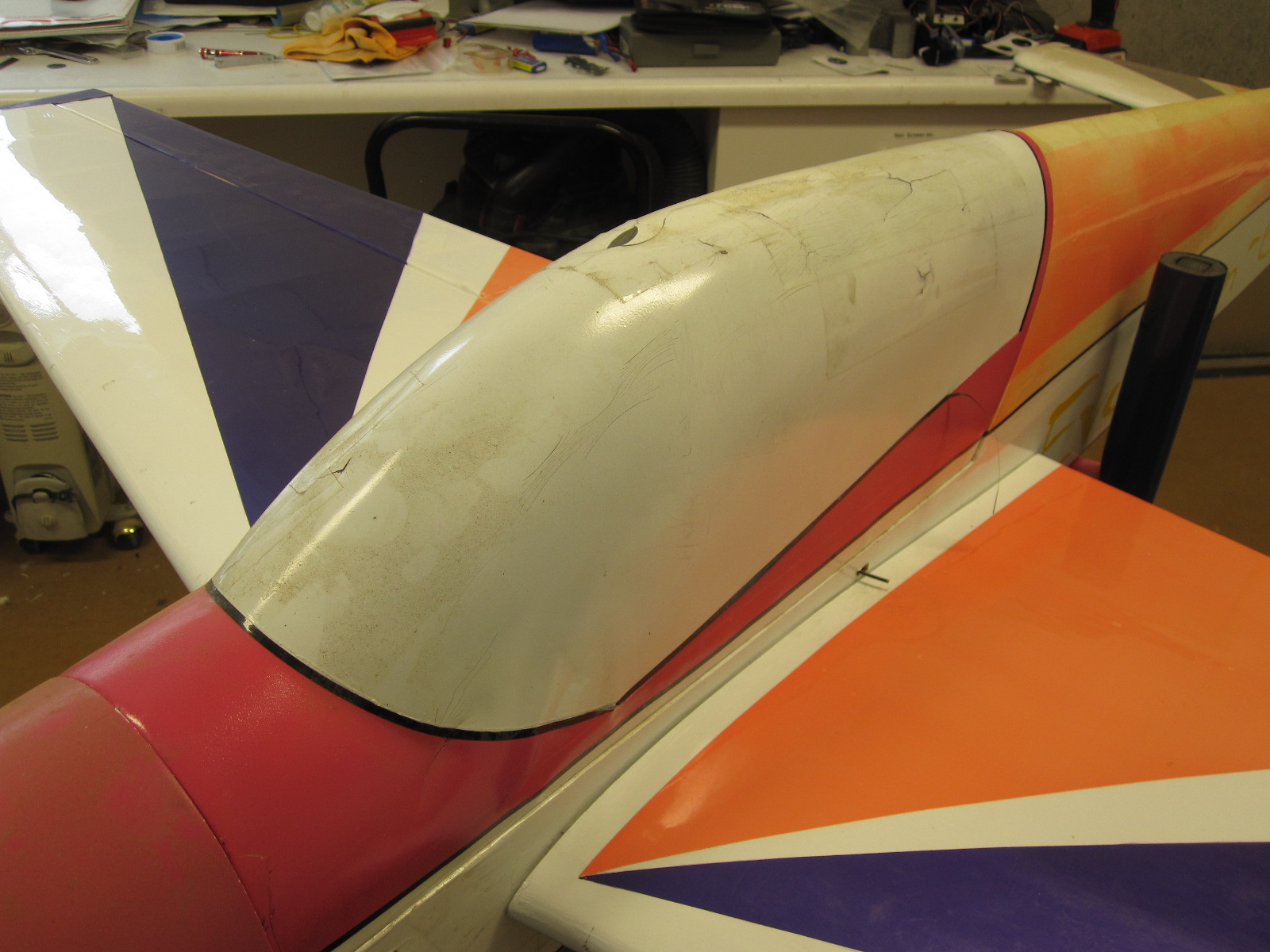

Here are the tired canopy photos:<div>http://i1327.photobucket.com/albums/...psa2bf0e51.jpg
</div><div>http://i1327.photobucket.com/albums/...ps9630a565.jpg
</div><div>http://i1327.photobucket.com/albums/...ps874a6619.jpg
</div>
JSchoolcraft 03-27-2013 07:39 PM
RE: Ultra Rc Evolution
I really need to either find a replacement or fabricate a new one.  I absolutely love the way this plane flies, even though it's currently an ugly duckling!!
MTK 03-27-2013 08:19 PM
ORIGINAL: JSchoolcraft
Let me suggest that first you wrap some plastic packing tape around it to even it out as much as possible. Then put some expanding foam inside and let it cook off. Hopefully that will take much of the buckling out and come out reasonably well. (I've done that before to worse with mixed results)
If not happy, remove the clear plastic part and the foam, installa foam block and shape away. Come back with 1/32 balsa sheeting, glass it and paint it. I've done that before and it goes very fast and comes out looking great. A lot of elbow grease tho
RonMcCormick 03-28-2013 06:29 AM
Yes looks very rough, all those low inverted passes right, LOL. Looks like you did internal repairs to it. Hopefully someone with nothing but a good canopy will step up, try a wanted ad.
good luck

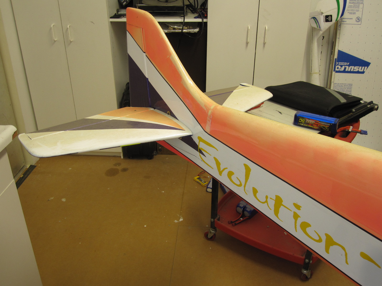

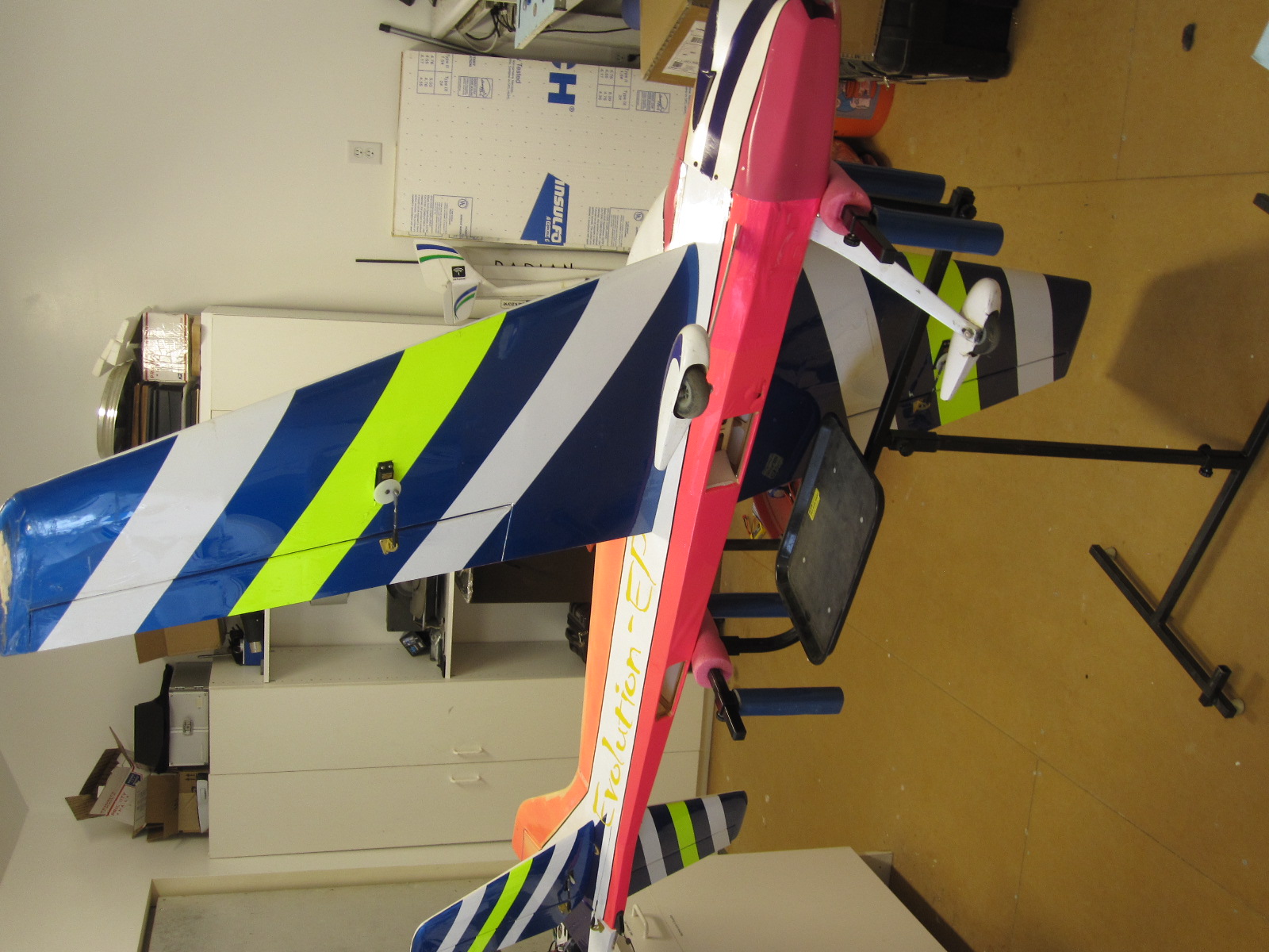

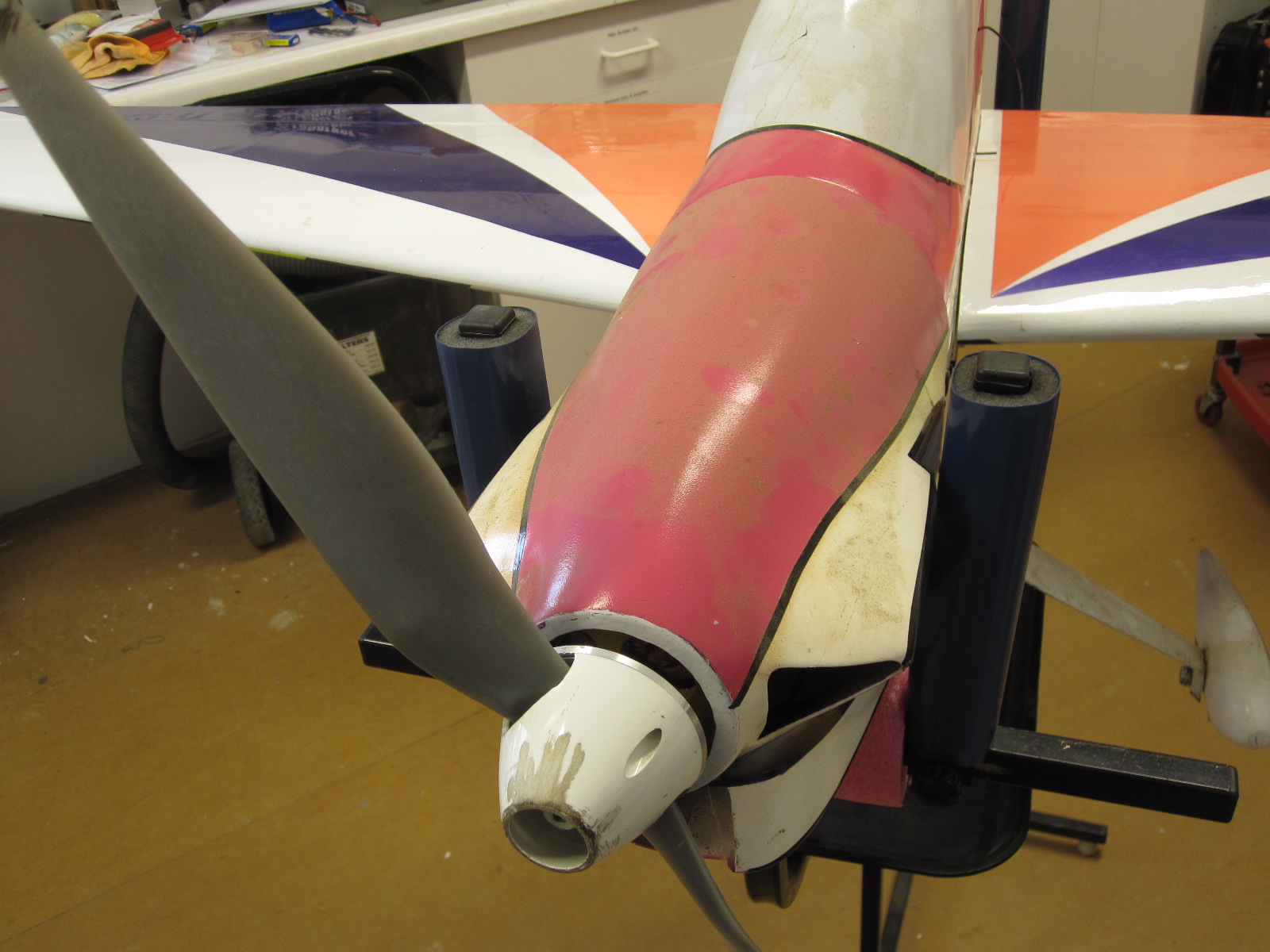

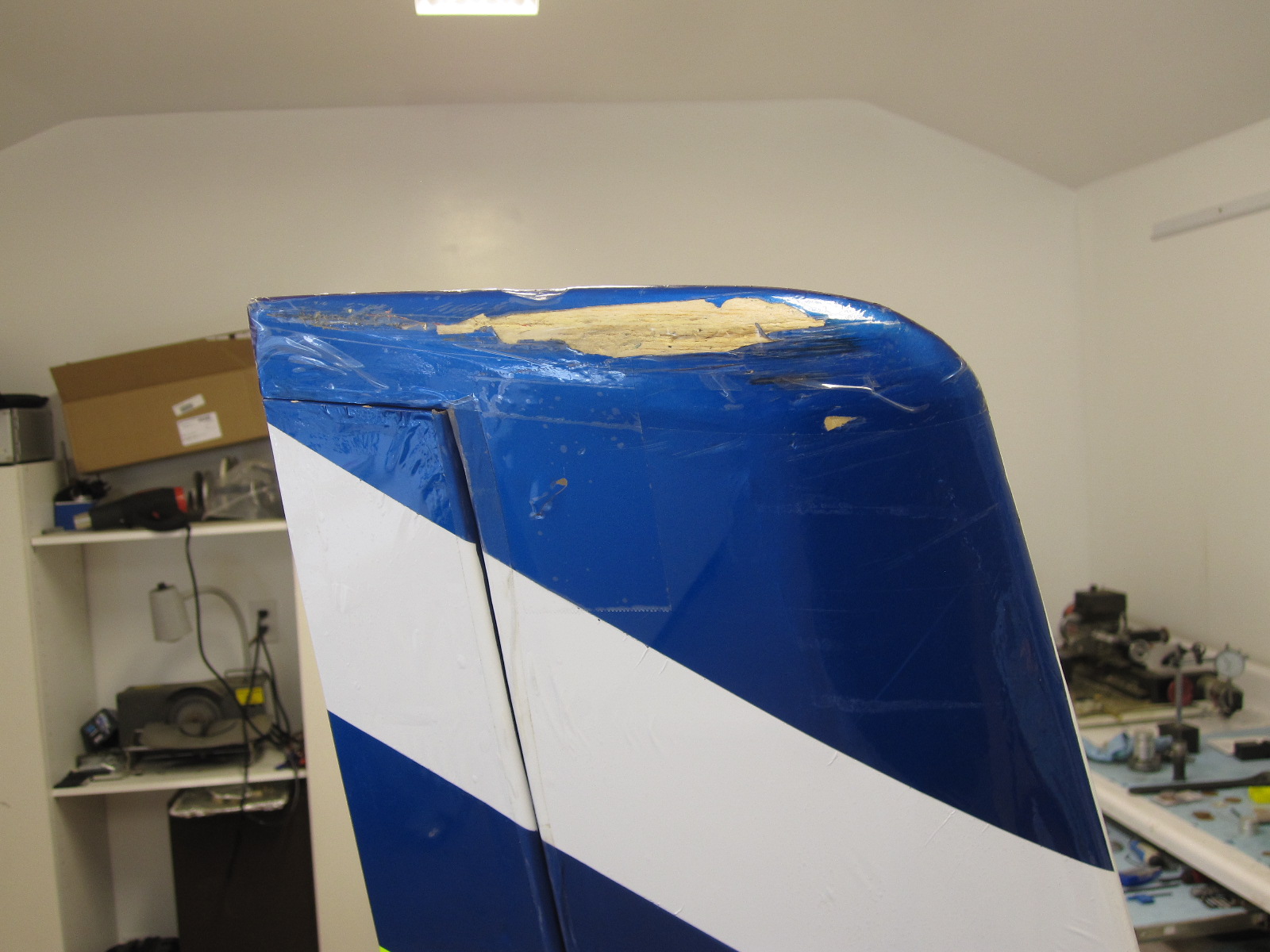

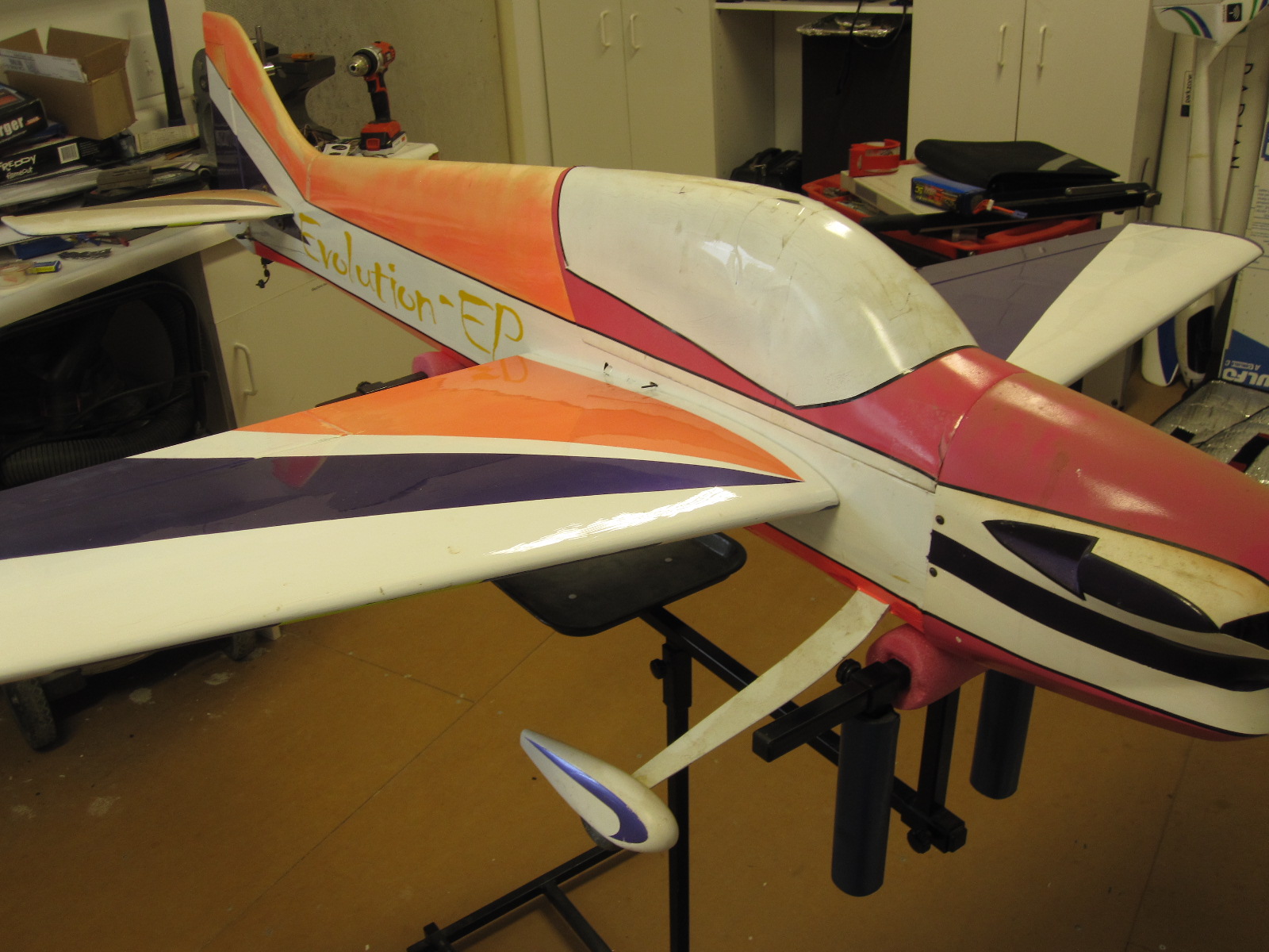

8 Attachment(s)
Ok, so here are some photos of my ugly duckling before her long overdue facelift:
http://www.rcuniverse.com/forum/atta...mentid=1993790http://www.rcuniverse.com/forum/atta...mentid=1993791http://www.rcuniverse.com/forum/atta...mentid=1993792http://www.rcuniverse.com/forum/atta...mentid=1993793http://www.rcuniverse.com/forum/atta...mentid=1993794http://www.rcuniverse.com/forum/atta...mentid=1993795http://www.rcuniverse.com/forum/atta...mentid=1993796http://www.rcuniverse.com/forum/atta...mentid=1993797
JSchoolcraft 05-09-2014 10:05 AM
Gonna be replacing the cowl, canopy, and spinner. Then doing a covering strip down, then repairing any hidden dents and dings, then a nice re-cover job. Should be a fun project to do with my son(who this plane is getting handed down to). Look out D7 Sportsman pilots........
