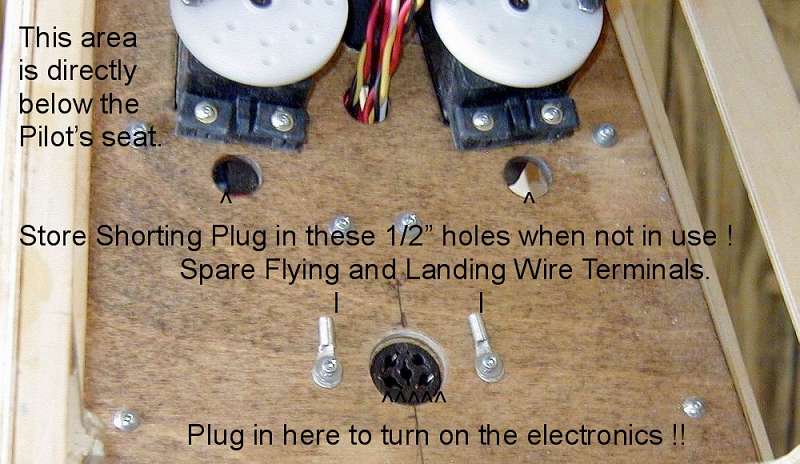

Sorry! I don't trust any of the rx switches these days, even new.
Cut em out and replace with a 5 pin shorting plug and socket...the cost of the slide switch that the manufacturer uses is only in the range of about 40 to 50 cents if bought in volume. An that is all it's worth in reliability. IMHO they don't belong in a guided (R/C) missile (Aircraft)

What keeps the shorting plug secured into the socket in flight? Doesn't vibration make it try to come loose?
Hi, Jim!
I use the rubber cap from the socket and put it on the shorting plug side then cover it with the pilots seat or inside a compartment with a hinged hatch that compresses the rubber cap to about 33 percent of the height. Or even a desk lock keeper keeps it under control or a bit of firm foam will surfice.
Though I've never had one come loose from even the big gassers or the high rpms of a tuned pipe .40 through .90's in ducted fans.
Or you could use the 5th position (the center pin) Thread the socket there 4/40 then run a
screw through the plug into the socket...course am not worried about it as it takes a good deal of force to remove the plug.
If you try one, I think you will agree there is not much chance of one coming loose in that situation.

What is a 5 pin shorting plug?
You'll find em on auto tape, disc players and audio amps...normaly handle 12vdc pwr + & - along with the speaker wires... I get mine from rat shack or from some auto supply stores also from electronic suppy houses..and a lot cheaper than the (ahem) wouldbe failsafe high priced versions of the same old cheapie slides available now a days.

Can you post a pic(s) of your switch setup ?

Sure! will post some here today, will need to get the pictures taken.
Will be in a couple of hours or so though..
Sorry bout the wait....
My new supply of 6 volt regulators should be in this week (?) so will be wiring them right into the Shorting Plug (under the rubber covers and potting them in with epoxy) might even wire in a set of voltage indicators just for fun. DinD
