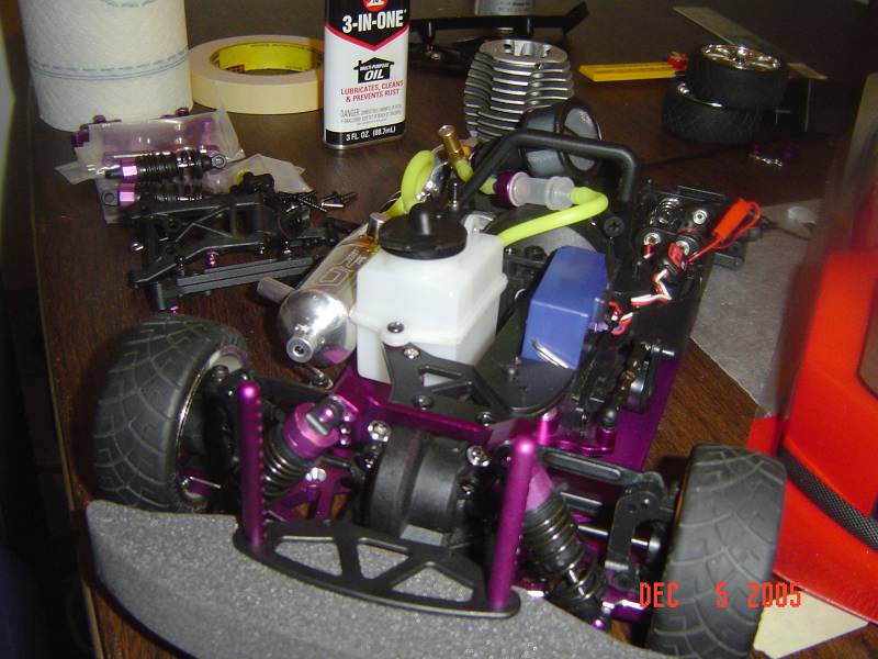

I have an inherent need to modify things. I just got my RS4 3 evo today. I've started working on it and havn't even driven the car, yet. Hopefully I'll get it finished tomorrow and pick up some batteries for her maiden cruise.
Mod list so far:
Aluminum front and rear arms, body posts, bearing steering assembly, and shock towers.
RC-One large fuel filter
Motor Saver Air filter
RD Logics tuned pipe
OFNA micro fail safe

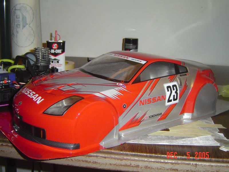

and my 350Z body. This is my first attempt at a body ever(it's almost finished!)
John

Thanks for the compliments, advice and sarcasm! So far I can't get the car to idle and it hardly starts. I've set it according ot the manual, but no go. The first problem was the large fuel fitler. I had opted for the larger filter, hoping it would act as a sump and provide more line volume, if the need ever arrived. The car just wouldn't fill the filter and it kept getting air bubbles. I bypassed that and it helped, but the car still doesn't idle well at all and it is not consistant.
Thanks again,
John

Try priming it, and if you've already done that, check your idle setting. The hole in your carb should be about 1mm in width when you're not braking or accelerating. Your idle screw to adjust this is the little one near the base of the carb.
