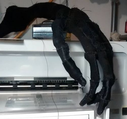

Here's my completed V2 archimedes pulley system finally done! It is 16:1 downgearing and this pairs with my 2.77:1 downgearing on the turn in place pulley on the motor for a total of 44:1 downgearing.
petersen (03-30-2025)
Ok so I did a big refactor of my pulleys and ran a test again and it still is not working. The first set of archimedes pulleys tops out and can't move anymore while the finger still hasn't moved. This is because of slack in the lines. I did not calculate slack in the lines into my calculations at all and am shocked by how much there is... Rather than do a major new overhaul with new math and new draw distances on every pulley AGAIN, I'm going to just drop the final pulley of the system so instead of 44:1 it will be 22:1 now. While we cut half the grip strength with this move, this might be okay after all. It still gives us 20lb of of burst grip strength I believe and 11lb of casual easy sustainable grip strength. Most common tasks should only require 8lb of grip strength anyways for a single joint tops. Because remember, I'm not doing a single motor for all 3 finger joints but one motor per joint which helps alot in the strength department and control department. So anyways, this hack I think is okay also because it hit me lately that I highly doubt I'd use the full beast mode burst strength of a 44:1 downgear anyways. I'd be too worried about the wear and tear on the fishing lines and pulleys and maintenance times getting too short between maintenance overhauls if the robot is using that level of grip strength for tasks. In reality, I am now imagining I will only let the robot do VERY minimal strength stuff to reduce the maintenance to a minimum. Like sewing, cutting, and delicately picking up small loads. I will treat it like it has the strength of my 4 year old just to baby it and make it last longer between repairs. Kind of like having a old beater car you don't trust and never throttling the engine hard but just gradually easing on the gas pedal to avoid blowing a gasket so to speak and avoid a trip to the mechanic. So that said I think 22:1 might actually be okay. And with that final pulley out of the way, I'll have WAY more than enough draw distance to bend the finger 90 degrees and account for string slack AND account for string stretch over time without any issues at all. Much better. Not to mention we do pick up speed this way and that might be a VERY nice feature when all is said and done. A faster moving finger can speed up its work I think. Like notice how 3d printers go way faster and that speeds up prints. So speed might be king over grip strength in the end perhaps. It's a tradeoff.
Another update is I realized I can wind a second very fine 0.08mm fishing line on the output portion of the winch in place pulley mounted next to the motor and this second line coming off that pulley will be attached to a tension spring consisting of a bracelet jewelery making cord for jewelry for kids. This line will maintain tension on that winch in place pulley and the motor output shaft at all times to prevent derailments. The metal tension spring that extends the finger will then have the help it needs to keep the whole system taught. That's the plan anyways. The runout of this line will need to be 12.48" of tensioned draw. To achieve that I need a length of this cord of about 15" I think which stretches to 27.48" at full extension. This would occur each time the motor causes the grasping actuation and it would be playing tug of war with the motor so that when motor relaxes or reverses direction, the winch in place is remaining tautly in opposition.

Update: I bought several sizes of kevlar string to use to replace the PE fishing line particularly in the high tension areas that may face the highest durability challenges. I found it on amazon in many sizes. I just bought one of each size: 0.5mm diameter 50lb test, 0.8mm diameter 100lb test, 1.1mm diameter 200lb test and 1.3mm diameter 300lb test. This is probably a game changer for my project IMO.

After further consideration, I'm scrapping using the elastic cord for a bracelet idea (as a tension spring for the winch in place pulley). The point of that was to use as little space as possible but I just don't trust it. I am not sure what material it is made of and my experience with rubber bands has always been dry rot issues. I am going with 2mm OD tension spring instead. It has to stretch 12.5" and so I'm using a 12.7" strip of it to start. That feels like a snug stretch but does comfortably reach the 12.5" of stretch needed. This brings its stretched total length to 25.2". I bought 3mm ID 4mm OD TPFE tubing to be its guidance tube for this. That arrives tomorrow and then I can begin assembly.
This 4mm OD guidance tube is a bit bulky and long for the arm IMO so I will relocate it to the torso since if I use this method for other motors these 4mm OD tubes will add up in space taken up fast. The arm can't house them - it's just too much space taken at that point for these. But the torso can house them in the back or sides I think. For now, since the torso is not yet attached, I'm going to place this tube ON the string suspended from my ceiling and treat that string as though it were to torso for now.

Good news: I had mentioned before I was planning to use 2mm OD tension spring for the winch in place pulley tension solution but once I got the 3mm ID 4mm OD PTFE tubing to go over the spring, I saw that the 4mm was just WAY too big once you multiply that out to 300 motors. 300 of 4mm OD tubing starts to take up a massive area at that point and I struggled with that. I MUST be miserly on space taken up by parts to get all the crap I need to fit in there to fit in there! Anyways, I fortunately discovered that you can buy tension spring down to 1mm in OD! I was unaware of this before now! You can find it if you search "0.2x1.5x1000mm tension spring" where 0.2mm is wire thickness, 1.5mm is OD, 1000mm is length. So I ordered 1mm OD tension spring and 1.5mm OD tension spring to test and see what seems best. If the 1mm OD spring seems reliable to me, I'll go with it. Anyways, since the spring is now smaller, I can use also a smaller PTFE tubing to house the spring so I ordered uxcell PTFE Tubing 1.8mm ID x 2.2mm OD off amazon. 2.2mm OD tubing compared to 4mm tubing is SHOCKINGLY smaller when you look at them. So it will be WAY more space efficient now.

I will use this string and elastic band method for now as I wait on springs and stick with this method for at least this first motor actuator setup for now. If the elastic bands don't last, we'll upgrade to the metal springs later on during maintenance or w/e.
Note: the total length of the elastic band I am using for this is 2ft and it stretches to 3ft snugly without too much force. I'm just going by feel and instinct for this measurement. If I were to go 1ft with 1ft of stretch, the stretch is more intense and the pull is harder. But I don't think I need much pull for just tensioning the winch in place pulley and I also think the more tension you place the more wear and tear on the elastic band which will shorten its lifespan. So playing it conservatively with the 2ft length selection for now.

The tension spring mounted to the motor setup upon further testing seems like a somewhat bad method. The issue I'm having is too much play in the tubing running between that spring and the finger joint. When tension is applied to that spring by way of the tubing, the tubing recoils and moves quite alot and allows alot of slack out to the joint so that the spring has very little involvement in the joint and doesn't really get used much period. So the full range of motion of the joint is just absorbed by tubing slack. When I tried to pretension the tubing so that the joint movement translates to the spring, the total tension placed on the joint by this became too high.
Fortunately, I came up with a much more elegant and simple solution for all of this. Basically, my plan now is to just use the bracelet cord tied point to point across the joint directly on the joint and that will be my spring for extension that counters the motor. This eliminates the need for metal springs at all which cuts costs, it also eliminates the PTFE tubing run, saving some space, and should be easier to install and easier to give precise amount of elasticity/resistance to taste. If I want more springback on the joint I can just add more bracelet cord in parallel to the first. This way I can add more resistance pretty easily.
So in recent testing a fresh issue I ran into was the TPFE tubing would start gradually pulling through its tightly wrapped tape sleeve to my surprise. Its low friction surface gradually pulls free of the tape over time. To resolve this, I decided to thread through the tip of the tubing to create a mechanical bond for the tip and once threaded through I just 401 glued down the ends of each thread onto the sleeve that was originally supposed to hold it in place to begin with. This seems to work great so far in the little bit of testing I've done since.

I figured out a robust way to make the extension cord for finger extension using the bracelet cord and a fishing crimp sleeve. The idea is to crimp the two ends of a folded in half strip of bracelet cord and this way both ends can be sewn down into the fabric without any gluing which could potentially fail or be a weak point. I am planning to use this in place of the tension spring style finger extension setup.
